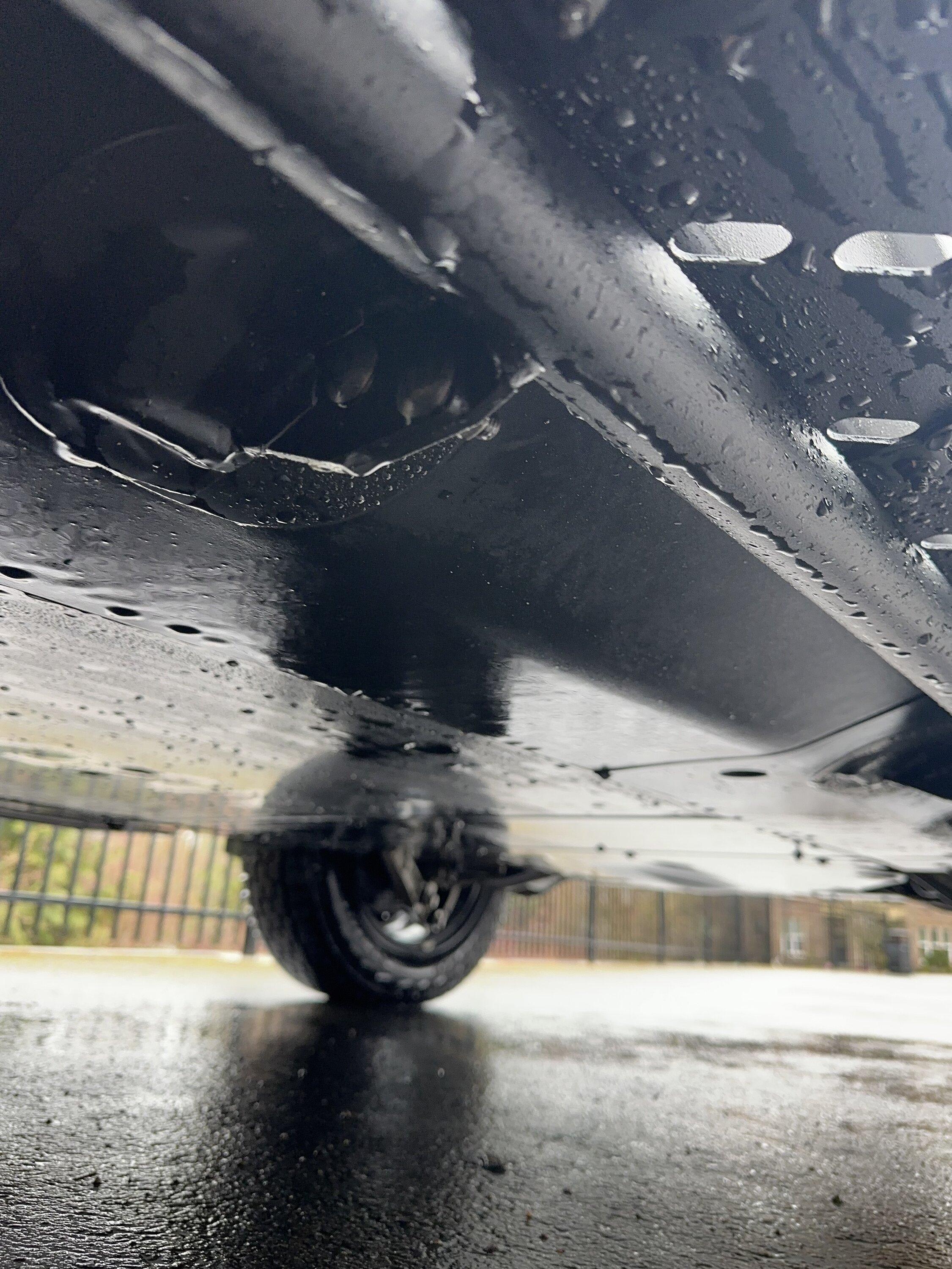

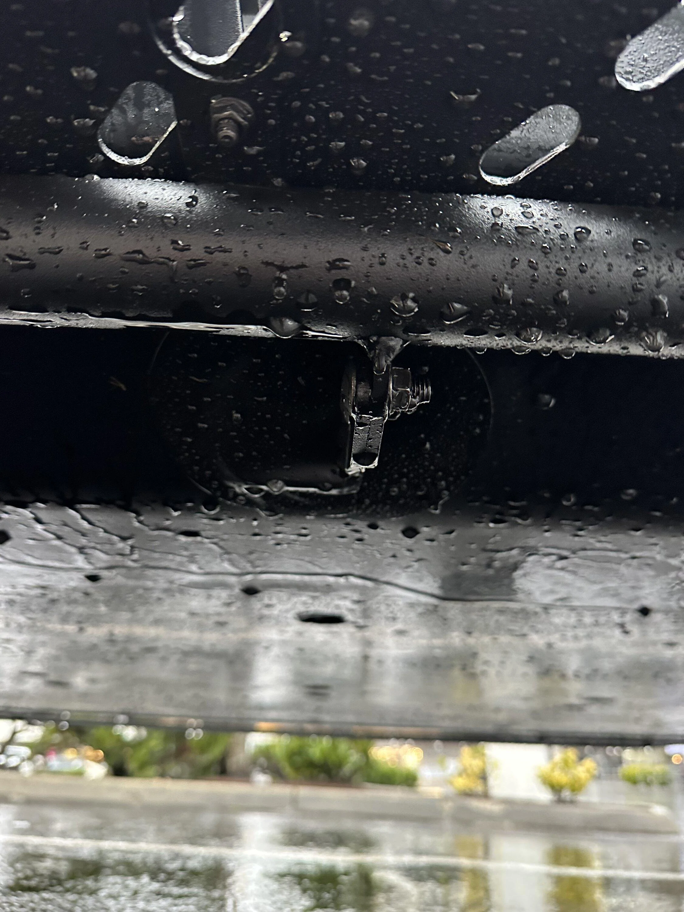

Well, it's been raining like a, "SpaceX launch pad water deluge system," here in Seattle - so I thought what a good day to do some environmental seal stress testing - including driving on a road that is under construction! Note: When I first got the truck, the noisy center panels caused me to apply some black duct tape to them and the frame. After the first rainy drive, the duck tape either peeled off completely, or was hanging down partially - clearly not a good solution. This seal, as mentioned, is waterproof and used on roofs and underwater to seal pool liners.
Punch line - All is as it should be! "Nothing to see here..."

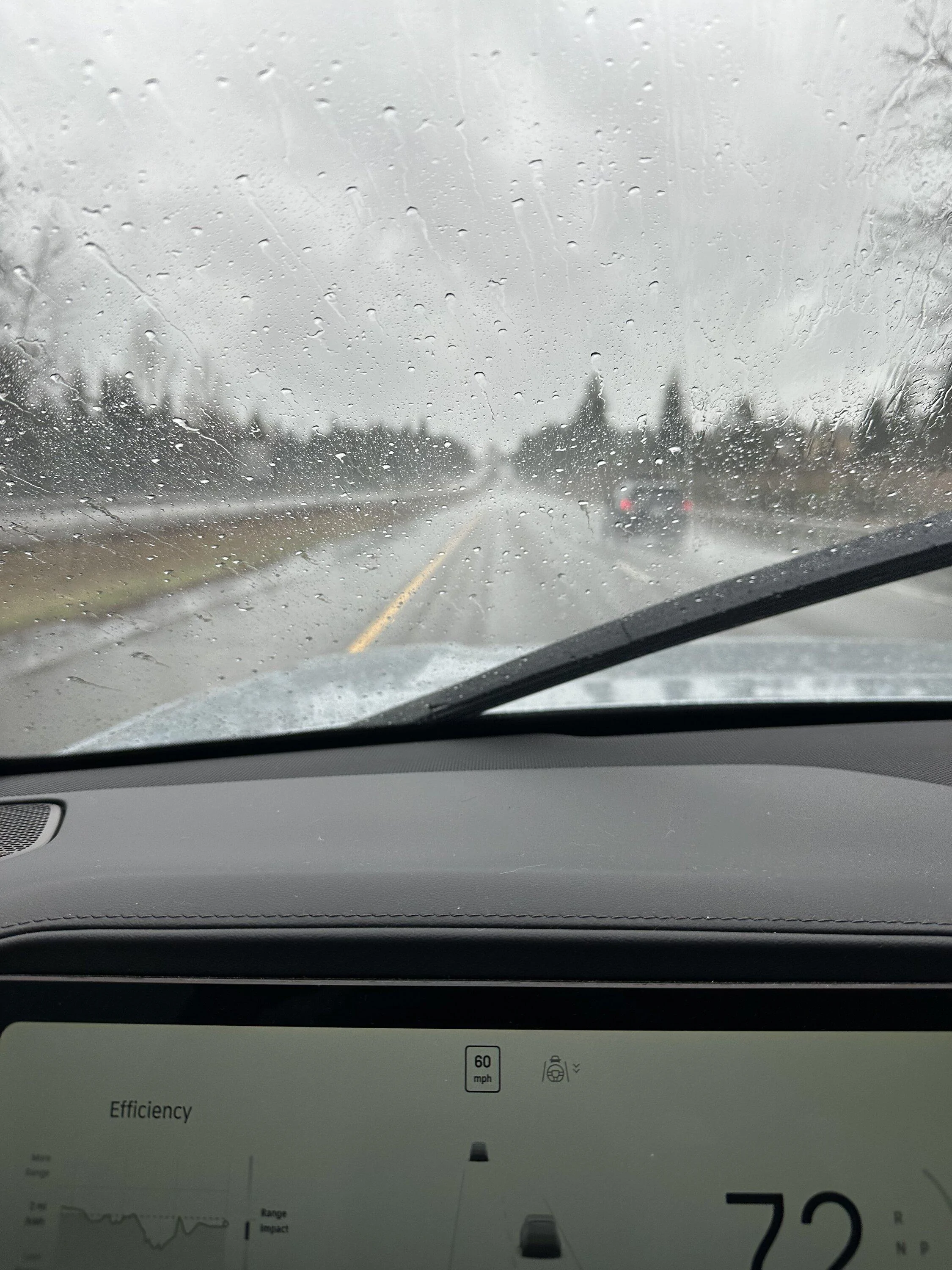

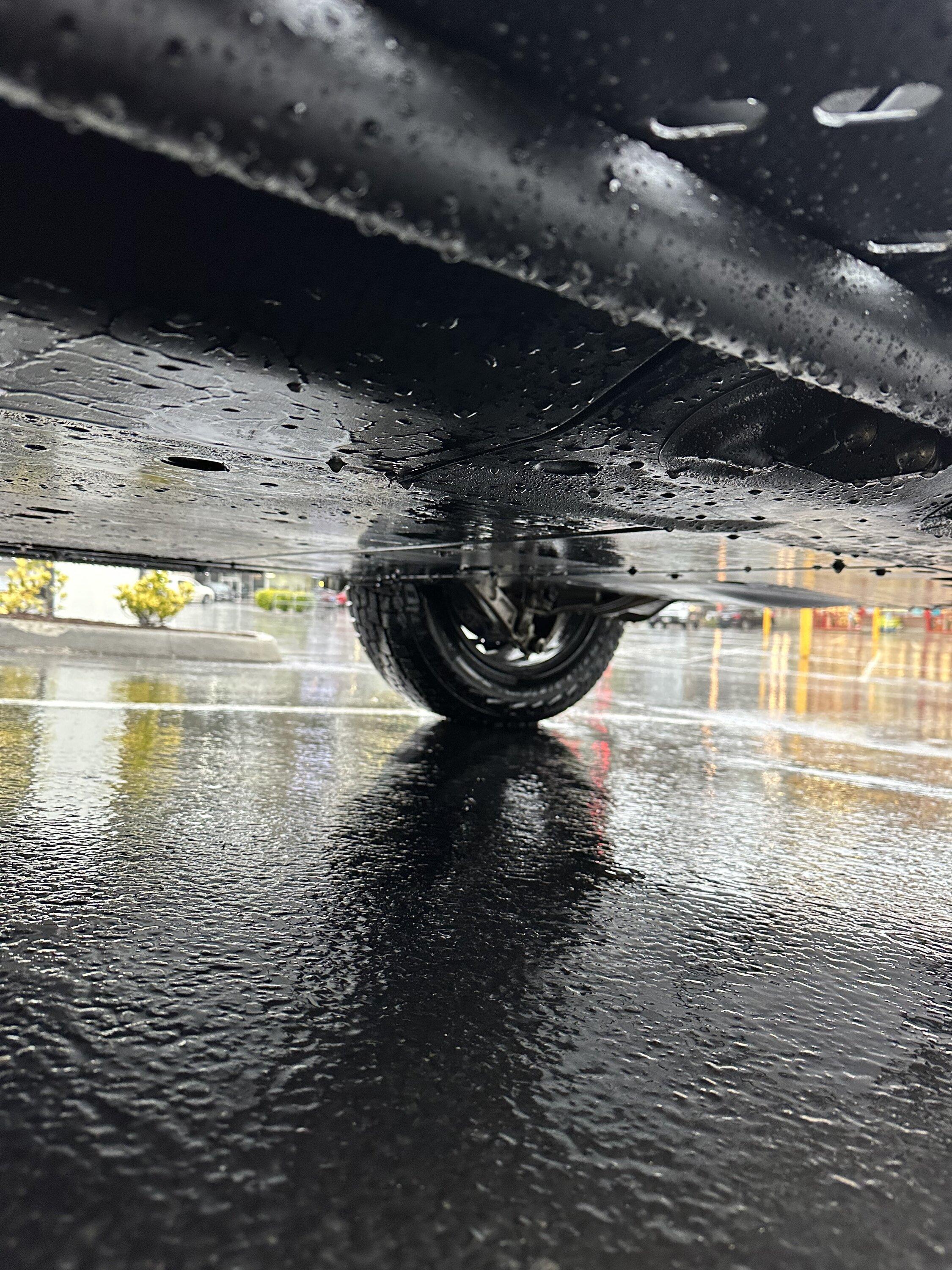

Longer Highway Speed Water Scouring Test Results…
Zero issues; nothing to see here, either!
