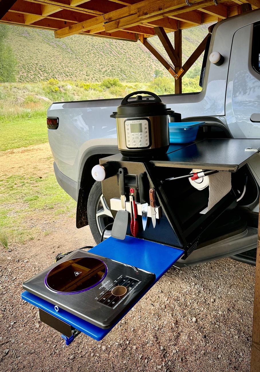

Has anyone identified a collapsible tote that will fit into the Open Box unit of this sled?
Stationmaster
Doug
Mar 23, 2023
Wagon Wheel Gap
2022 R1T, 1951 MG TD MKII
retired educator
Has anyone else installed this system? Curious how it is working out for you (those who have already installed)?
So far ... so GREAT.
My "micro-kitchen" is evolving ... using the 3 drawer cabinet + the small box for the middle to hold 2 gal. of water ( converted two one gal. jugs of apple juice).
The other half has a tray for groceries, Instapot™, etc. I made my tray out of wood.

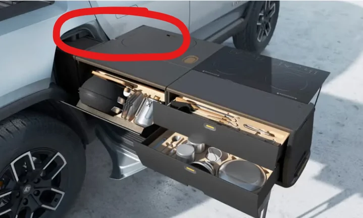

The part of me that designs things for the worst case scenario "the operator will always find a way to break things" screams at me with the table top. I know this is the better side to put the surface on and Rivian Camp Kitchen does the same, but I would always be afraid someone would for some reason hop into the back from the other side, then open the door on this side and ding the passenger rear door on the shelf.
But that's just the part of me that thinks everyone is stupid, and it drives my wife crazy that I think people will break everything.
