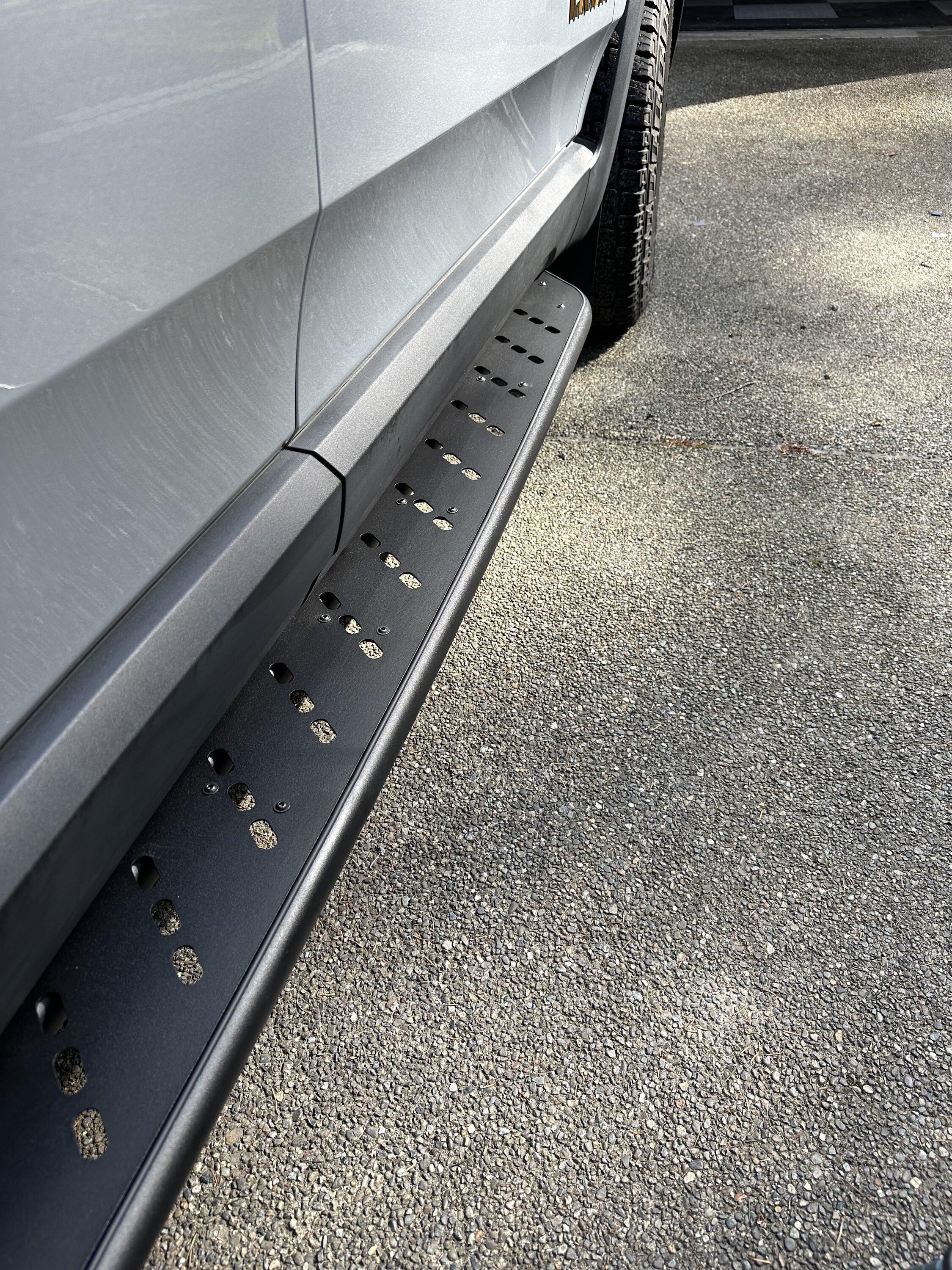

Hello again, my fellow “Riviarians”! As mentioned in my review (Tip #2) of subject Running boards …
https://www.rivianforums.com/forum/...aling-of-4”-hole-procedure.13403/#post-298630

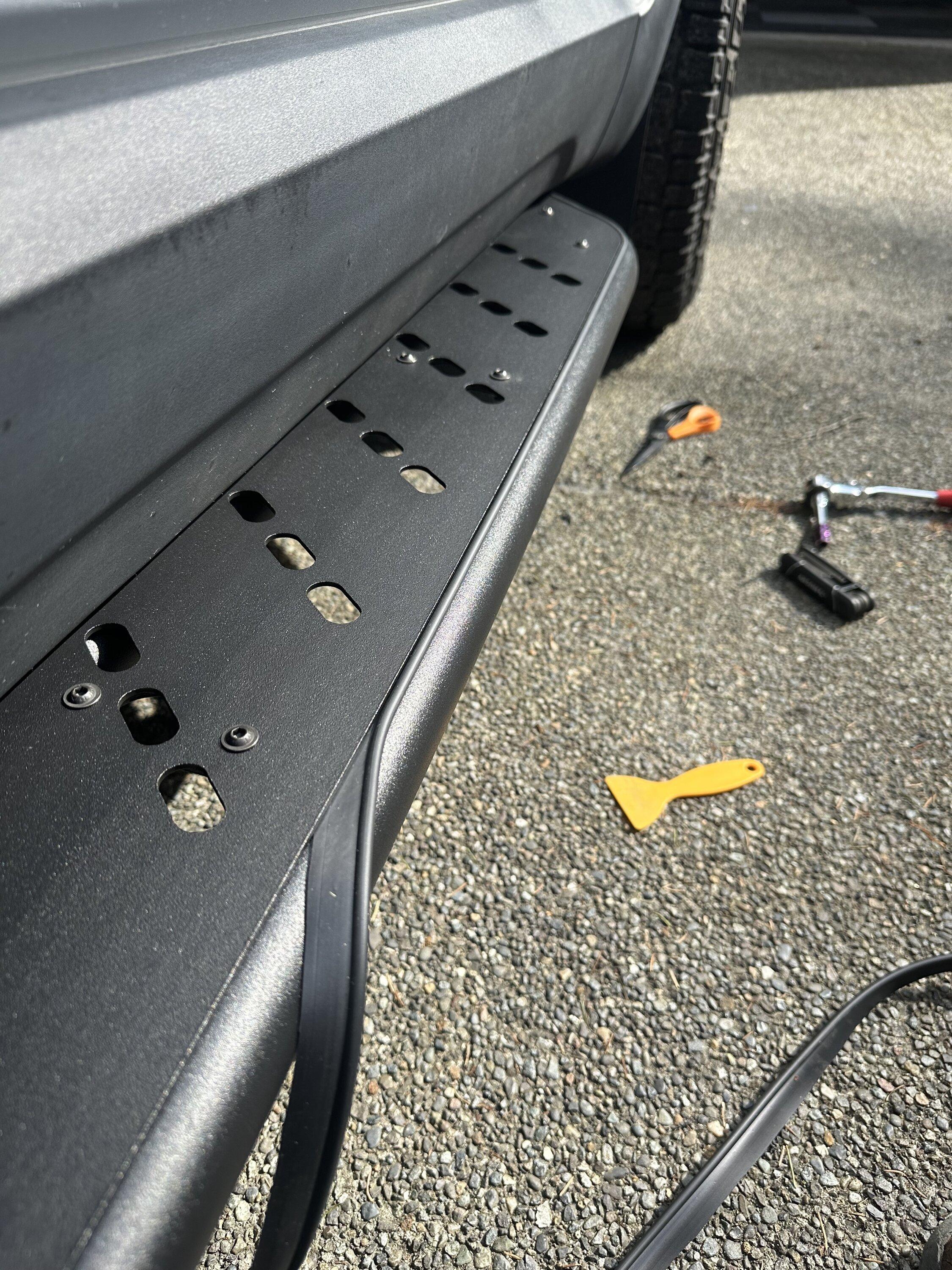

I was contemplating the use of solid EPDM rubber or solid core marine grade vinyl bead-welting for use around the outer edge (between the tread plate and tread tubular frame) of my running boards. Why, you ask? Well, for several reasons….
1) Uniqueness/differentiation; I’m going with either Compass Yellow, Body color, or Black – for a more OEM-like, finished aesthetic. SOMEONE PLEASE Photoshop
and REPOST my pictures to show the bead in all body colors, including Compass Yellow!!!!

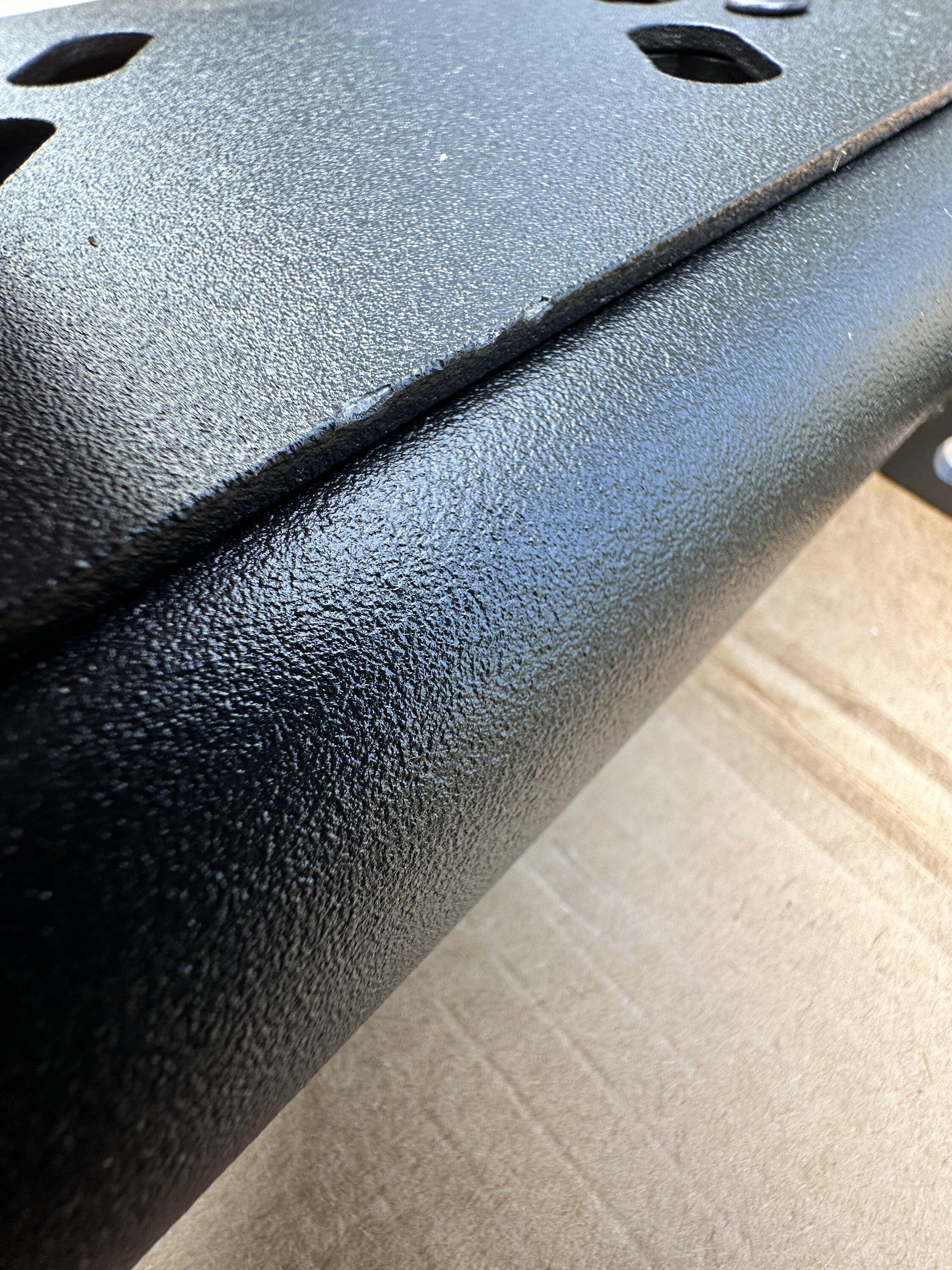

2) Personal preference, but I prefer there not being a raised sharp tread plate edge for the following reasons (YOMV, of course) {Where; “O” = Opinion}
a) Smaller children injuring themselves (cuts/bruising when crawling up onto the boards and into the truck) - Yeah, I have a scar on my knee from a similar young childhood mishap…
b) Powder coat paint scraping off that raised sharp edge with use (especially with dirty/sandy sneakers/boots or other footwear) over time – rust forming, etc.
3) Tread Plate cushioning – Again, personal preference, but I prefer a no “metal-on-metal” contact, when it comes to mechanically fastened plates (vs. welded). This will reduce the likelihood of paint wear-through over time, noise, etc... Also, with summer heat / winter cold, the plates and tubing will expand and contract at different rates - and in different directions. And no, I do not have any concerns with this bead welting/gasket trapping water or grime, any more than the “as designed and delivered” product. Again, YOMV.
This is really easy to install; just loosen the tread plate hardware, insert and apply pressure to the welding as you slowly tighten the tread plate hardware – work from one end to the other to ensure a proper fit and seal!
I tried two sizes; 3/16” bead and 1/8” bead and felt the 3/16” diameter bead to be best as its bead height is “slightly higher” than the top of the tread plate, thereby protecting that edge (and small children’s knees/shins)!
So, what do you think? “Nope” or “Dope”?

Yes, what I first ordered and tried was garage door weather-stripping! Why? Because I save money by splitting it in two, and using both sides as welting, of course! Also, because I was able to get this in two days for my experimentation. For the final build, should I go with Compass Yellow or Body Color highlights, I will go with color coordinated single bead extrusion (Vinyl or EPDM rubber, depending). At 3/16”, there are MANY colors available from several sources, BTW. Not so for the 1/8” as I’ve found that only in black or gray.

Neat idea and I think super cool. How many yards do you think would cover both running boards?
And I think Compass Yellow would be an interesting contrast.
About 8' per side.
Edited to 8' per side, with some extra to spare.

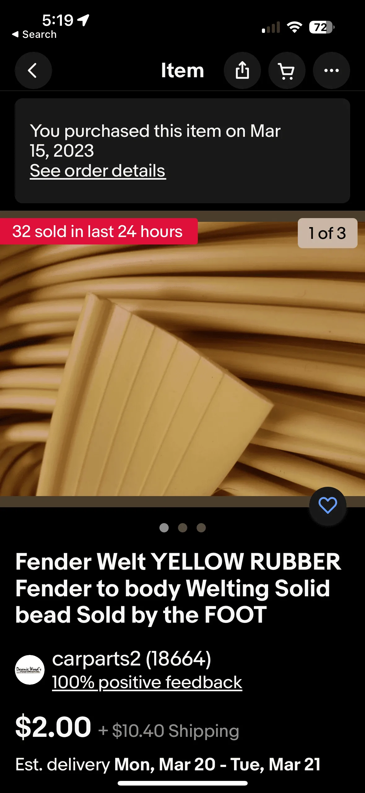

Sorry! Just voted and I'm going to try yellow. Found some in eBay and it was ~$13.00 with shipping, so 🤷‍♂️

I may have made a mistake but we'll see if it works: https://www.ebay.com/itm/192087678066
It says it's for upholstery, but it's PVC. If it doesn't work, it's just $13 down the drain.
And here's the color:
If the bead were not hollow…. Anyway, it’s cheap to see if you like the color! Material wise, mine are weather proof grade garage door vinyl and rubber… I believe the 3/16” were vinyl, but feels like rubber. 1/8” is too small to protect that sharp edge. Unprotected, I can easily see the paint being scrubbed off.
