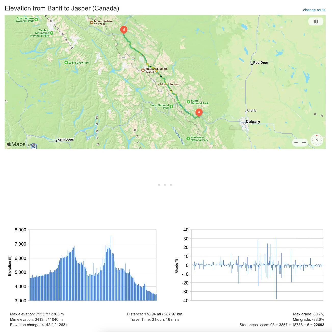

just out of curiosity I found this site. Here is the elevation gains/losses of the route from Banff to Jasper. I do not live in the mountains so no experience with R1s over hilly terrain.
https://www.flattestroute.com/Banff-Canada-to-Jasper-Canada

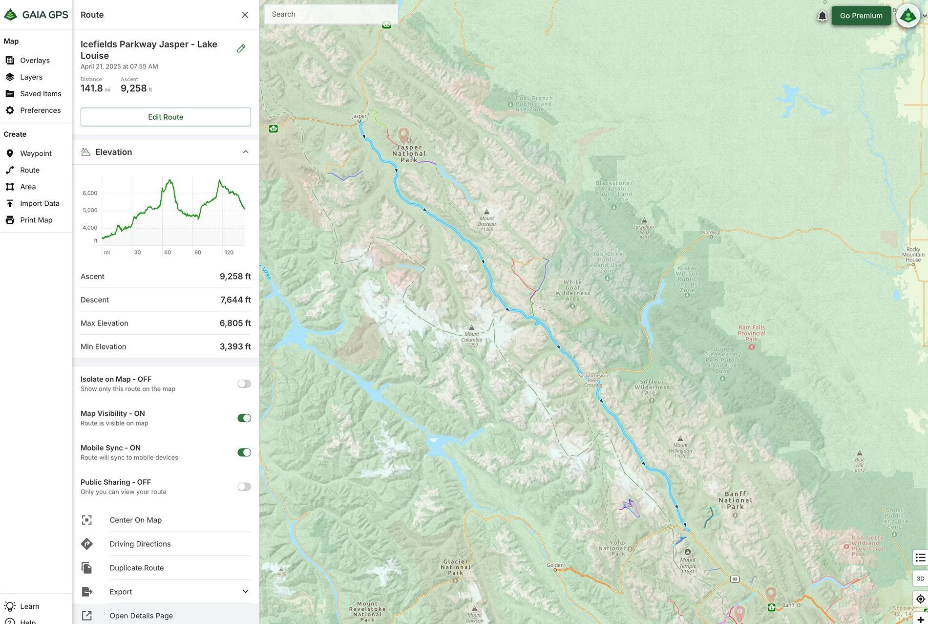

That site is interesting, but has anyone found one that calculates total elevation gain, excluding descents? In other words, if I go up over 5k ft then back to sea level, I want to see 5k - not 0.
Would be super helpful for planning purposes.
I believe the data is embedded in mapping databases, so should be a matter of extraction at relatively fine-grained intervals.
There is always the tried and true Gaia GPS. It is our go-to for backpacking and I never hit the trail without it, but I've never used it for road trips. I popped in the route for Jasper to Lake Louise and I think you get all the info you are after. Total elevation gain 9,258 ft. Total descent 7,644.
Rivian R1T R1S Jasper to Banff in R1S Gen2? Screenshot 2025-04-21 at 08.00.48
