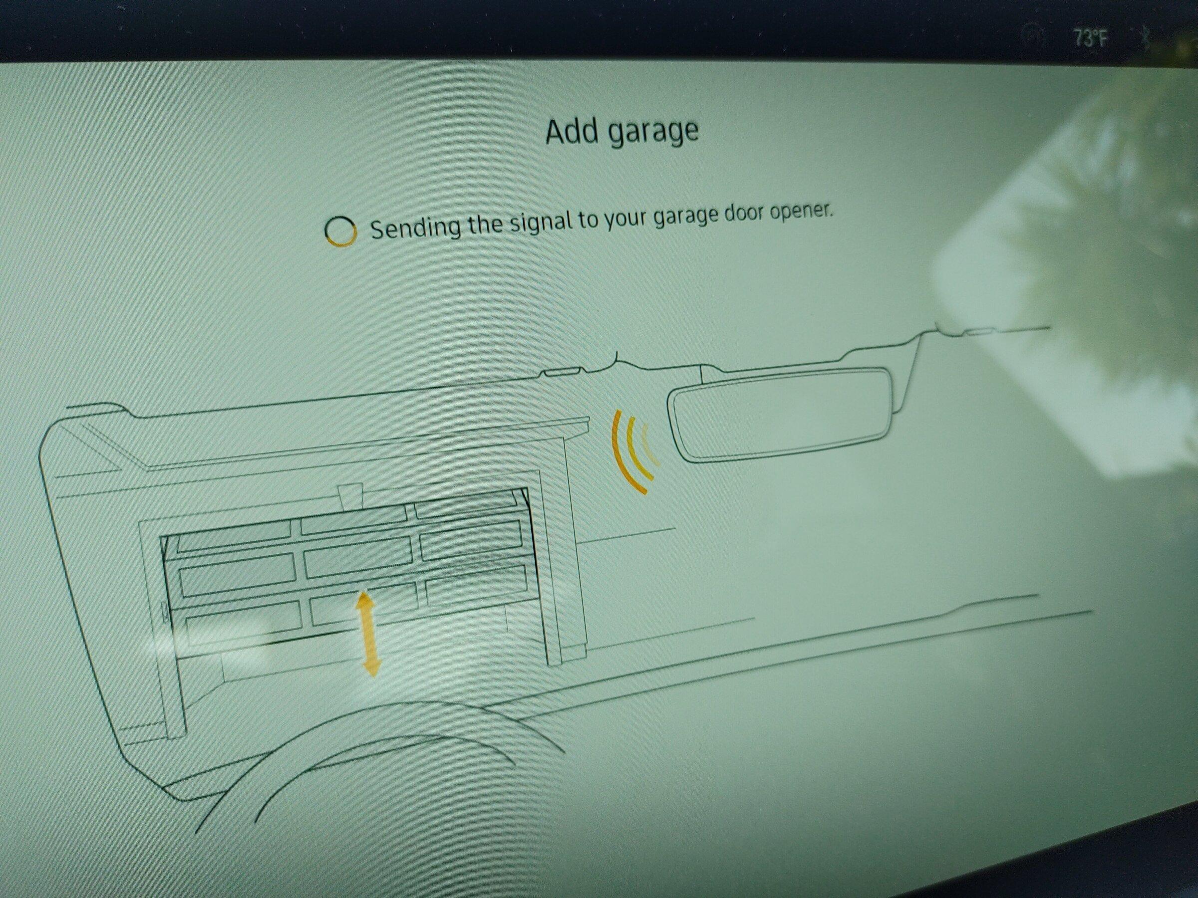

So I found a solution and wanted to share it. I also shared the solution with Rivian support.
After you send the code from the remote, the truck will say it accepted the code. After hitting OK it will tell you it's going to send the signal again to test.
On the screen that says "sending the signal" (see photo) you have to hold your garage remote button AGAIN and then you will get a success message. If you don't hold the button again the screen will stay there and eventually time out as my video originally showed.
Once the garage has been added to the truck I found I needed to push then button on screen 1 or 2 more times and then it started working consistently.
Not sure if it's a bug in the truck or somewhere else but hopefully this helps others out
