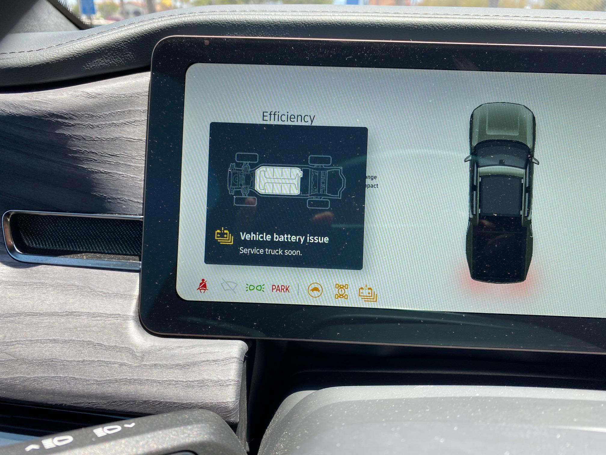

Along with the damage on the side of my truck they also weren’t able to fix the battery issue. The same tech told me they weren’t able to replicate the issue. I asked about all the vehicle logs that were reported. Since the issue has happened 3 times. He told me they can’t do anything unless it happens with them. Well, it’s been 2 days since I picked up my R1T and the battery alert has happened twice today.

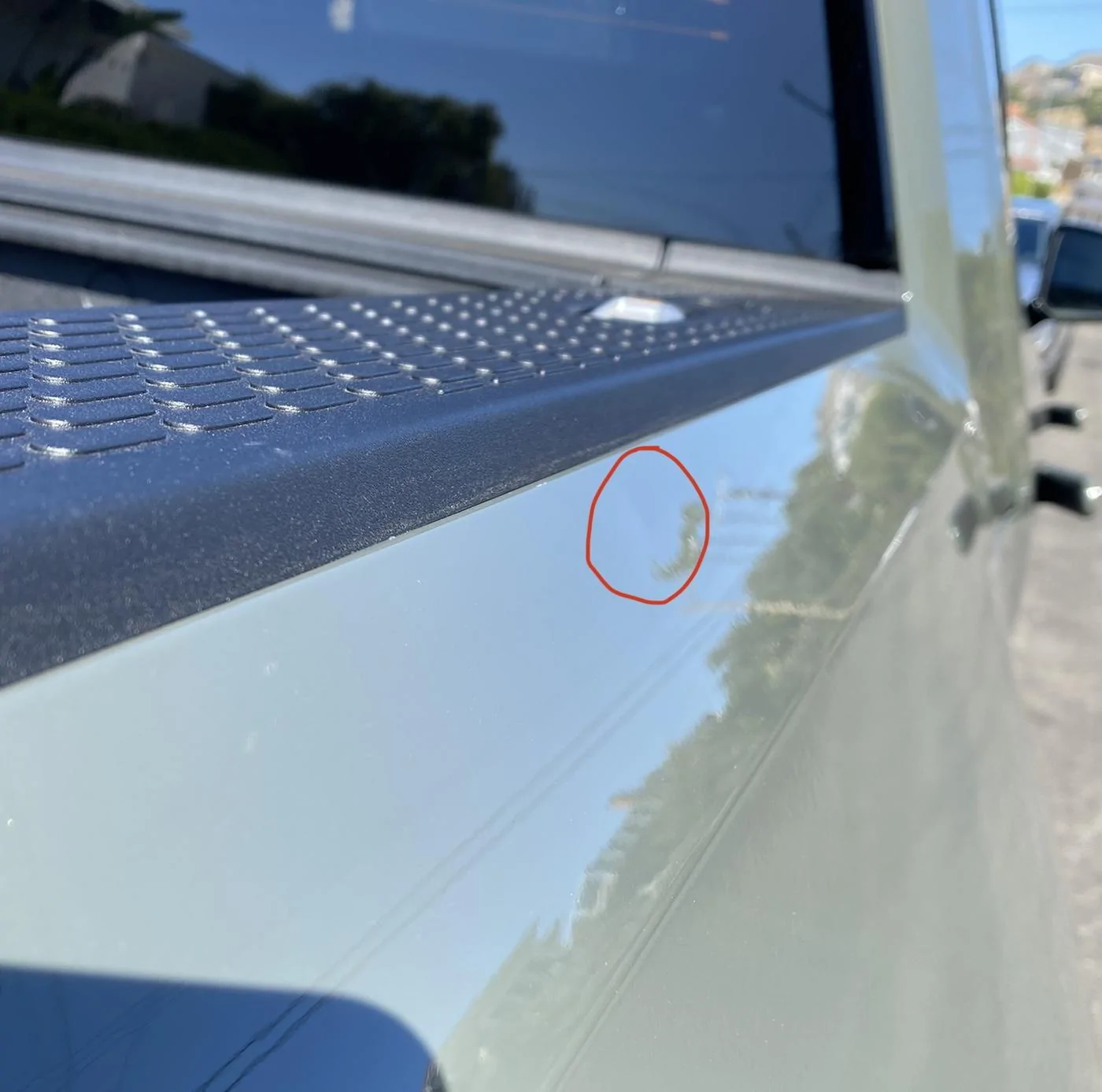

Sad my first dent in my vehicle came from the service center. And their whatever attitude. Honestly, I’m very disappointed. I asked for my next appointment if I can try the Costa Mesa service center because I’ve lost faith in the El Segundo center. Oh, forgot to mention about the wheel alignment. It’s way better than it was but still slightly off.

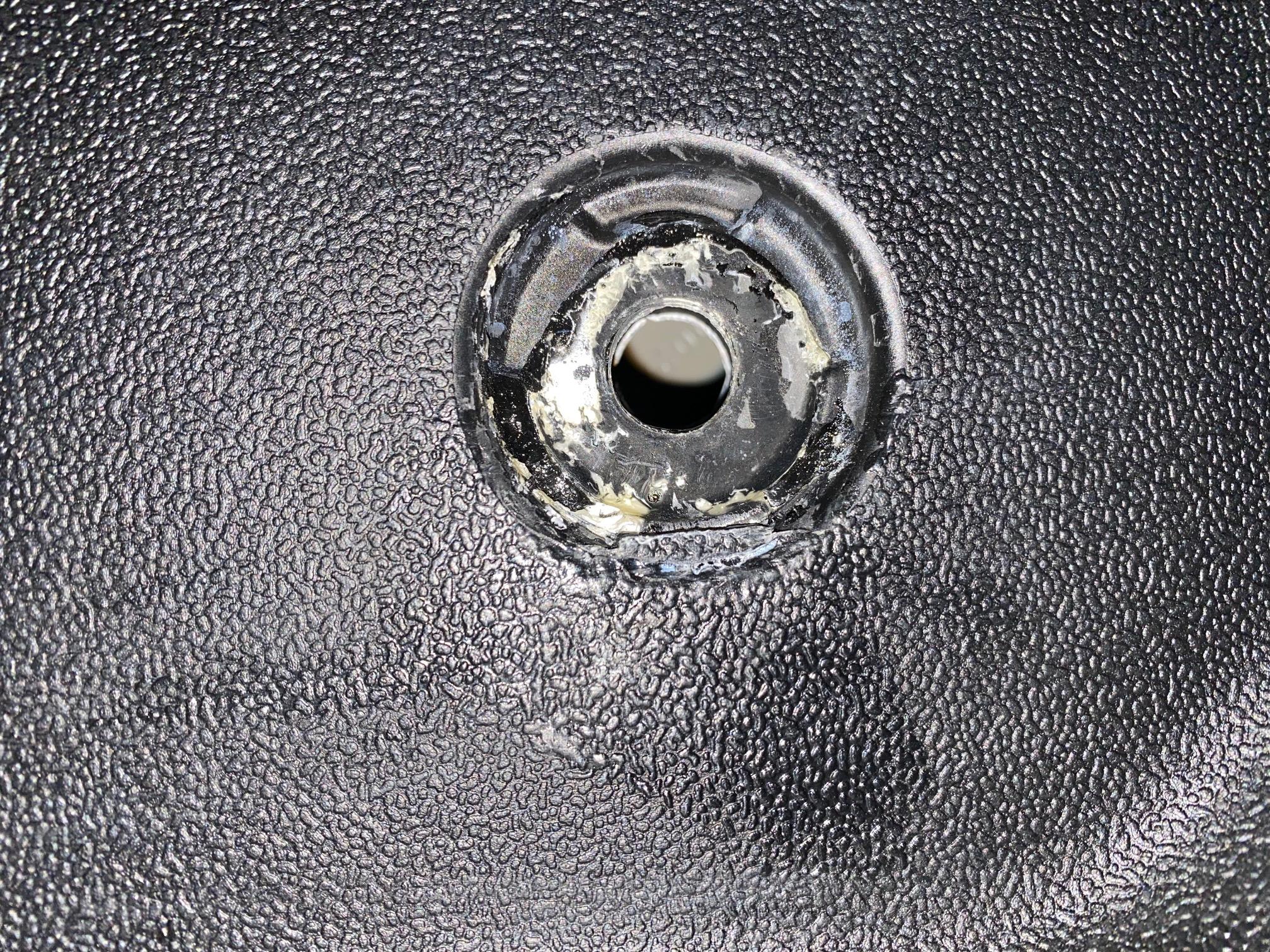

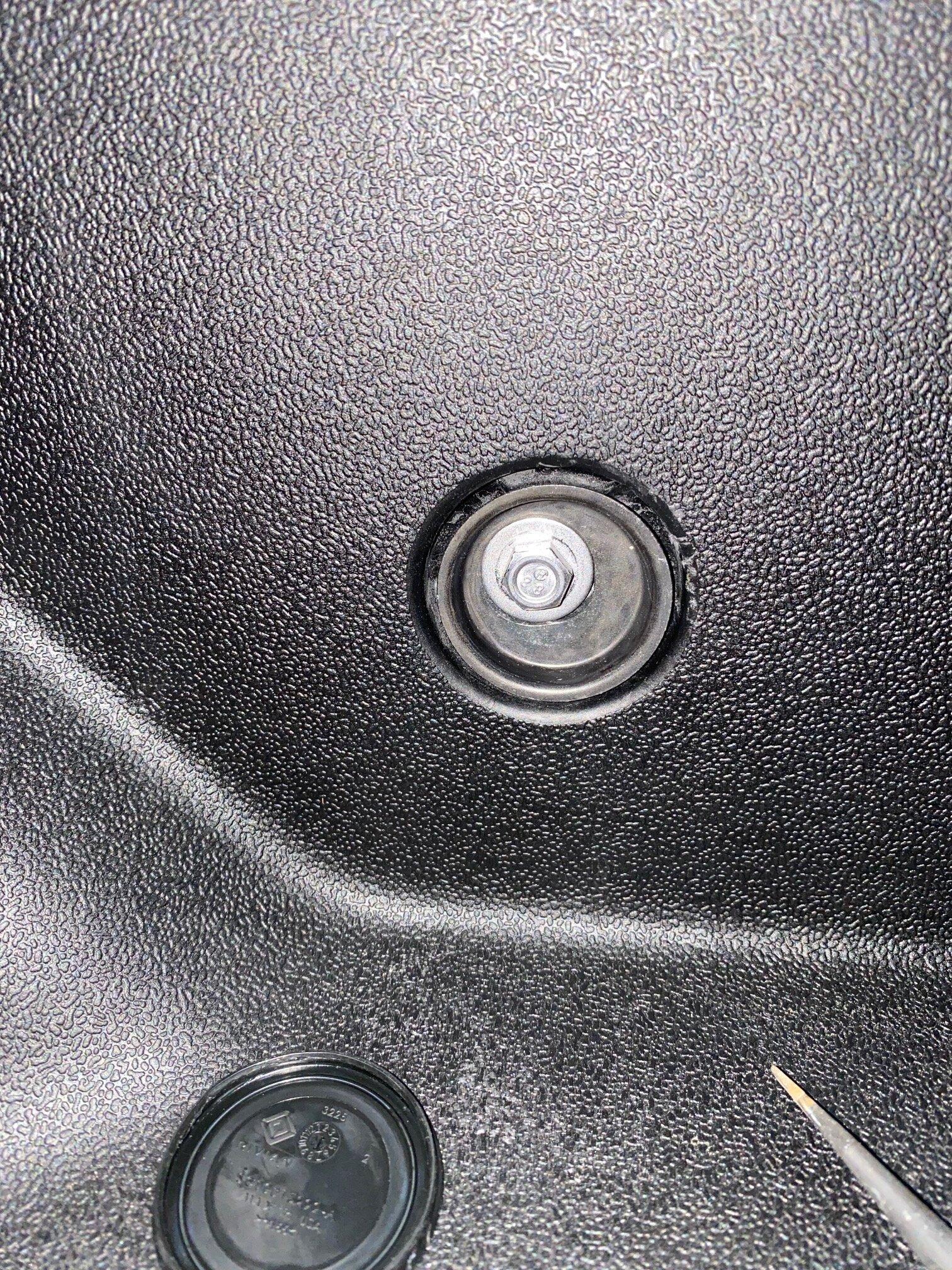

Let's take my bed for example. When trying to replace the broken tonneau cover, they wanted to replace the guide rails. In doing so they dented the side of my truck and after further inspection I noticed they sheared off the mount for the bolt that holds the interior bed panels. It's going to be very interesting how they are going to fix this issue. When will they fix the bed? I have a feeling they are going to wait until the repair kits come from the manufacture to replace the faulty tonneau cover. They don't me not to expect that until August.
Broken side - looks like they cut off the threads. Missing the hardware now.
Rivian R1T R1S Issues list from 3 weeks of owning my R1T updated 8/4/22 broken
Side with bolt
Rivian R1T R1S Issues list from 3 weeks of owning my R1T updated 8/4/22 unbroken
They scheduled me another service appointment for Friday the 8th. They promised they will fix the battery issue this time and not let me leave without it being repaired.
Rivian R1T R1S Issues list from 3 weeks of owning my R1T updated 8/4/22 battery

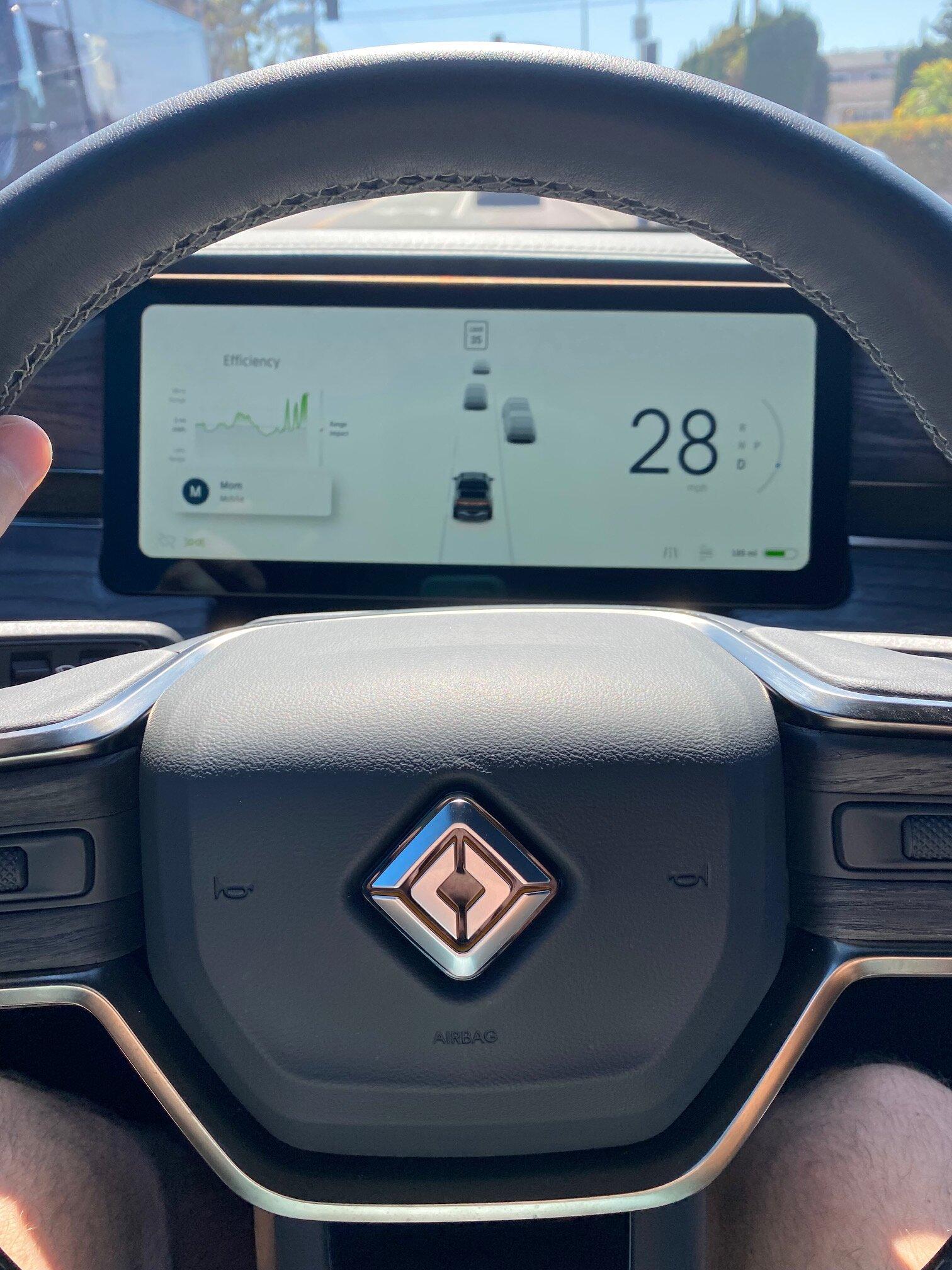

Realign the vehicle with the steering wheel centered and vehicle still pulls to the right.
Rivian R1T R1S Issues list from 3 weeks of owning my R1T updated 8/4/22 IMG_3558

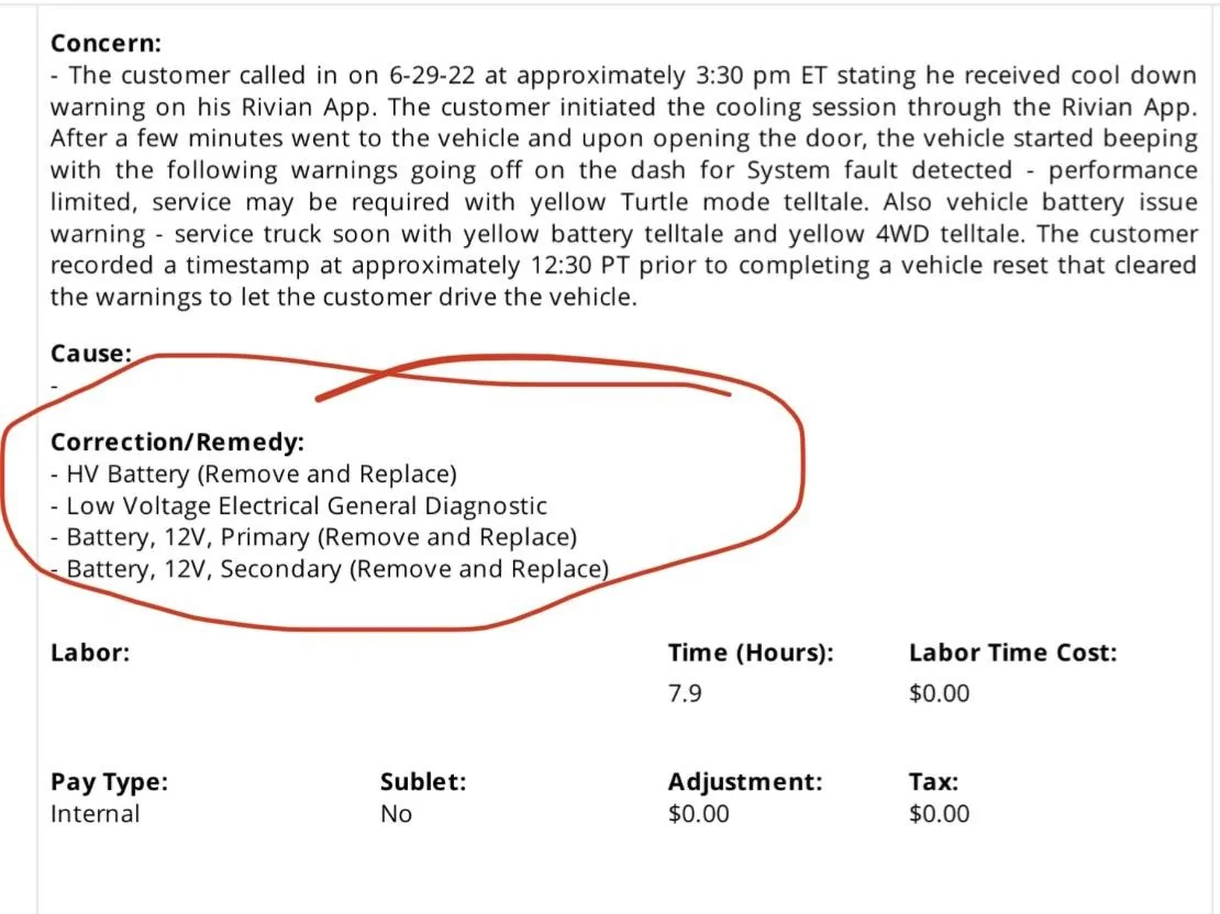

Well, this morning I received a call from Rivian to approve the work order.
Rivian R1T R1S Issues list from 3 weeks of owning my R1T updated 8/4/22 5DF7A500-EB5D-41DC-96E5-41520F6D8DD0
It appears they are replacing all the batteries on my vehicle.
Thank you Rivian for making this right.

replaced high voltage battery along with the two 12 volt batteries.

They also replaced the outside molding on the door panel that they broke too.
They also had to call in their collision team to re-tap a hole that they stripped while installing the new battery.
