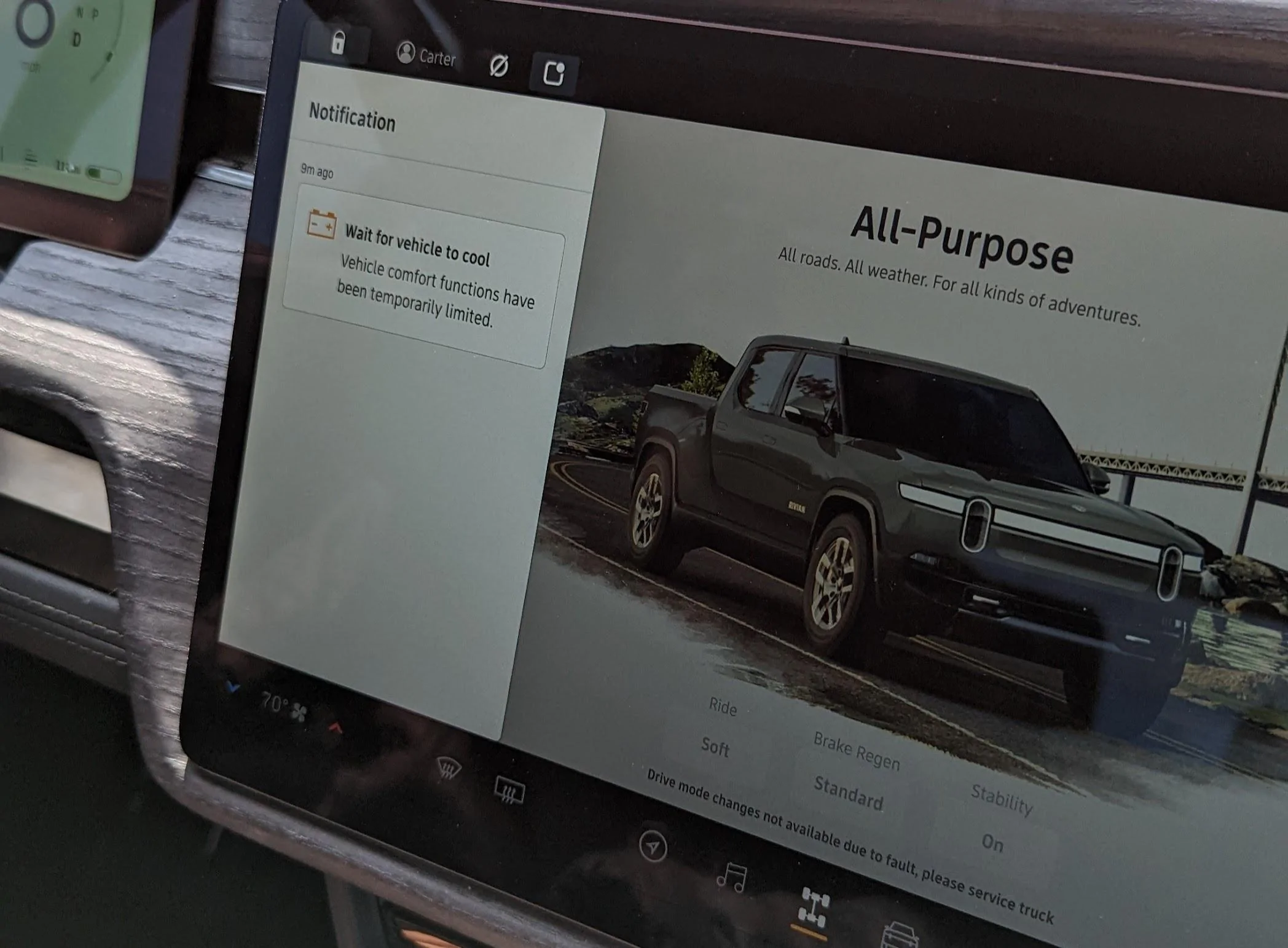

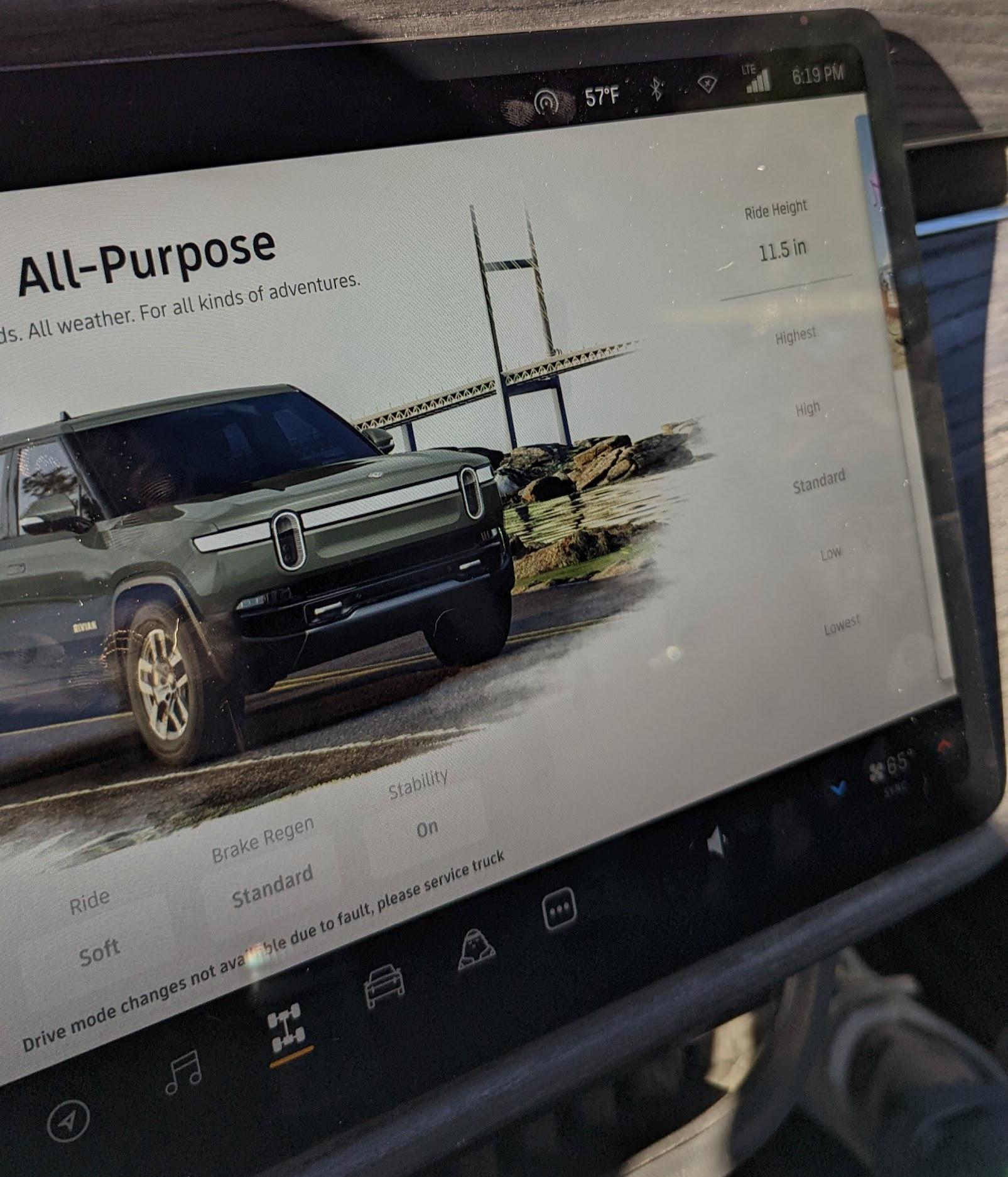

2) 'Drive mode changes not available due to fault, please service truck': At pretty random intervals, my truck is unable to shift drive modes. I tend to get a temperature warning when this happens. The temperature warning doesn't make a ton of sense to me given that it's 57 in San Francisco and we had been driving for just ~25mi or so. This warning does appear to go away once the truck cools down.
Rivian R1T R1S Issues for Service: Anyone Have Luck Fixing These? PXL_20220509_011915576
3) 'Wait for vehicle to cool': Related to the point above, but I also get these temperature warnings more often than I would have expected. I don't think it ALWAYS relates to the suspension issue, but here's a photo of the message another time I got the drive mode unavailable error as well:

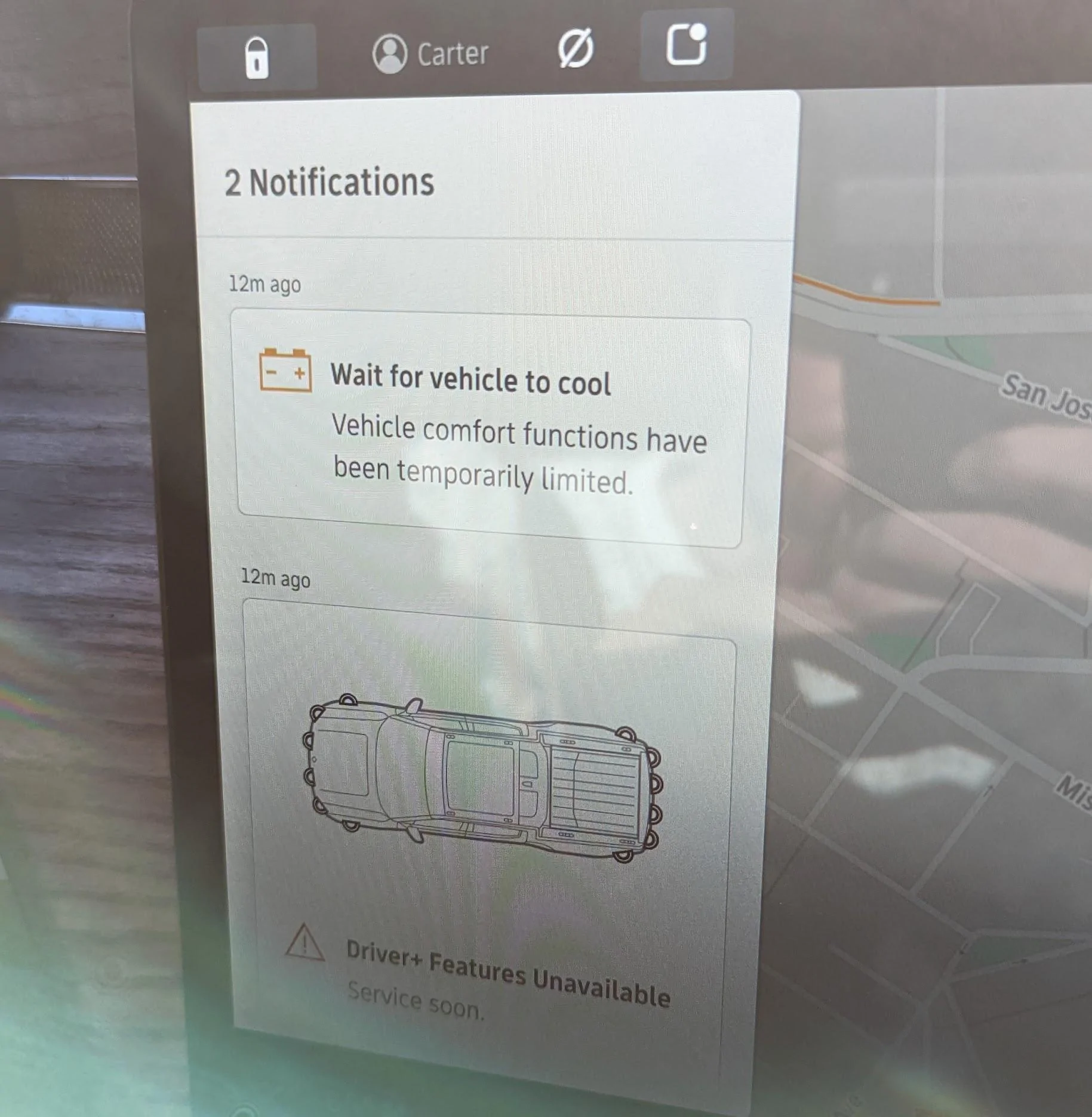

4) 'Driver+ Features Unavailable': This happens with regular frequency when I start up my truck, but tends to go away by the time I make it to the highway. Yesterday, it stayed on for a long while as I was receiving a temperature warning as well.

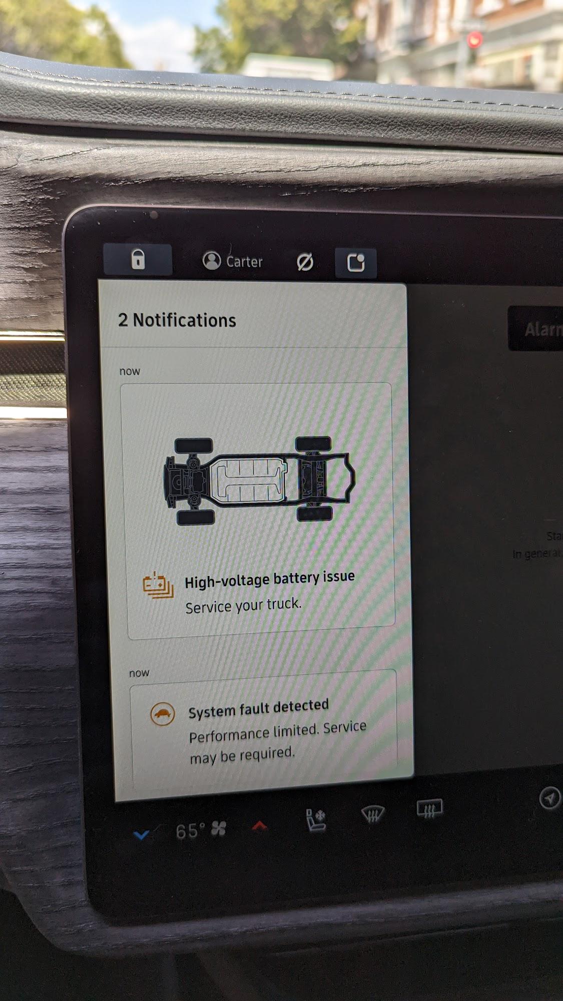

Alright, the latest from support is that I probably have a faulty sensor. I got this terrifying notification today and called back haha
Rivian R1T R1S Issues for Service: Anyone Have Luck Fixing These? PXL_20220509_210109773
I'm still a little (a lot) annoyed that a service appointment takes >2weeks to get, but they'll take a look next Monday.
Hate to break it to you, but I think your truck is totaled. I'll give you $20 to take it off your hands.
Aardvark
Dec 29, 2021
318
626
R1S, Model 3
I will be interested to hear if the high temperature issues and high-voltage battery issues are related. Thanks for posting your updates.
Good luck on getting an earlier service appointment!
