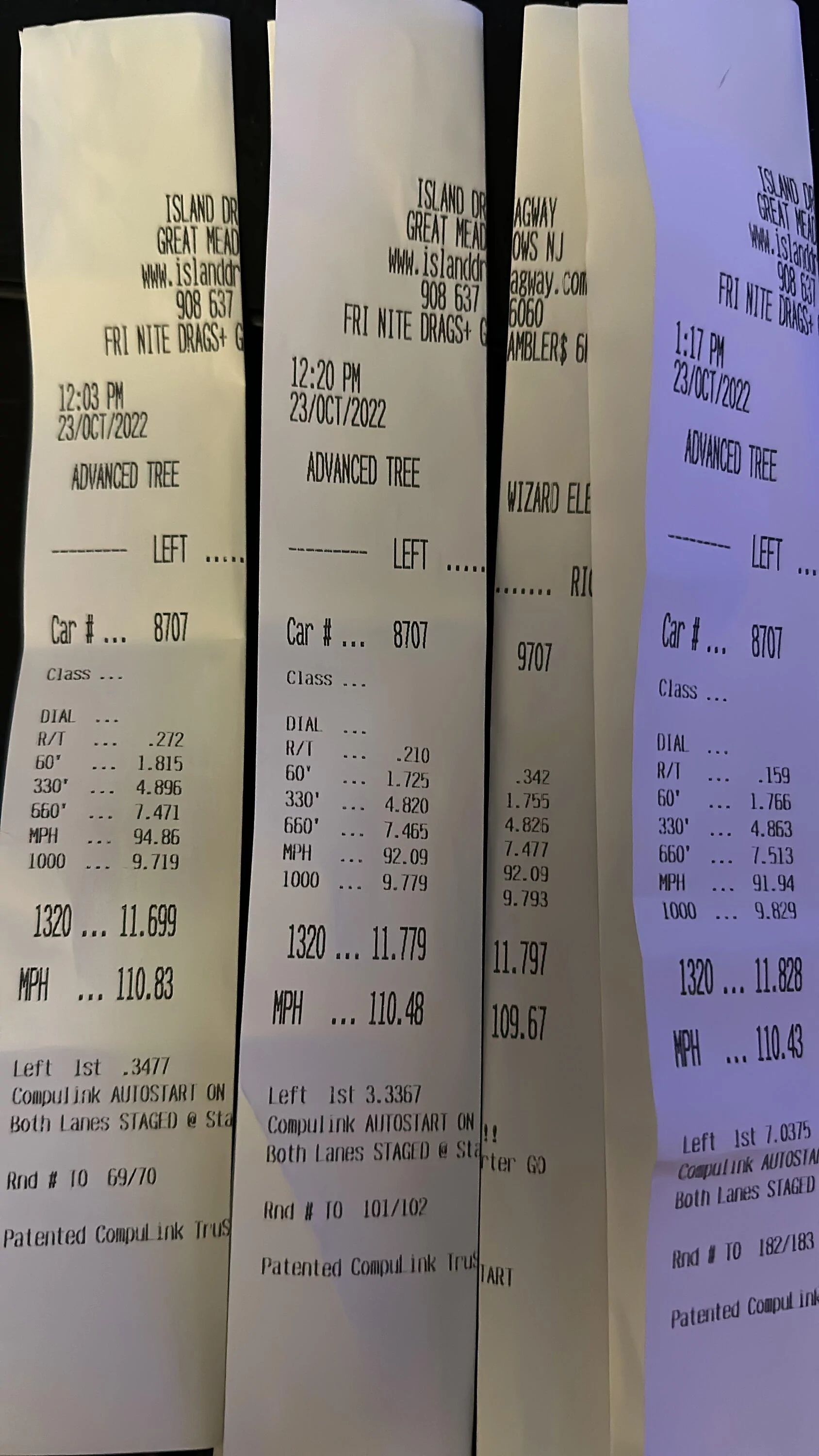

From my experience you start losing performance as early as 80%. However that was during full throttle drag racing. In day to day driving I can't feel a difference between 45% and 80%. Between 30-45% I do feel it be a decent amount slower on hard accelerations. Either way it's pretty fast even at low charge levels and doesn't make a difference unless you are actually timing it or racing.
For reference here are my drag strip results. Fastest time on the left was at around 80% and the last run on the right was around 72%.
