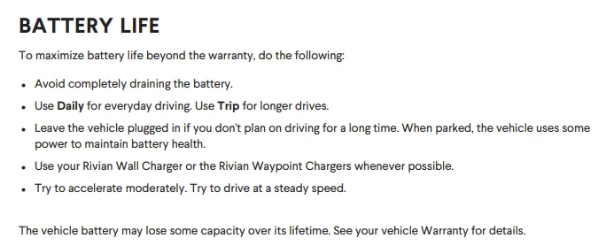

Screenshot direct from the Owners Manual
Rivian R1T R1S Is 70% the best charge limit? 1648825858292

I think I'd trust Rivian and feel OK with it at 70%. General rule of thumb is a charge around 50%+-, but I think you're probably sitting hairs, and the 70% is on the usable capacity anyway.

Other folks have covered the charge limits well, but one thing I'll note it - plug in if you can, even if you're at your charge limit (e.g. 70%). An EV is never truly "off" and will do various things like update, manage battery temp, etc. even while sitting in your driveway/garage. Leaving it plugged in means it can do those things without worrying about also draining your battery a bunch.
Not everyone has charging where you park, so if this isn't an option, you're better off leaving it charged enough that a little drain wont' hurt you. 70-85% should be fine. Don't store it at 100% unless you have to, but it's not going to kill your battery if you have to leave it at 100% overnight so you can hit a road trip hard in the AM - just don't make a habit out of it.
Overall I think Rivian's recommendations and naming are really good - think of it as "anytime," "sometimes," and "occasionally" for 70/85/100 and you'll be fine.
Closing thought - don't stress about it. Unless you're really slamming your battery 0-100 multiple times a week all the time, you're probably not going to notice the difference. A lot of this stuff comes down to trying to mitigate degradation but there are enough complicating factors over the life of your car that it's better to just drive it and not worry. It's kind of like being late for the occasional oil change - not a great habit, but no single oil change due date matters that much. The worst case scenarios for battery degradation with modern EVs are frankly not that bad.
