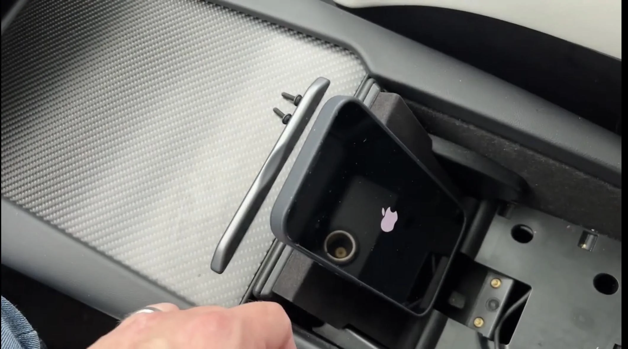

I don’t know what Tesla is doing differently with their wireless chargers, but it’s always worked reliably (other than getting quite toasty).
I think the Tesla ones work is because the camera bump is a non-factor.
On the Model 3 charging pad, the top portion is recessed, so the charging coils sit flush with the pad.
Rivian R1T R1S iPhone 14 Pro is not compatible with the Rivian Charge Pad E6C3A4B4-8F2C-46E4-8969-8624E5CD941E

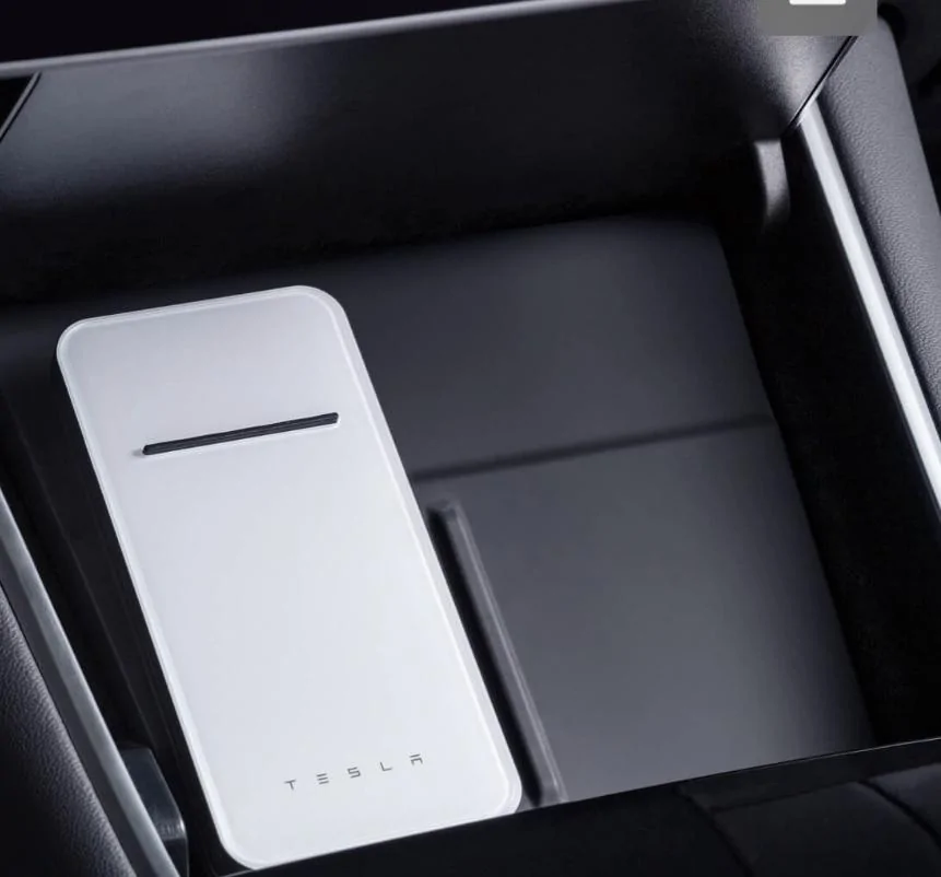

On the Model S, the camera portion sits above charging pad in the center console.
Rivian R1T R1S iPhone 14 Pro is not compatible with the Rivian Charge Pad D334F115-A003-4F08-BEEC-14A6AE39CD70
It’s rather shocking that the Rivian design team couldn’t come up with a good location to mount and charge at least one phone.
I think the Model 3 got the phone location perfect.
