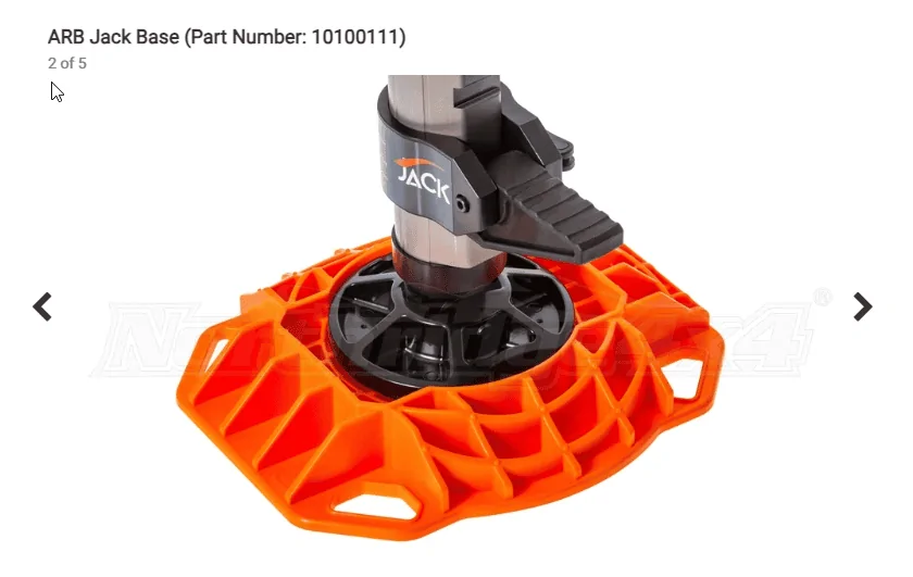

People who have these, how do you use it on the rear? Even with an ARB base like this, which adds 1.4" the rear wheel is barely off the ground?
I had planned to go to 35's, but I guess I'd need to rethink my off road jack solution in that case.
I do have the spare tire, so I wonder if the OEM scissor jack will lift it that high in the rear.
I also have the CAT Off Road Jack, but that thing is a beast, so this bottle jack was a lot more appealing, from a space saving perspective.

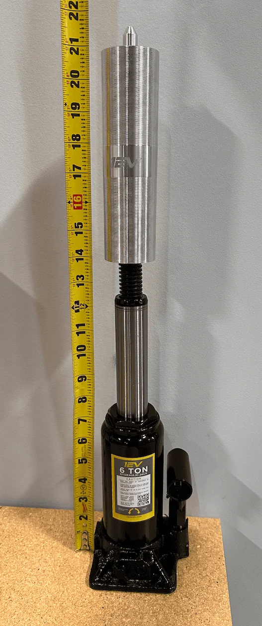

Guys, lower the truck - use standard height. The jack with puck installed reaches 21", which is plenty. If you have the truck in offroad mode, chances are it will be too tall...just lower it. The air suspension vehicle heights vary significantly; we've seen inches of difference between cycling settings. We can't make the jack / puck any taller, or it wont fit under the truck when you have a flat. It's as tall as possible now, and still fuctional when you have a flat (and put it in offroad mode). Note the original photo shows a 3 ton jack, we opted to spec a 6 ton jack instead, which doesnt have or need 2 stages...you got a better jack.

The Rivian can over extend in offroad mode (ie move above spec) due to the angle of the sensors and length of sensor tie bars; in this case, lower it to solve the issue - one setting down should do it. Chances are if you lower it and raise it back again, it won't go as high. The air suspension is finicky for sure.
If you have to pull a wheel off for some reason on a trail in a tough spot, but find yourself unwilling to toggle the height of the truck air suspension on the screen by 1 position, would you really not toggle it? Probably never really the case? Reality, in off road duress you're likely to find flat and stable ground before you do anything. I would recommend this before attempting any jacking. The ARB plate or any similar base stabilizer is never a bad idea.
Yes, with 21" of vertical jack lift you can get the tire off / on, always.

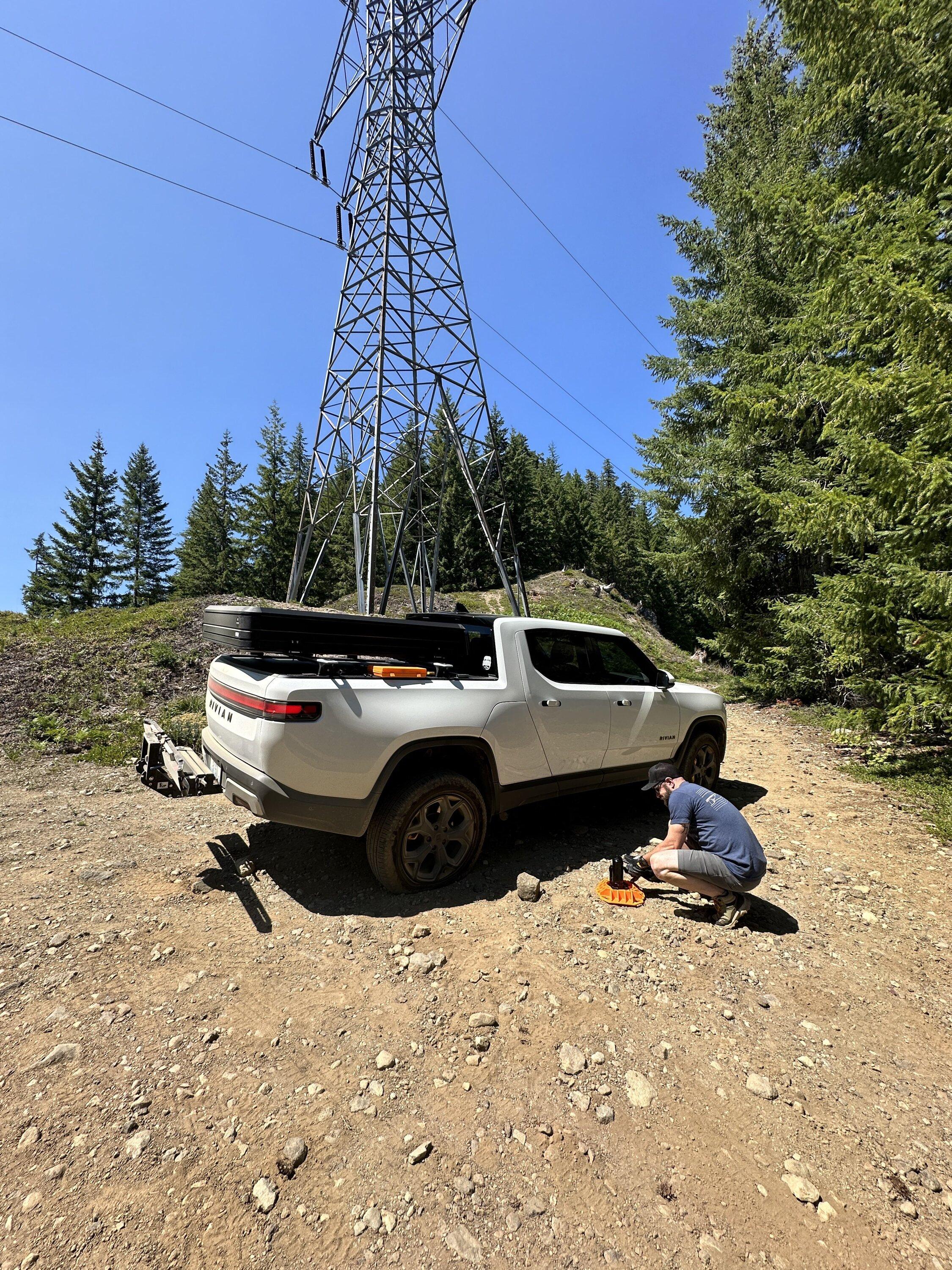

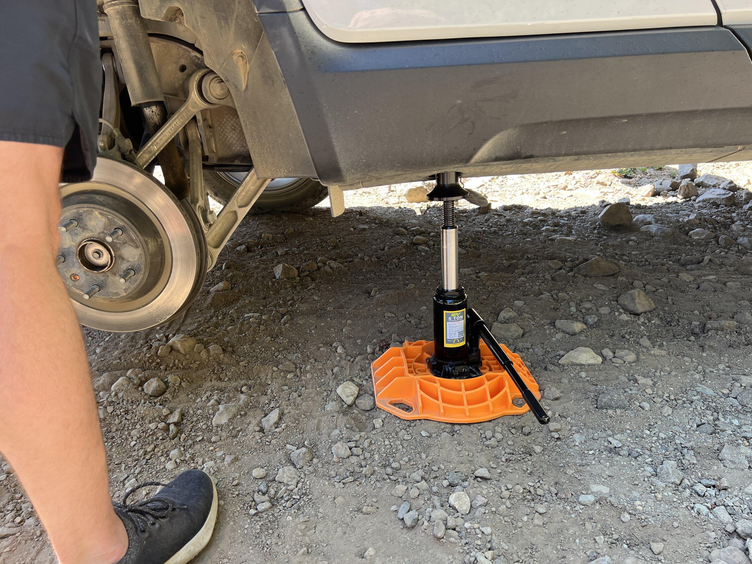

So I had a chance to use the bottle Jack in the wild today on a flat rear tire.
We had the truck in, the Rivian recommended, off road high and with the way the truck was angled, there was no way to get the included tall extension on the Jack, so we had to use one of my megawatt pucks, which work with bottle jacks.
An ARB, or equivalent, base is also a requirement to use this jack off road, as otherwise the footprint of the jack is too small.
With the bottle Jack maxed out, we managed to get the, completely flat, tire off, but had to deflate the spare to 8 psi and use the Rivian scissor jack under the knuckle, to compress the suspension enough to line the hub up with the wheel.
So, long story short, the jack works, but requires some creative thinking to make it work in non-ideal situations.

@Leonbmx ... once you finally got your R1T off the ground to the required height needed to swap out wheels- did it try to move downhill or was the e-brake on the opposite side rear tire enough to hold the truck in place?
Thanks for the heads-up regarding the ARB baseplate.. just ordered one.

We had the wheels chocked, so no movement.
usulio
Jun 2, 2023
323
382
Thanks for sharing this experience. I wonder if hooking up the air compressor to the flat tire would have given enough temporary lift to get the bottle jack with extension under there.
Rivians seem tough for bottle jacks generally from what I've read. I am hoping rock sliders will make it a lot easier.

Guys, there is a much, much easier (and free) solution here....just put the vehicle in a lower mode. The bottle jack provides a full 21" of lift (1" more than the factor Rivian scissor jack). Plenty of lift.
There is zero technical reason or benefit to putting the truck in the "highest' mode possible before jacking it up. This is only recommended by some vehicle OEMs with air suspension because air suspension is electronically controlled and "IF" you pulled a wheel off the truck in the lowest most, then put the wheel under the axle, and then went in your truck and toggled the highest mode while the truck is on the jack, you could "possibly" cause the vehicle to extend the wheel hub down and impact the wheel you took off and have the truck destablized on the jack - crazy stupid stuff, yes...but technically possible and OEM's want to protect against stupidity.
We simply recommend putting the truck in High Mode, the bottle jack works perfect... not other components are needed.
That said, if you're going to use the bottle jack on unstable ground (ie soft direct), sure put a stabilizer under it....or move to stable ground.
