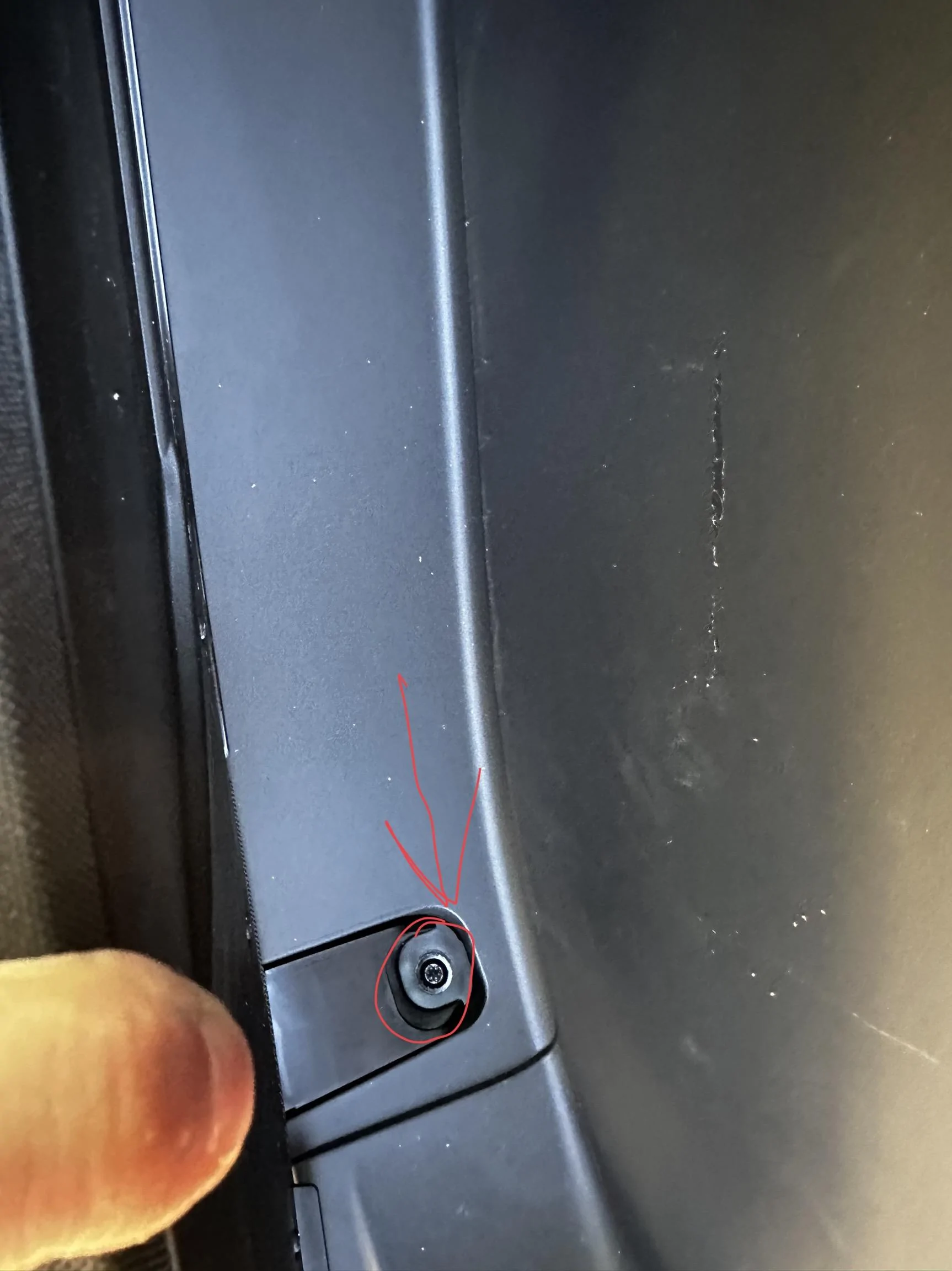

Here is a small write up on how to remove the door panels. I started this project because I am experiencing a rattling/squeaking sound from my passenger door. It’s been driving me crazy!!!!!
I took my R1T to the El Segundo service center last week. They had me drive the vehicle with a mechanic to verify the issue. He agreed their was a squeaking sound coming from the panel.
Several hours later they called me to pick up my vehicle. I asked if they fix the problem the service advisor told me yes. They added felt to several areas to reduce vibration.
I wasn’t able to pick up my vehicle until after hour. As I drove the vehicle home I immediately noticed the squeaking sound.
THEY DIDN’T FIX SHIT!!! After removing my panel I can see they didn’t add any felt tape. Honestly this service center is a waste of my time and Rivian’s money. I don’t know who’s lying the service writer or the mechanics. But there is a definite issue at this service center. And this isn’t the first time I’ve experienced this. My vehicle has been to this service center probably 20 times. It takes multiple repeat visits to fit and issue. Basically if the Manager of the service center doesn’t handle it directly then they problem its repaired. This was my first minor issue. The rest have been major issues. Like battery swaps, leaking suspension, etc.
OK enough with the rant!!! Here you go!!!!

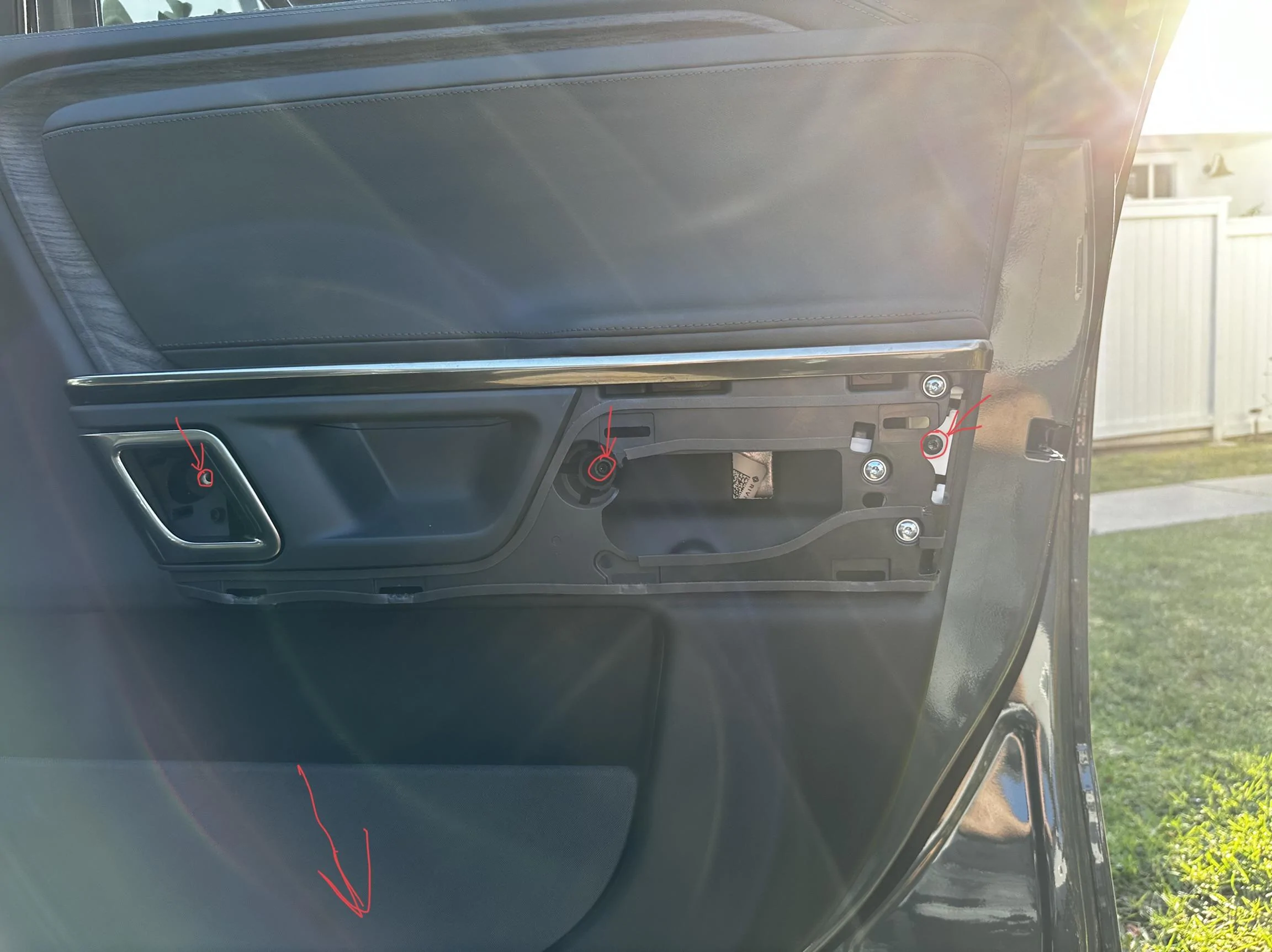

First you will need to remove the 2 panels to access these 4 screws (they were a torx 20 or 25) you only need to remove the 4 black screws. The chrome ones you can leave alone.
Rivian R1T R1S Interior Door Panel Removal Instructions? 3B9BA9CE-AD0D-444F-A5E7-DE5BFF8E1B8B
4th screw is inside the door side compartment
Rivian R1T R1S Interior Door Panel Removal Instructions? 78CA76C3-235E-4DC1-9E48-BEDCBC78666F

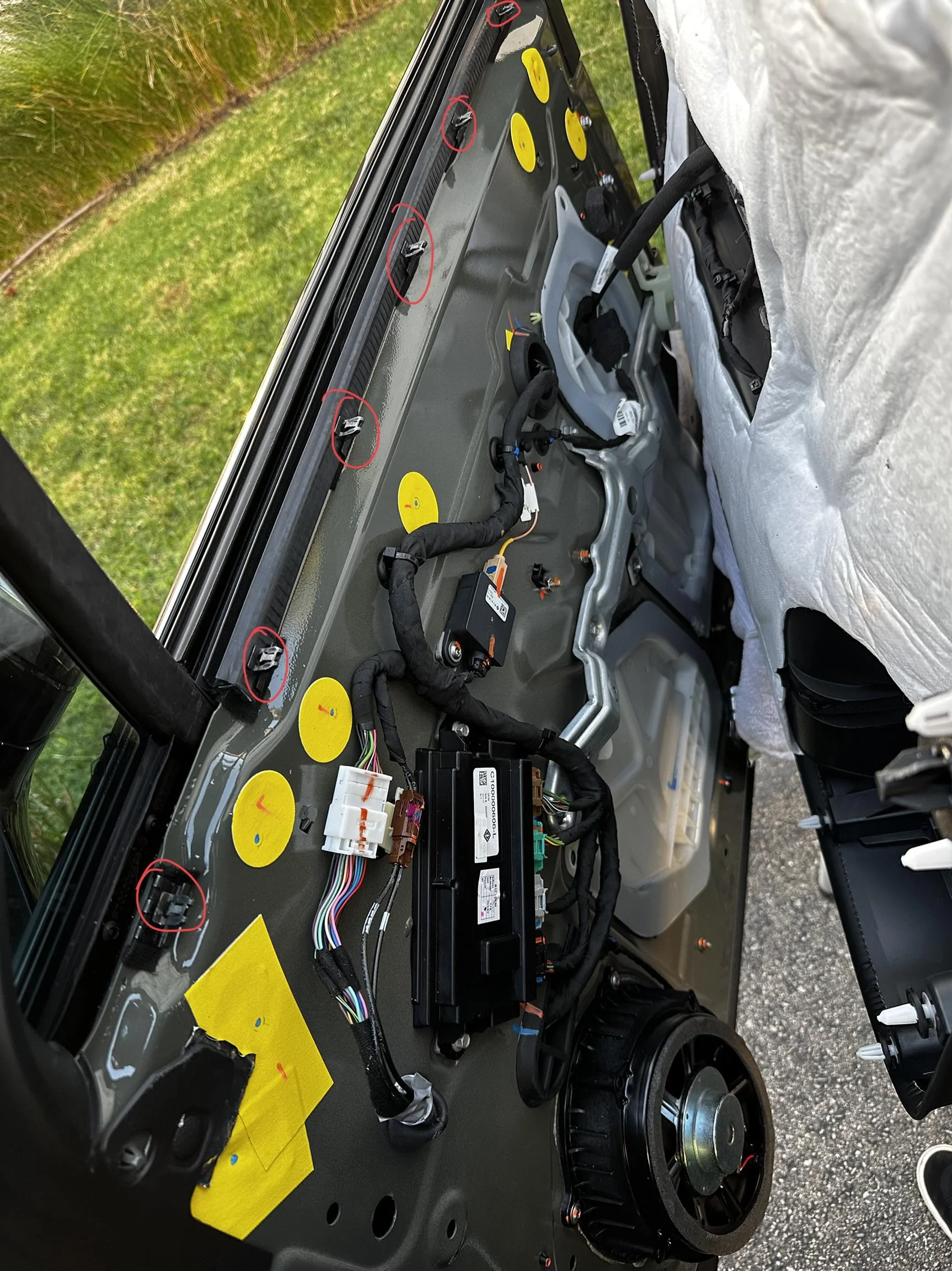

Next you will want to push down on the clips along the top to release them. The one on the very left was a pain to reach.
Rivian R1T R1S Interior Door Panel Removal Instructions? 210BB5C7-0379-4141-8660-55CB74B3266B
At the point there are about 8 white plastic push clip that are holding the door around the sides and bottom. They all pop out rather easy.
And your done!!! Panel removed.

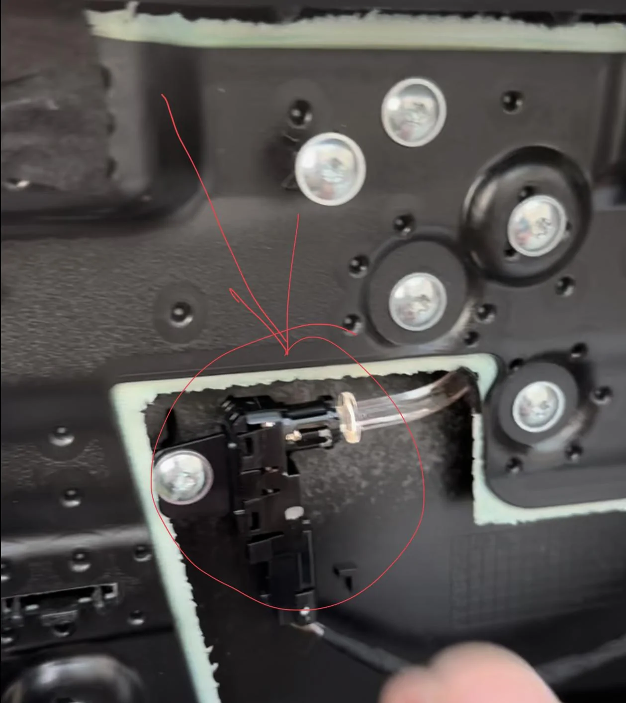

I also mentioned to the service department that my door speaker vibrates when bass is present in the music. Well they didn’t check for that either. I had 2 screws that weren’t fully tighten.
As I was checking for other loose screws, the screws holding the door accent lights were loose. When I wiggled it, it made the sound I hear while driving. I ended up added foam tape and felt to help dampen it.
Rivian R1T R1S Interior Door Panel Removal Instructions? 45C7499D-E612-4E3D-968C-6CEC0C6C35A1
Before closing it all back up. I added felt tape along all the clip areas. And I tighten all the panels screws. They all could use a 1/4 to 1/2 turn. Hopefully all this helps.
