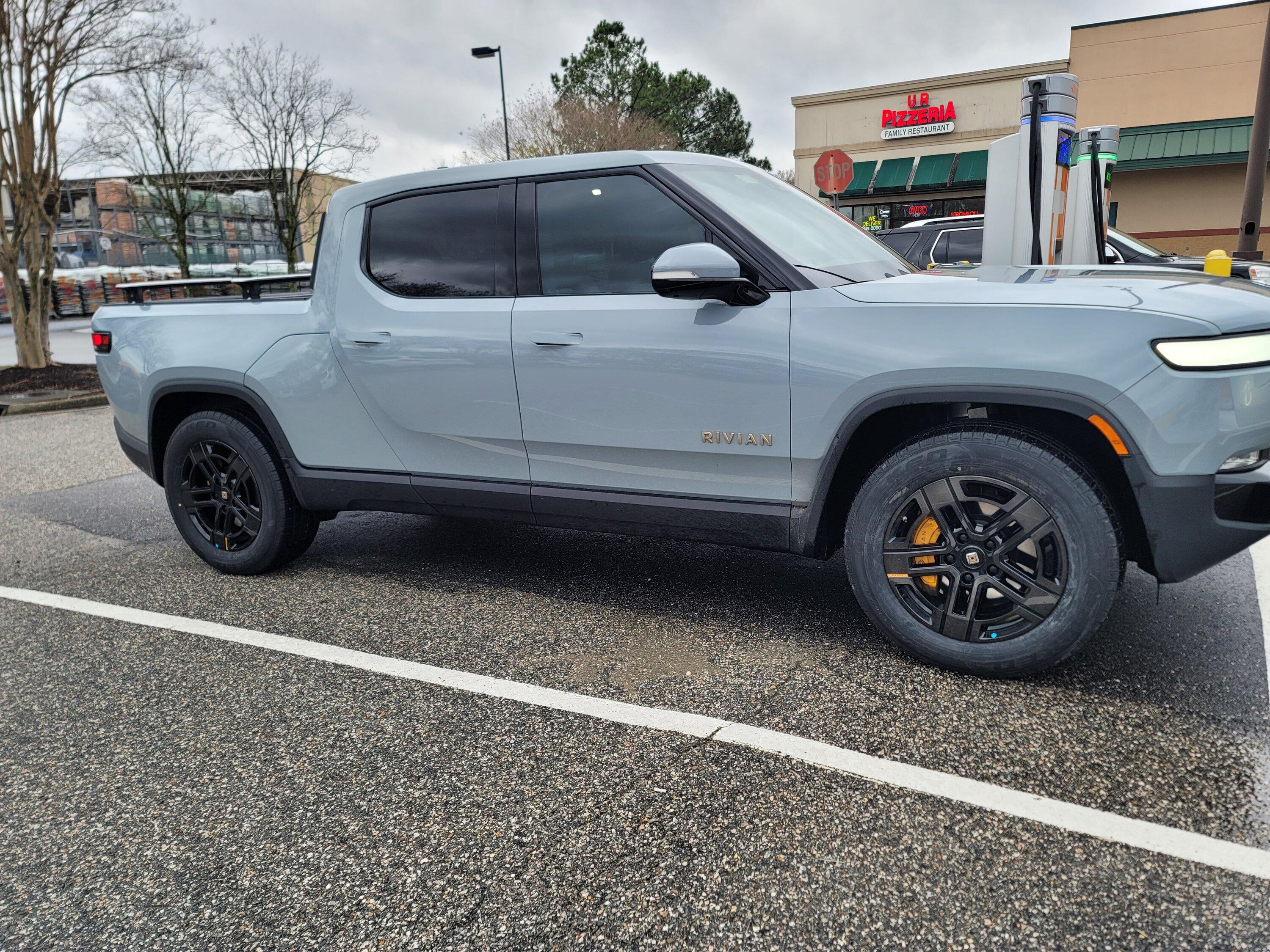

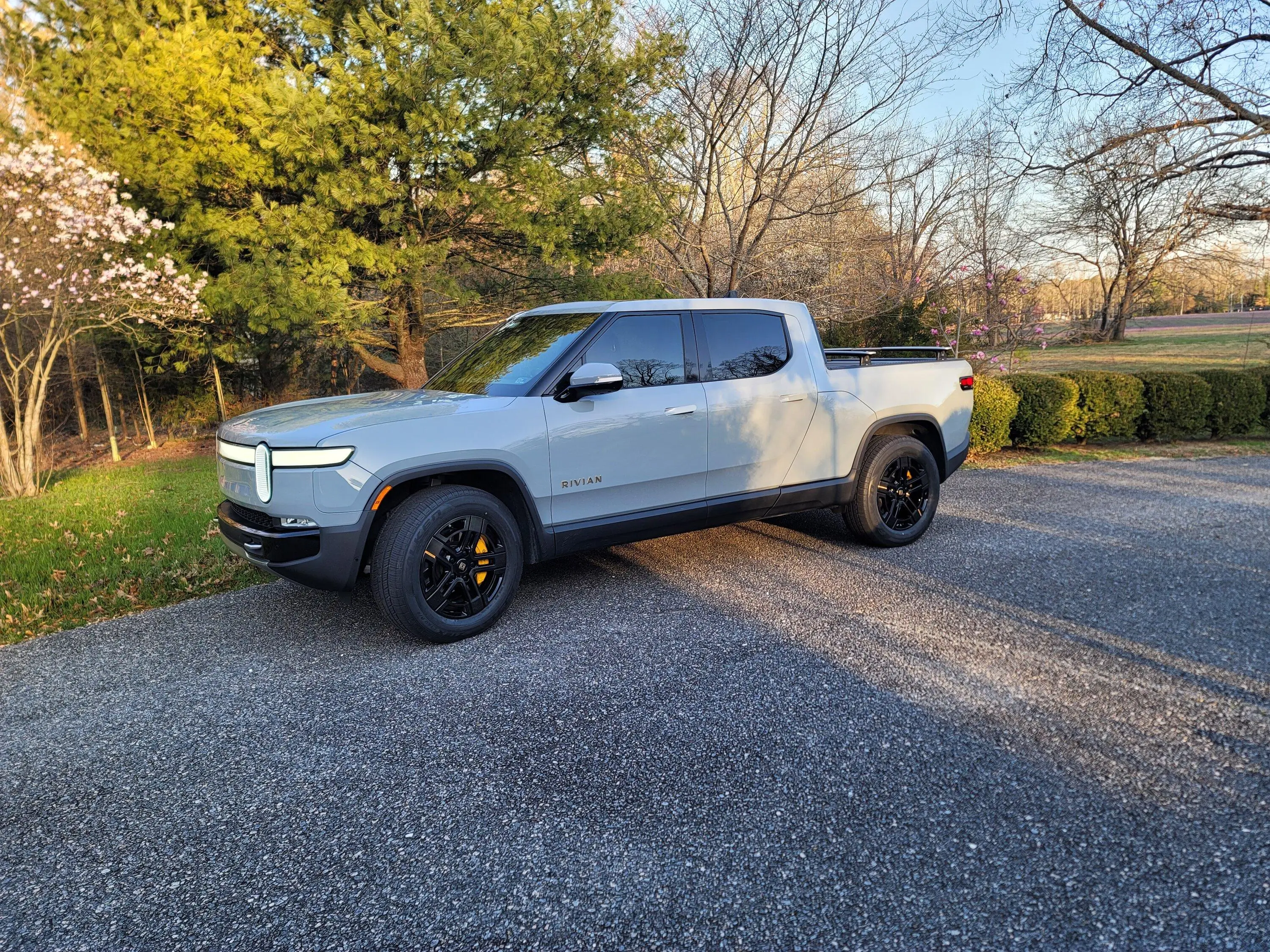

Just got a set of 20" at darks and put the Falken Ziex CT60 A/S in 275/60/20 tires on. I have another post where I tried the at wheels with this same size tire in the pirelli as plus 3s. They were nice but just trying a different set of tires to see if there are any differences.
I've only driven like 50 miles on them and still need a few hundred more miles to break them in a bit more... but initial impressions at about the same as the pirellis. I would say just as quiet but ever so slightly more comfortable... it could be just in my head but definitely feels less jarring over smaller bumps.
Over next few weeks I'll keep posting about break in and mileage but liking the tires so far... haven't washed the wheels and tires yet so still a bunch of tire mount grease.

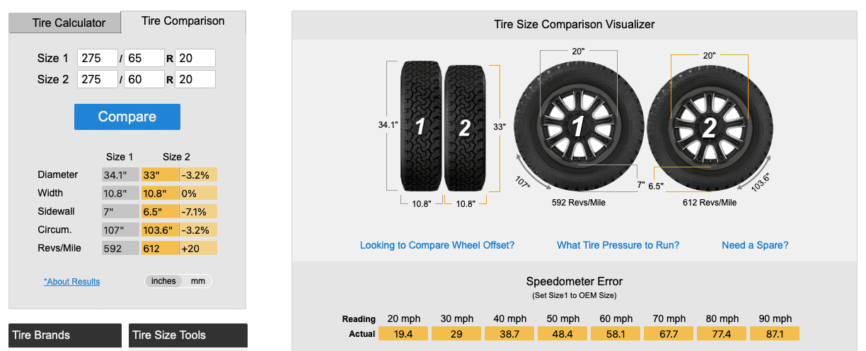

You probably know and did so intentionally but there is a diameter difference between the 275/65/20 vs 275/60/20.
https://tiresize.com/calculator/
Rivian R1T R1S Installed 20" AT wheels with Falken Ziex CT60 A/S275/60 tires 1676754823165
So you actual range is reduced also since when the vehicle thinks you've traveled a mile, when in fact you have not. The vehicle odometer will be off from actual distances too.
LIke I'd said, you already knew this..
yes I did already know this and the reason why i went this route was because I wanted to keep the same diameter of my original 21s which I did not have rivian reprogram my car for the 20s. also there are a lot more highway tires available in the 275/60/20 over the 65 ratio without going the lt tire route.
Didn't notice your post above saying you originally had 21". Good call on your choice to goto 275/60/20s. Lot more options than 55 or 65 series.

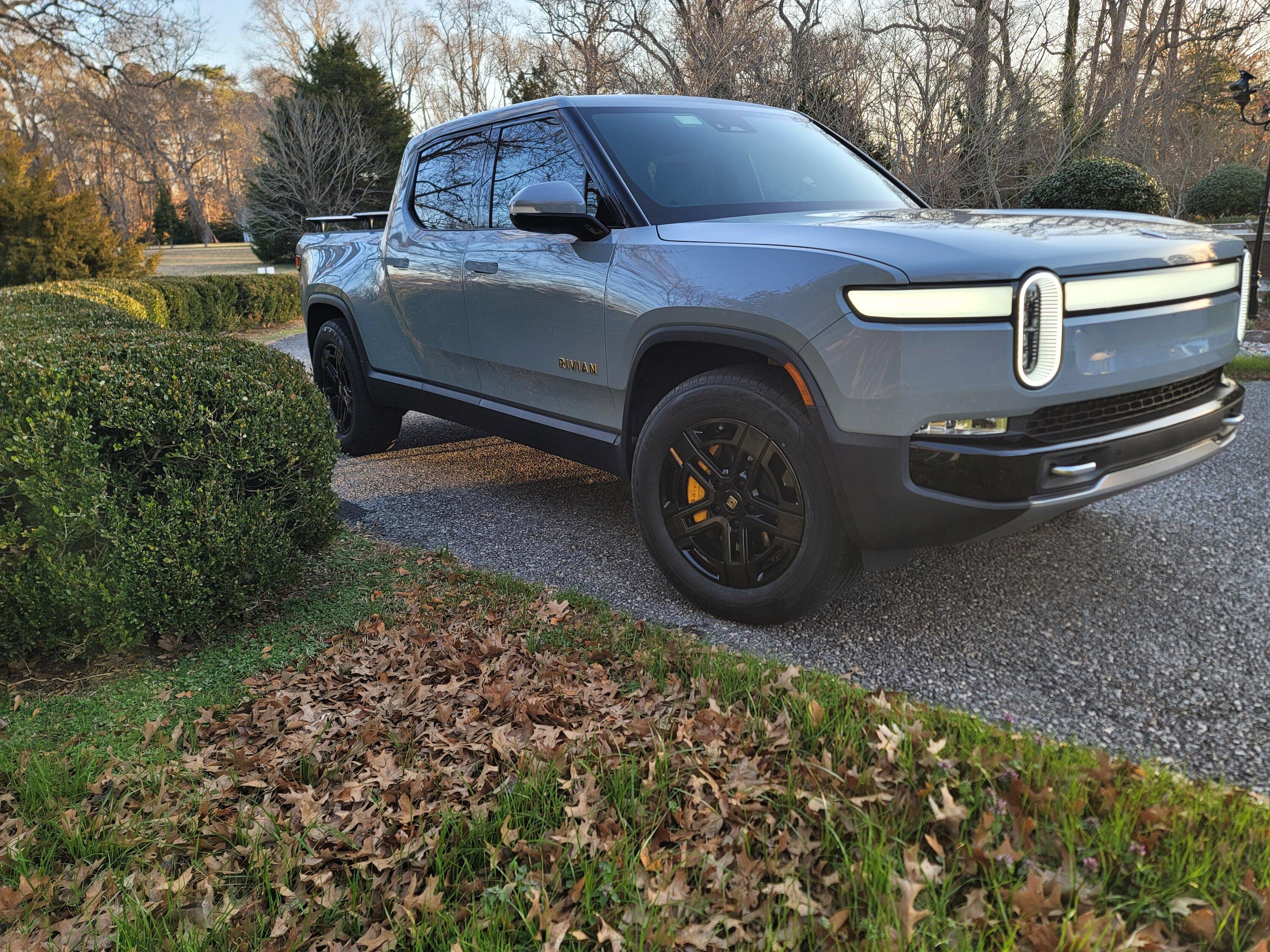

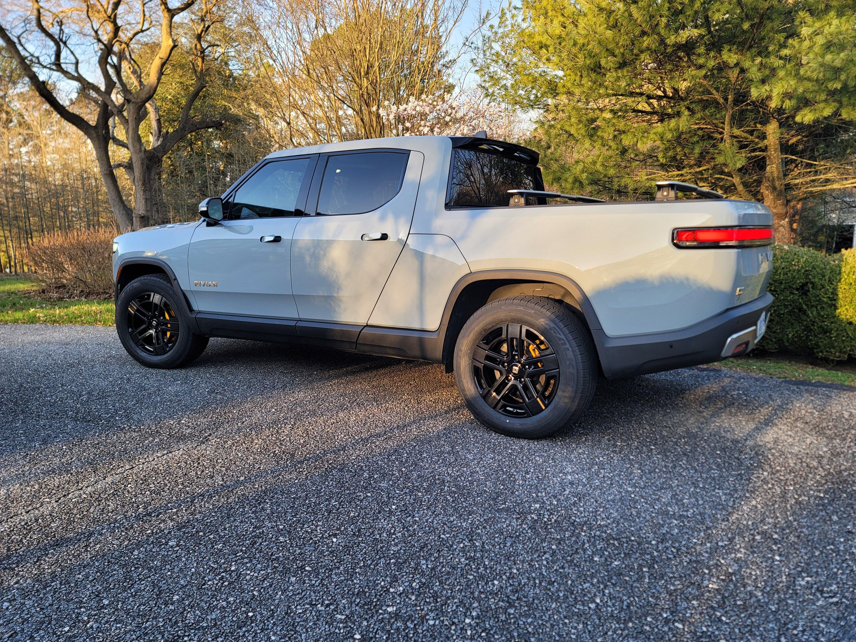

If you get a chance, can you post more pictures at other angles. I have the dark 20s as well so I'm interested to see the profile some more. Thanks!
Here are a couple more pictures
Rivian R1T R1S Installed 20" AT wheels with Falken Ziex CT60 A/S275/60 tires 20230222_072750
Rivian R1T R1S Installed 20" AT wheels with Falken Ziex CT60 A/S275/60 tires 20230222_072810
Rivian R1T R1S Installed 20" AT wheels with Falken Ziex CT60 A/S275/60 tires 20230222_072833
