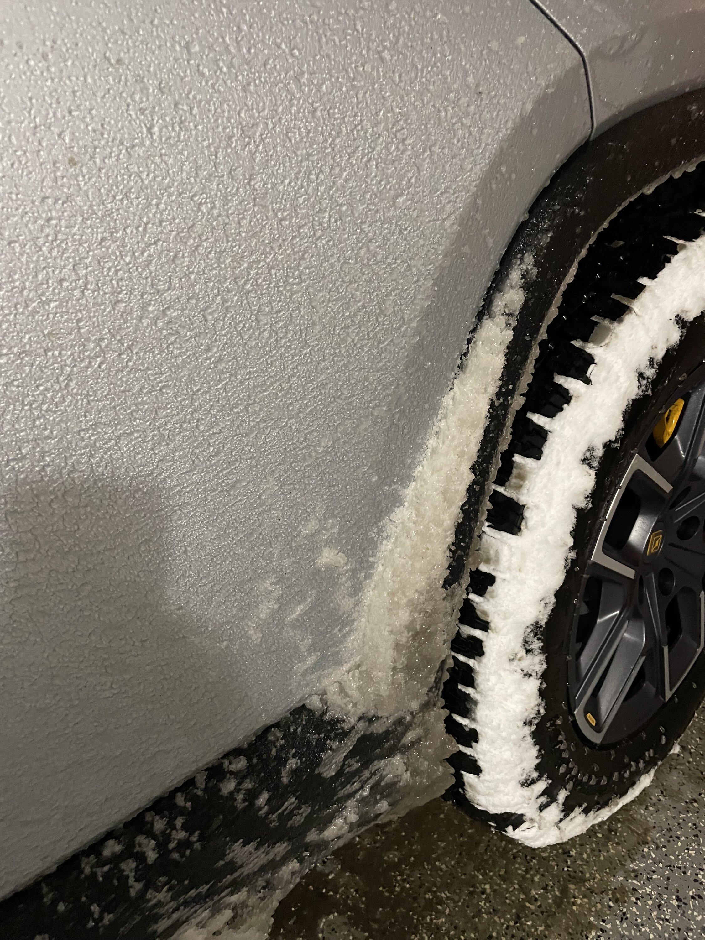

  • After driving, the gear tunnel doors wouldn't open. I had to clean off all the snow/ice that had accumulated from the throw from the front tires. I'd never put mud flaps on this truck but that will be an ongoing issue. See photo of where it gathered:
  • Rivian R1T R1S Initial Winter Driving on Snow -- Experience in R1T on 20" AT IMG_3618

Rivian R1T R1S Initial Winter Driving on Snow -- Experience in R1T on 20" AT IMG_3633
