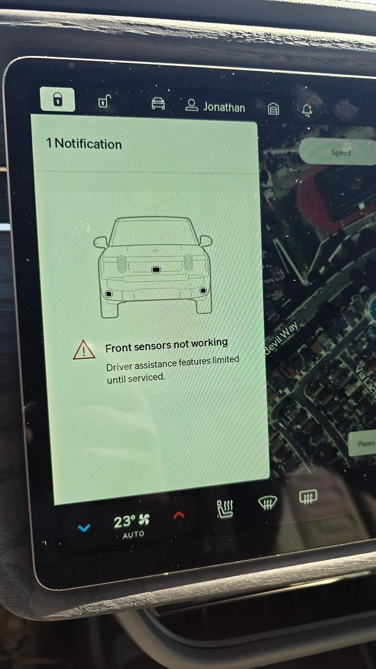

I'm still at Rivian service center, picked up my R1S and this happened as I drove off

Rivian called me and asked me to do another hard reset.
Then after it didn't work, they said that they have gotten feedback from the factory that during the body and bumper assembly it seems that they have records showing that the factory workers have been accidentally pinching the wires that connect these sensors. Since the wires are very thin, it could look visualy okay but it might be severed inside the wire insulation.
So they asked me to bring back the car back tomorrow and they will first run a sensor calibration procedure. If that fails, they said most likely it is the pinched sensor wires issue. And then said they can change the wiring easily and quickly.
So, I'll keep updating everyone.

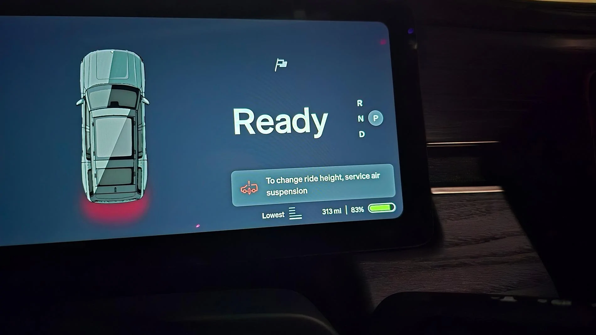

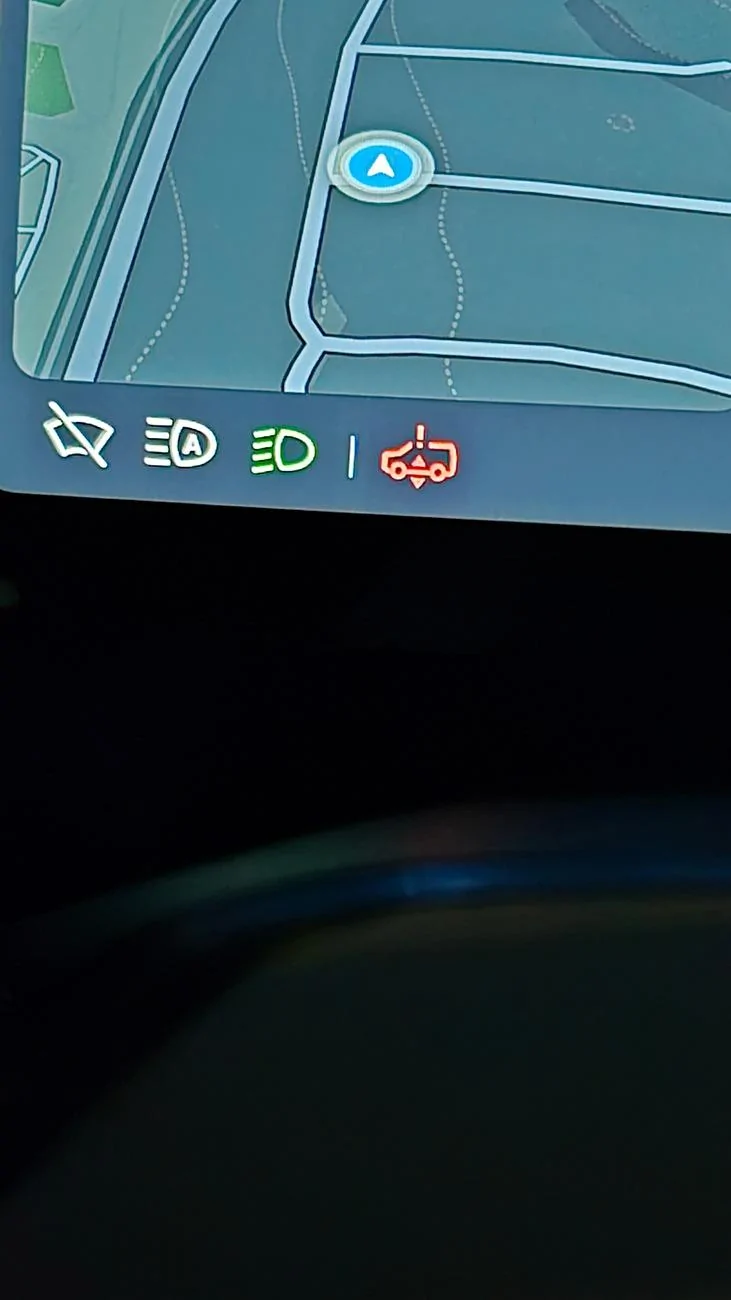

Went on a little test drive this evening, and I thought I had noticed this, but the kneel on park function does not work.
So I selected sport mode to lower the car so other passengers could get in easier. Then when I tried putting it back into All Purpose, yet another problem shows up on the screen! The suspension broke!!!
Car said suspension broken and it's stuck in lowest height in sport mode and will not switch to any other mode!
After driving like 500ft I stopped and did a hard reset, and that fixe the issue.....here is the screen shot.
Man, this is the most buggy car I have EVER bought. A 100k+ buggy computer on wheels....and they say it's using NVDIA chips, I think it's using the Intel 13k and 14k series with that melting bug in them....
That is awful, I am so sorry! I wonder if this is a similar issue to the vehicle I was supposed to take delivery of.
They tore apart the entire suspension and found nothing wrong. Because it's a brand new platform that's only been on sale a couple months, they weren't quite sure how to diagnose the computer side of it (what they said was the source of the issue). So they had to contact engineering.
I was told that when they bring in engineering it significantly slows down the process, because they are extremely methodical and take their time when instructing the technicians on how to proceed. When I picked up the new vehicle, they were STILL working on the original (it was 2.5 weeks at that point)
You should definitely insist they either buy back, or switch you to a different vehicle. 2025 is a BRAND new platform and you will absolutely experience some bugs (I know I have with mine). But what you're experiencing is far beyond the "bugs" that you should be seeing.
