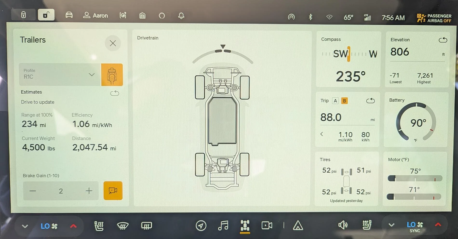

Pulled my 4,500 lbs. converted cargo trailer from central Illinois to San Diego. It's been an adventure to say the least.

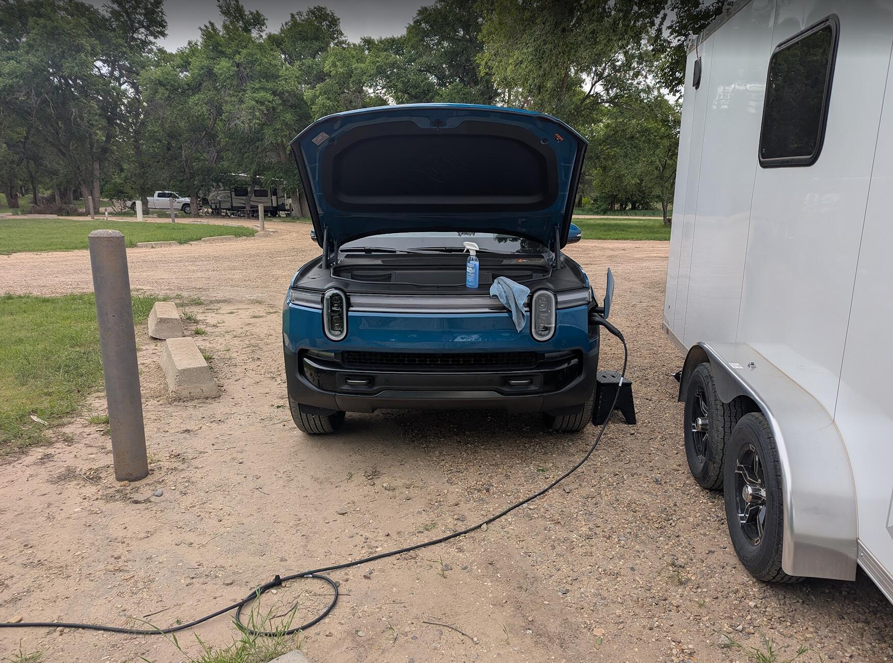

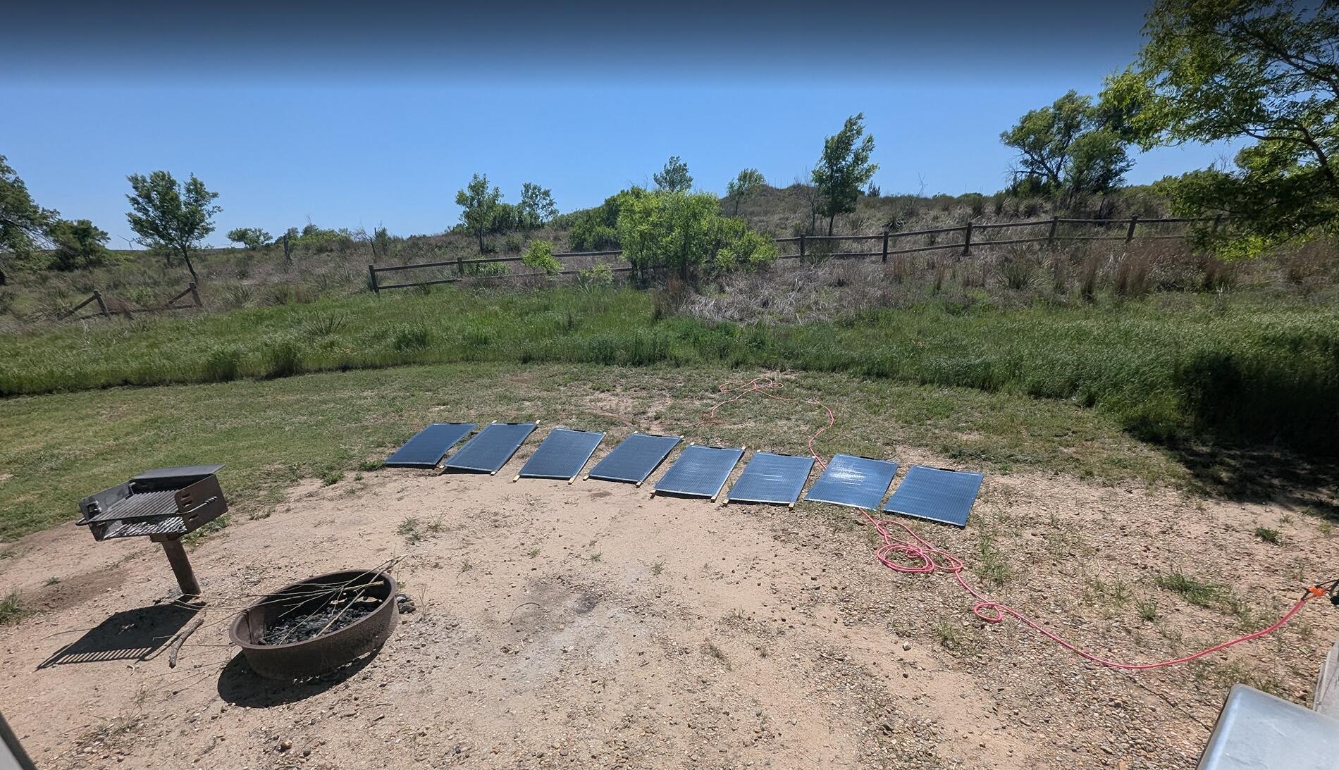

Dead zone for EV charging entering Texas panhandle to Amarillo. Luckily found a National Forest RV park with 110v charging. Had to stay there for three nights to charge with camp power plus my 2,000 watts of solar.

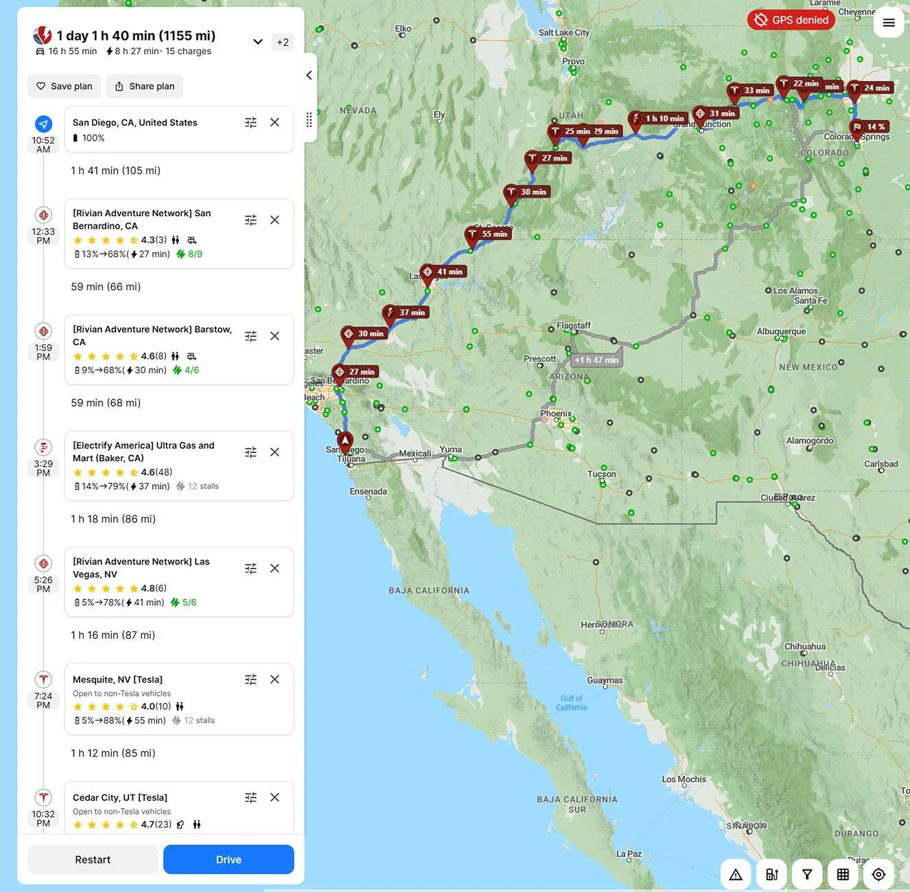

When I put in San Diego to Colorado Springs, https://abetterrouteplanner.com/ it says, "No working plan could be found."
So this should be fun.

Check your settings in ABRP. I set the efficiency to 1.0 mi/kwh and it looks like that trip should be possible, assuming a large pack quad.

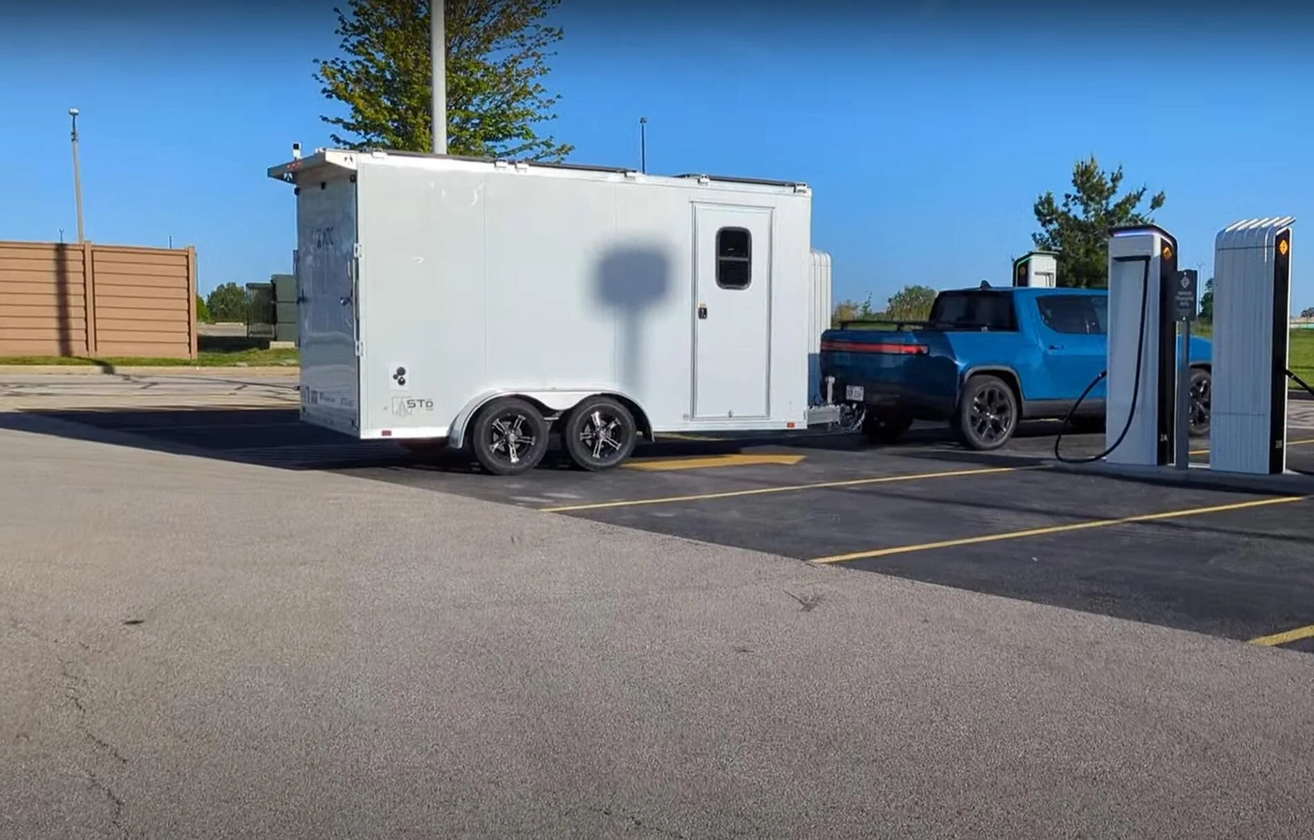

Most stops I've had to unhook the trailer to get to a charger.
I'll try ABRP again with different settings.

I also wish it would show state of charge percent instead of miles because the miles is shows is without hauling a trailer.
Also, in the image I show above I have no idea how they are calculating the "Range at 100%" in the Trailer Estimates.
That is way WAY off, by more that double.

ABRP (and built in Riv Nav) are good STARTING points for longer drives but they are not the end all. To do long western Mtn pulls you 100% need to invest the time in on PlugShare to cross ref options and routes. I also pull in google mapping to see what amenities and locations are like via StreetView. Lastly, the Supercharge.info website is a must. Not a Tesla guy but must give a nod to the charging infrastructure. It's solid. [Edit to note the map is showing Cortez, NM SC nearing completion which is very much in the zone of routes that might work) ABRP/RIV sometimes makes odd choices in what they prioritize or the routing saving a few miles vs a MUCH better charging stop etc. Towing (I have not done) you likely have to plot your own course or FORCE the ABRP to make changes manually entering in efficiencies etc as done above. All that said, I tell everyone that asks I love my Rivian but would never tow with it at distance. It's just not great there. And everyone that complains about road tripping not being cheap with an EV. Yup - same as gas if not more expensive. But what % of your annual miles are DCFC? 15%?
