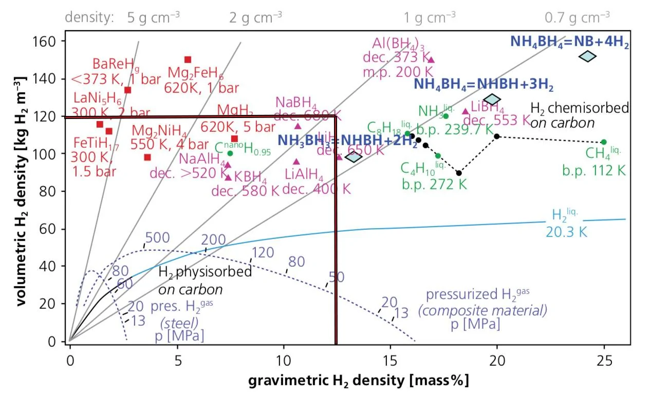

This graph shows various compounds and their gravimetric and volumetric densities. The red lines are gasoline equivalents based on 60% fuel cell efficiency, and 30% ICE efficiency.
The problems are that these materials might take on the hydrogen too slowly, or release it too slowly, or only at high temps, or only a small percentage, or are difficult and expensive to reproduce in large quantities, etc. Various different mixtures are tried to see what works best, just like in the battery world. If one of these in the upper right of the chart becomes commercially available, then even aviation will become electric. If the hydrogen was produced via solar, it would be carbon free, and the operating costs would be less than 1/5th of what they are now.
