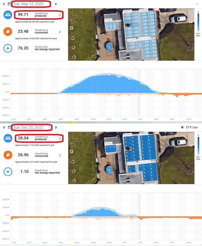

Keep in mind you're also going to see a gigantic variance in total kWh/day output based on date/daylight hours per day and the very low height of the winter sun in the sky...
Look at my daily output for May 12 (99.71kWh) vs Christmas Day (28.04kWh) and by the graphs you can see both were cloudless days... just less light on Dec 25 than May 12th.
