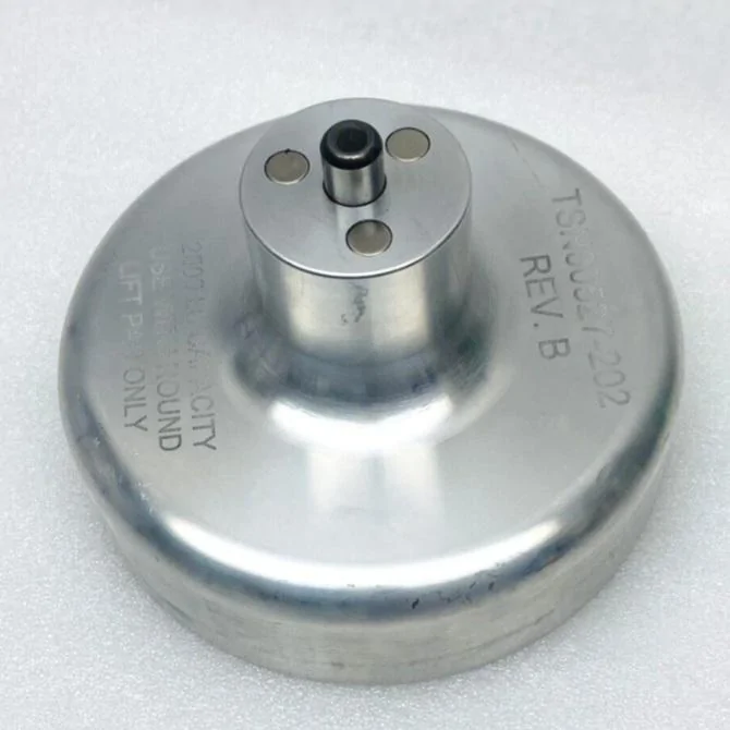

I delved into this problem with my local, Denver, SC.. When a mobile service was out to work on my truck.
What I found was interesting.
The Pucks that Rivian Shops and Mobile Service uses are HUGE. Like monstrously huge! The head, and pin, are about the same size. The shaft is shorter. But the cup that fits onto the lift, or jack, is where the difference was.
I did not have a tape measure to measure it, but I did have 5 of the magnetic type of pucks from MagJaxx I think.. I think the bottom cup was around 10-12 inchs across, maybe more. It was just HUGE.
All 5 of the MagJaxx pucks would fit into 1 of the Rivian Shop Pucks, with space still available.
This is why they will not work on a truck with running boards. Their pucks wont fit, and would damage the running boards if they tried. Them being shorter on the shaft, and so much larger on the "cup" end.
Maybe if someone has a mobile service scheduled, they can ask, and snap a pic. I did not even think about it, until just now.
Yup bottom part is huge.
