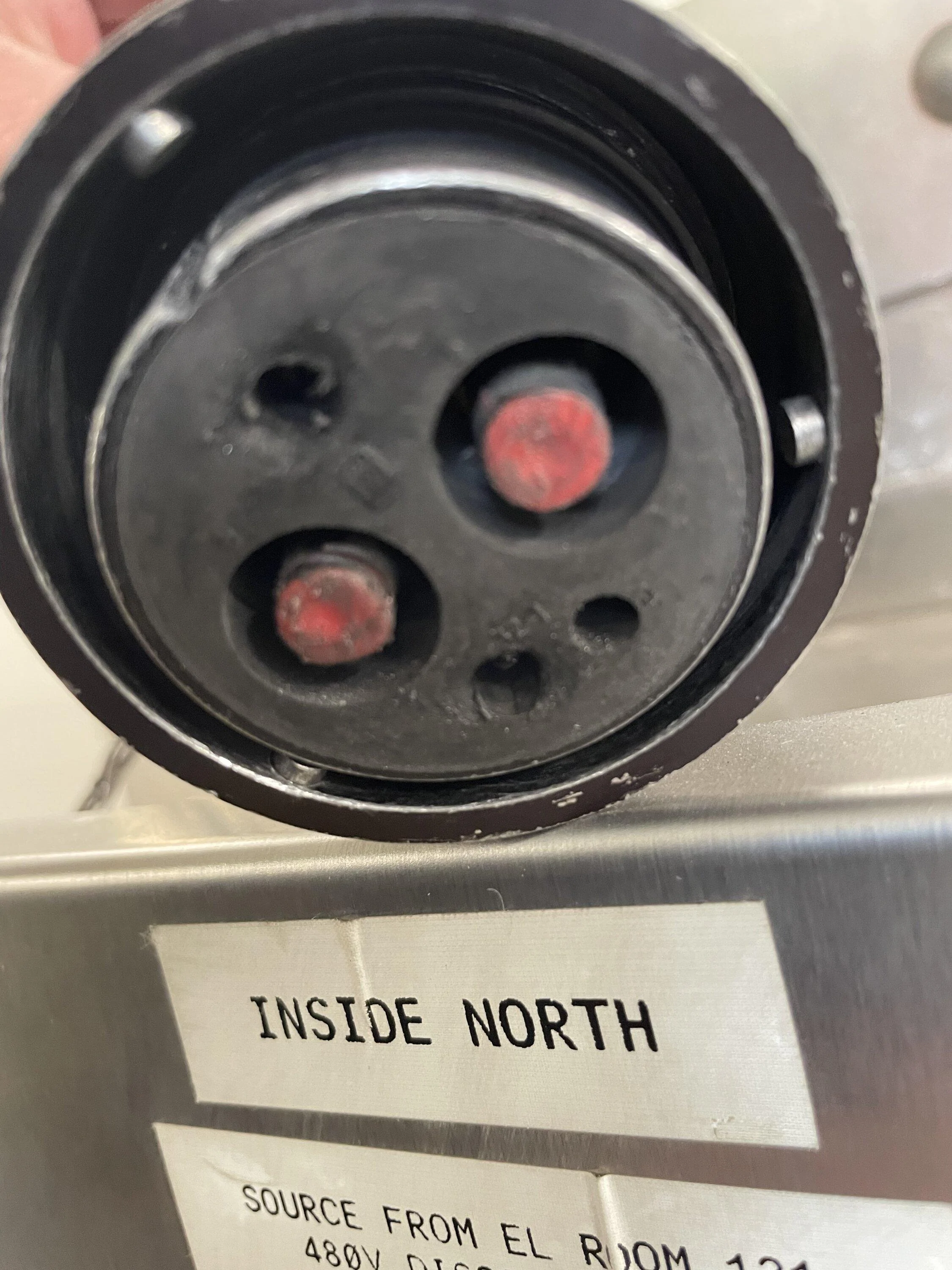

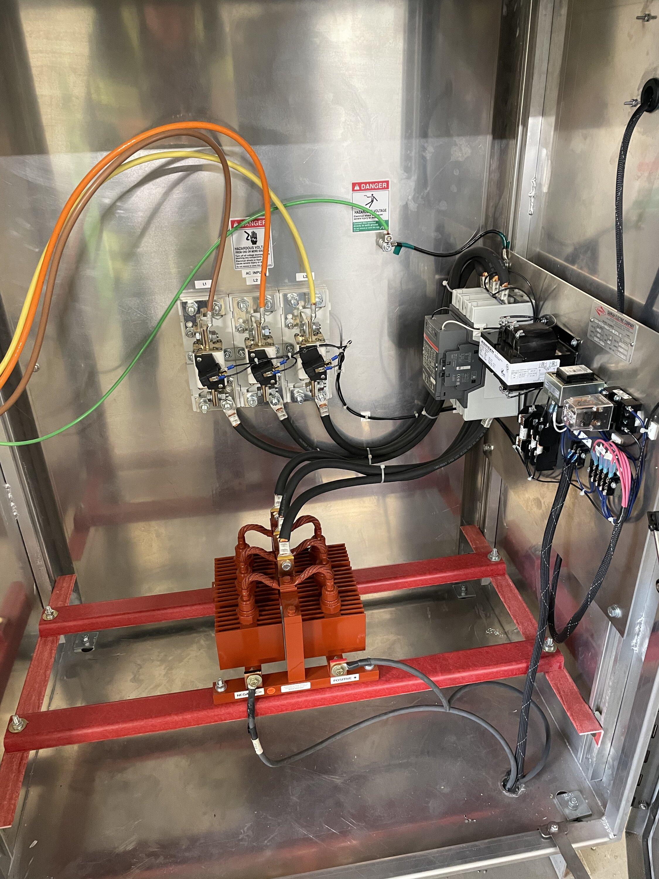

I don’t have a consumer ev so don’t know the ins and outs on charging so this is more of a question/ reply. The Streetcar I work on has a battery that it uses when it has to go “off wire” the charger is 800v dc we charge them to 80% when the Charging plus’s get hot it’s usually a bad connection or corrosion. Sometimes we can fix it I put a little dielectric grease on the connections. It was the same when I worked In commercial aviation. On the plugs do you see any deformation corrosion or black marks? How are the lines cooled just with air or with a chiller? The 1st pic is the charger/ Rectifier the 2nd is the plug we use.
