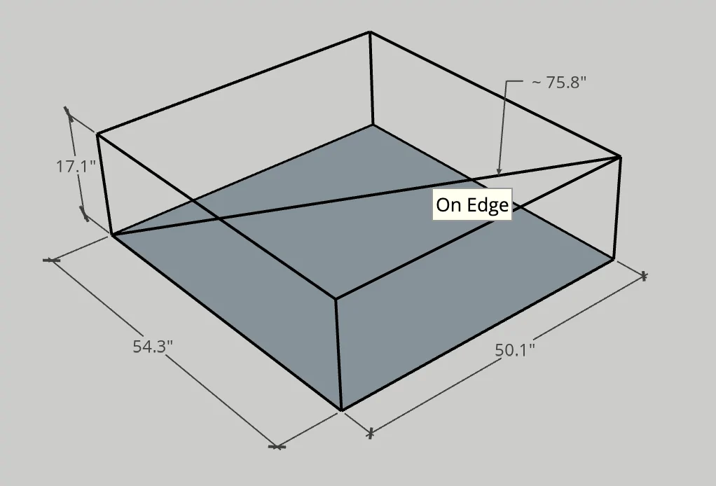

Oops. My original math was off. (When in doubt, let the computers do the math...)
Turns out the diagonal on the interior is longer than I thought -- almost 76", which is 3.4" longer than my longest skis. They're powder skis with big spoons (not perfectly straight rods), so it's still debatable that they will fit AND that the cover will close.
I guess I'm leaning ski rack or ski box over bed unless some better idea comes along.

@yizzung the bed is ~74” diagonally. That’s 188cm.
185s would fit Diagonally, on edge and, if in a bag, tilted up slightly.
ive got too much time, and AutoCAD ?
Haha. I just did the same exercise. I must also have too much time...

Caveat: I pulled my dimensions off some random site, not Rivian official, so accuracy not assured here. But guessing it's close enough.
I used rivian’s own dimensions on the R1T webpage. 54”L x 51.1W x17”D(tonneau closed)

Clearly Rivian needs to deliver an R1T to my house this week so I can solve this riddle. While it's here at the house I suppose I should try driving it up into the mountains just to be sure the skis don't rattle around too much while in transit.
I concur.
ps make a rectangular solid that is the same size as your skis, put it on that diagonal line. Bet it’ll fit.

Was doing some math on truck bed dimensions to determine whether or not I'd need roof ski racks and it seems like I definitely will. The bed is reported to only be 54 inches long with the tailgate up. My longest powder skis are 184cm (~72 inches). Even on the diagonal (also accounting for the height of the bed with the cover closed), my skis won't fit in the bed--about 10 inches too long.

Since skiing is one of my important winter use cases..I may be in luck stashing my Moment Deathwish 184’s diagonally in the bed. Tip to tip I measured them today at 71.75” straight line.
I spoke with CS today and a nice lady replied with..
“using the Pythagorean theory, I can provide a rough estimate that the diagonal length of the truck bed is 73.8". This is based on using the width of the truck bed at 1277 mm (wheelhouse width at the floor) and the length at 1371 mm (length with the tailgate up) so the diagonal/hypotenuse is 1873.6 mm (73.8") - diagonal length inside the bed.”
So..thus far it looks doable for our daily local mountain trip. For longer overnight trips we use a Thule box, so I’ll see how that fits over the top of the truck bed.
