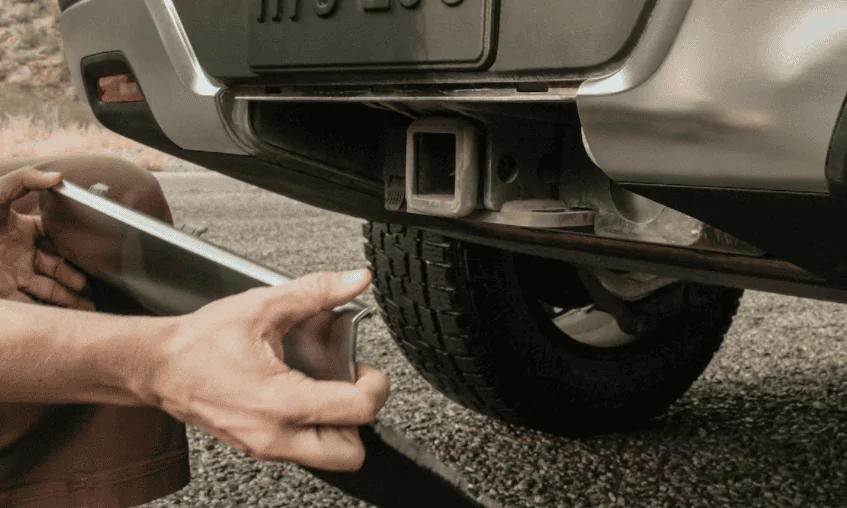

its a round pin so should be able to do trailer brakes as well as the lights. I would assume they would match the trucks tail lights on weather they come on at regen or not.

I haven't seen any info on how it's actually going to work with the Rivian's Regen system. If Regen is strong enough to slow the vehicle and a loaded trailer without using the trailer brakes, you might not want it to act that way if you are on something other than clean dry pavement. But using the trailer friction brakes will mean reducing your range, since you aren't recuperating as much energy from stopping.
From a physical standpoint, they have said there is an integrated trailer brake controller and the Rivian has the standard 7-pin connector that's needed to control trailer brakes.
