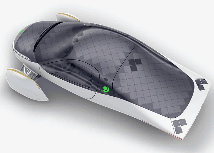

We have a pair of Apreras ‘ordered’
We opted for the lowest range since we don’t plan to take those afar like the R1T.
Their 1000mile option adds huge weight ( diminishing range return and performance) and huge $$
One will stay up north one in FL - where there’s more sun.
They grab 40m a day due to their weight and aero shape
A roof full
Of panels on the R1T will net a dribble by comparison
We’re also going to avoid the R1T 400mi pak - again extra weight, diminishing range return, and we like navigating stops and stations like we now do with a bolt and Kona ev.
We’ve hyper’d 300 on those that are only rated 259 max.
