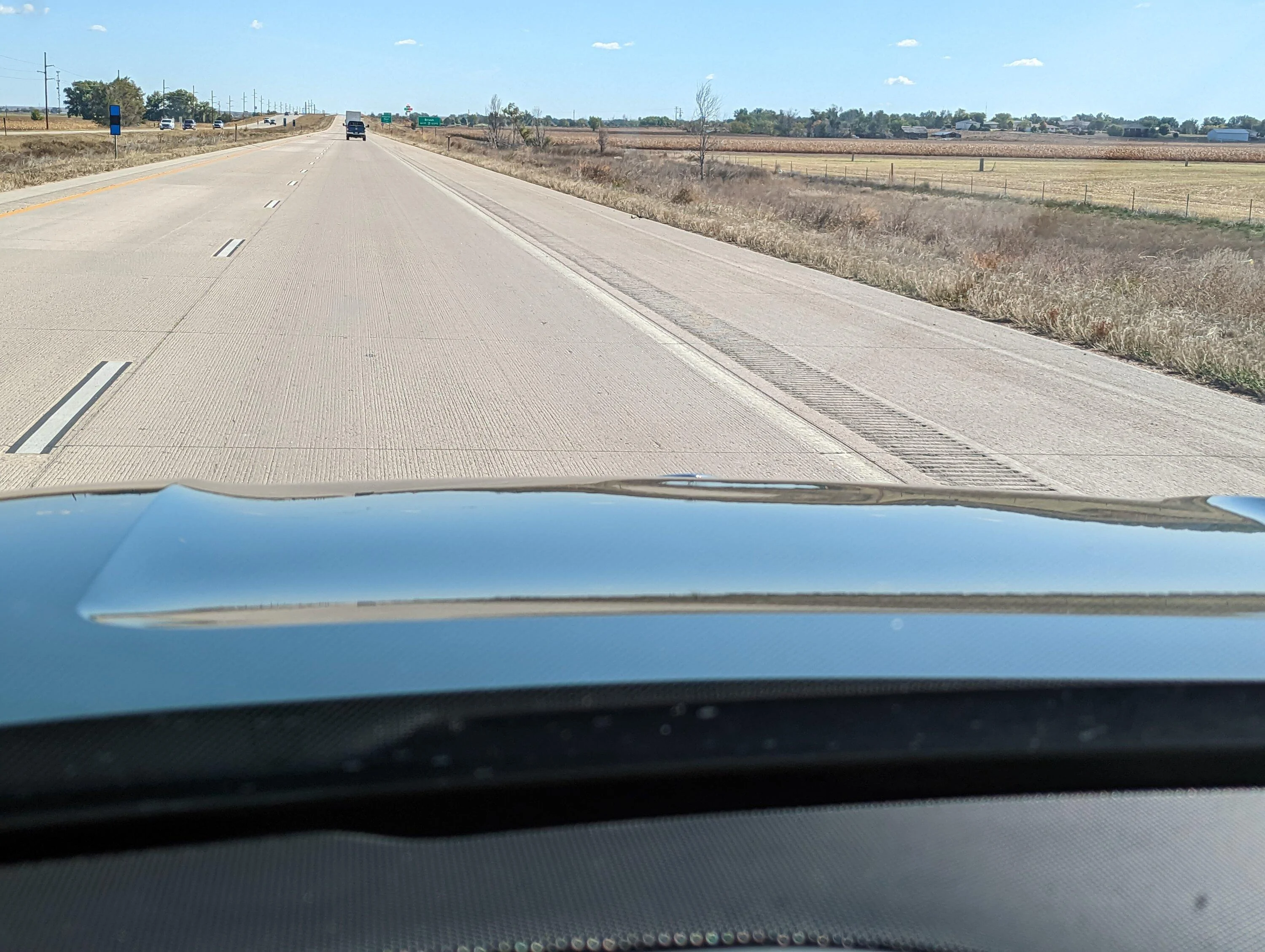

Had the flutter since owning it and didn't think much of it. Now it jus turned into a permanent indent. Thinking temp changes from driving from warm garage through winter storm temps on the freeway caused the flutter to become a permanent indent/maybe? Dunno but service center seems to be blowing me off, possible they think a large orb landed on my hood. Anyone had the bowl indent stay put and anyone get it successfully addressed?

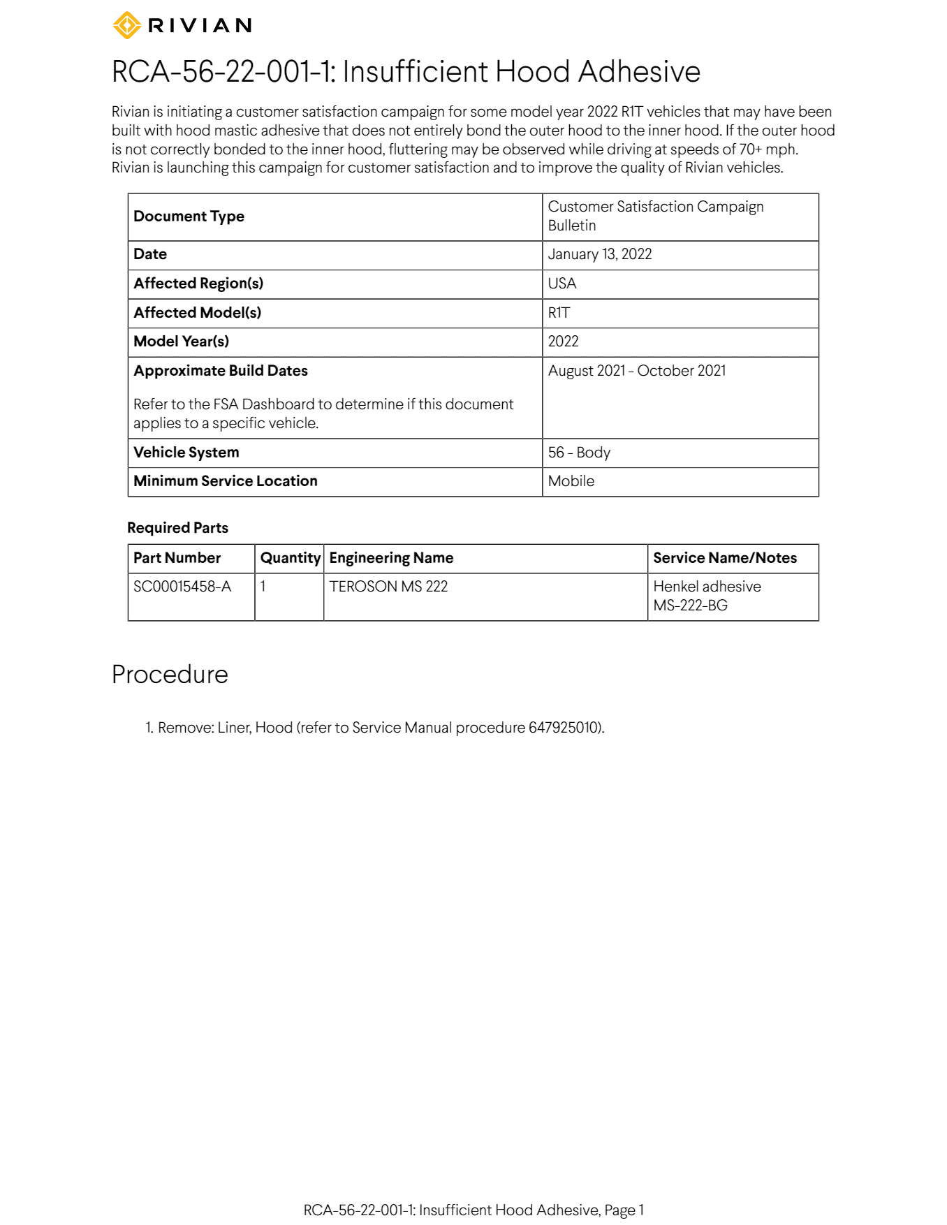

The service center was able to add some additional adhesive and it fixed my hood flutter. Still no flutter after a couple of years.
