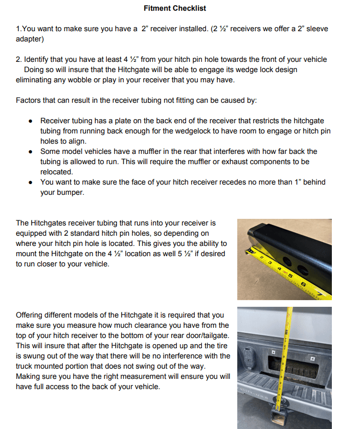

Any R1S (or potentially R1T) owners purchased a hitch-mounted spare tire carrier yet? If so, any recommendations?
Also, any existing R1S owners willing to measure the hitch for me to see if there's at least 4 and 1/2 inches from the hitch pin hole towards the front of the vehicle?
I should be able to do so on my own in a couple weeks, if my scheduled delivery date is not missed.
UPDATE: Wilco says the recessed nature of the hitch means their product will not work on a Rivian.
So, I'm now considering this one: https://www.rigdsupply.com/products/rigd-ultraswing-multi-fit-spare-tire-hitch-carrier

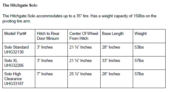

I was considering a version (standard or high clearance) of this: https://wilcooffroad.com/products/hitchgate-solo , which requires a Class III receiver.
I reached out to Wilco and asked for their thoughts. They sent me the attached Fitment Checklist.
Rivian's website says the S is a Class V receiver https://rivian.com/support/article/what-type-of-tow-hitch-do-rivian-vehicles-come-with
Whereas the Owner's Guide says it's a Class IV https://rivian.com/support/article/r1s-owners-guide
Difference in Classes seems to relate to tongue weight and trailer weight, so may not matter for my use case.

It's way more than 1" behind the bumper.

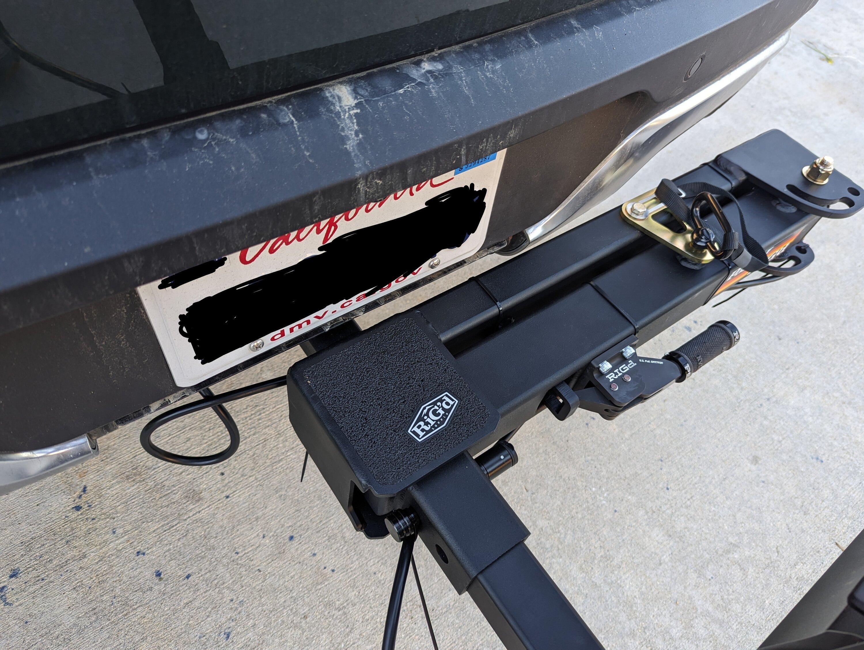

It's not quite the same thing, but the Rigd rambleswing fits the Rivian. I'm pretty sure it has the same dimensions as the ultraswing, but one should probably double check that before buying anything!

@Mcscoots, how long of an extension does RambleSwing add? I’m wondering if I can drop the tailgate with 1up rack attached.

I almost bought one, too, but they said my bike rack and 2 e-bikes exceed the 125 lb weight limit on their additional hitch. I’m waiting for Wilco Off-road to get back to me now.
1) Full size Rivian 20" spare wheel and tire ~86 lbs +
2) 1UpUSA Super Duty Double bike rack weight ~50 lbs +
3) e-bike weight of ~65 lbs x2
= grand total of 266 lbs.
