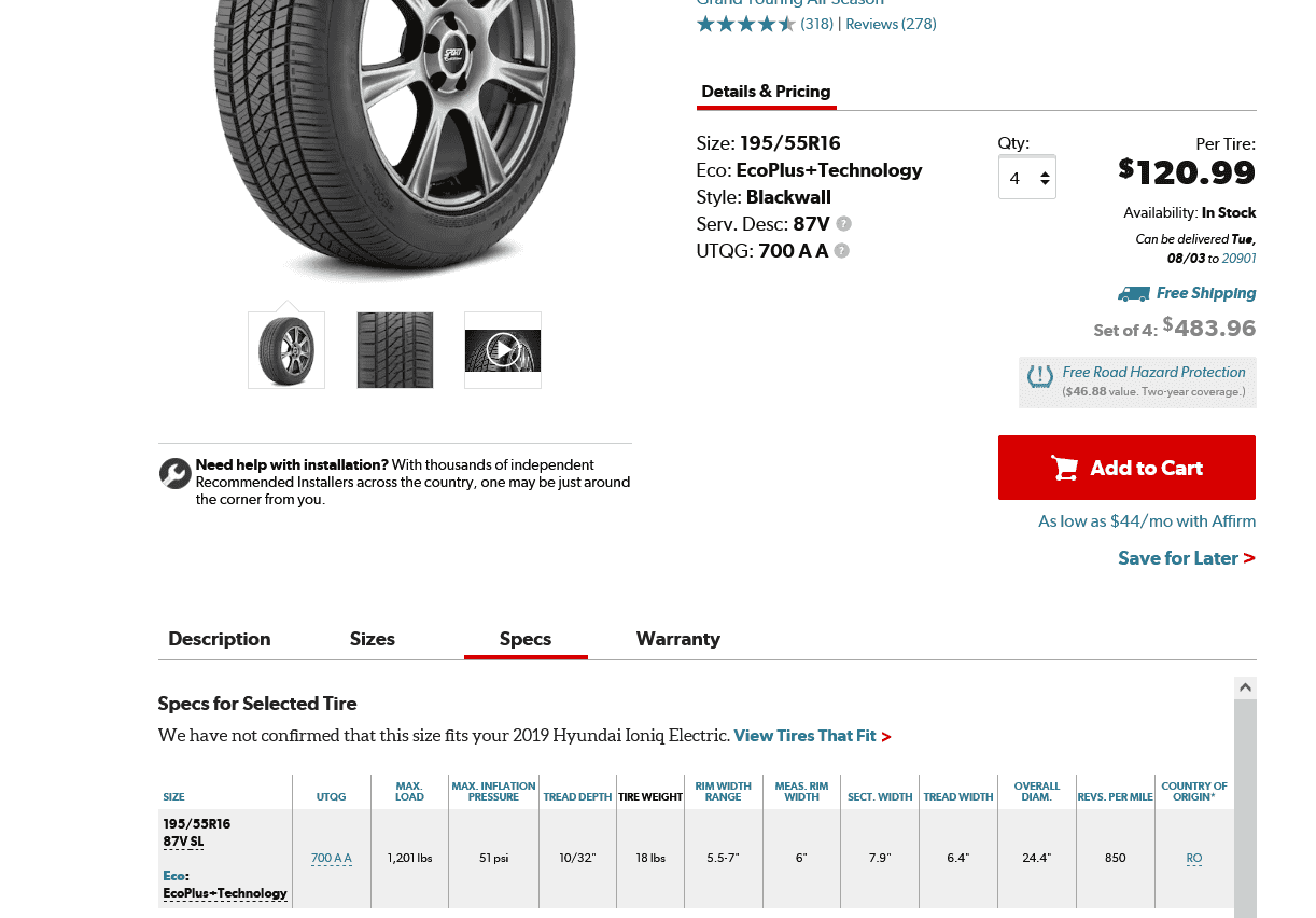

So the 195 option yes is technically off by a small factor (2%) the speed isn't going to be too much different (1.8mph at max speed).
Rivian R1T R1S Help Me Decide EV Tires 1627826129539
The pure contacts would be a great choice I just worry that the extra 2lbs of rotational mass per wheel will effect range something the 28kwh 2019 hyundai already lacks a little. We will be using it for road trips so trying to get as much of the car/range as possible. So by doing 195's I think its a great compromise for range/rotational mass & traction at the same time.
Was just wondering if anyone has any experience in doing so. Note looks like the Pure Contacts in a 195 section are 1lb less per wheel, decent traction and eco tech.

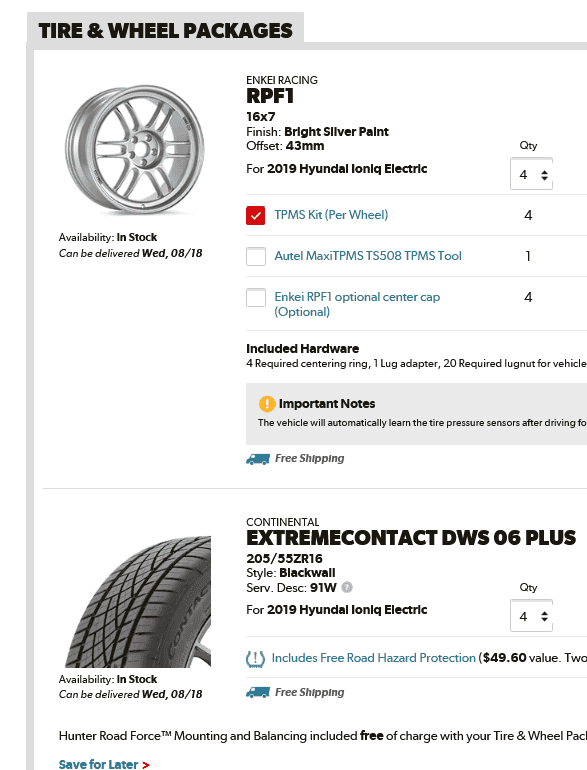

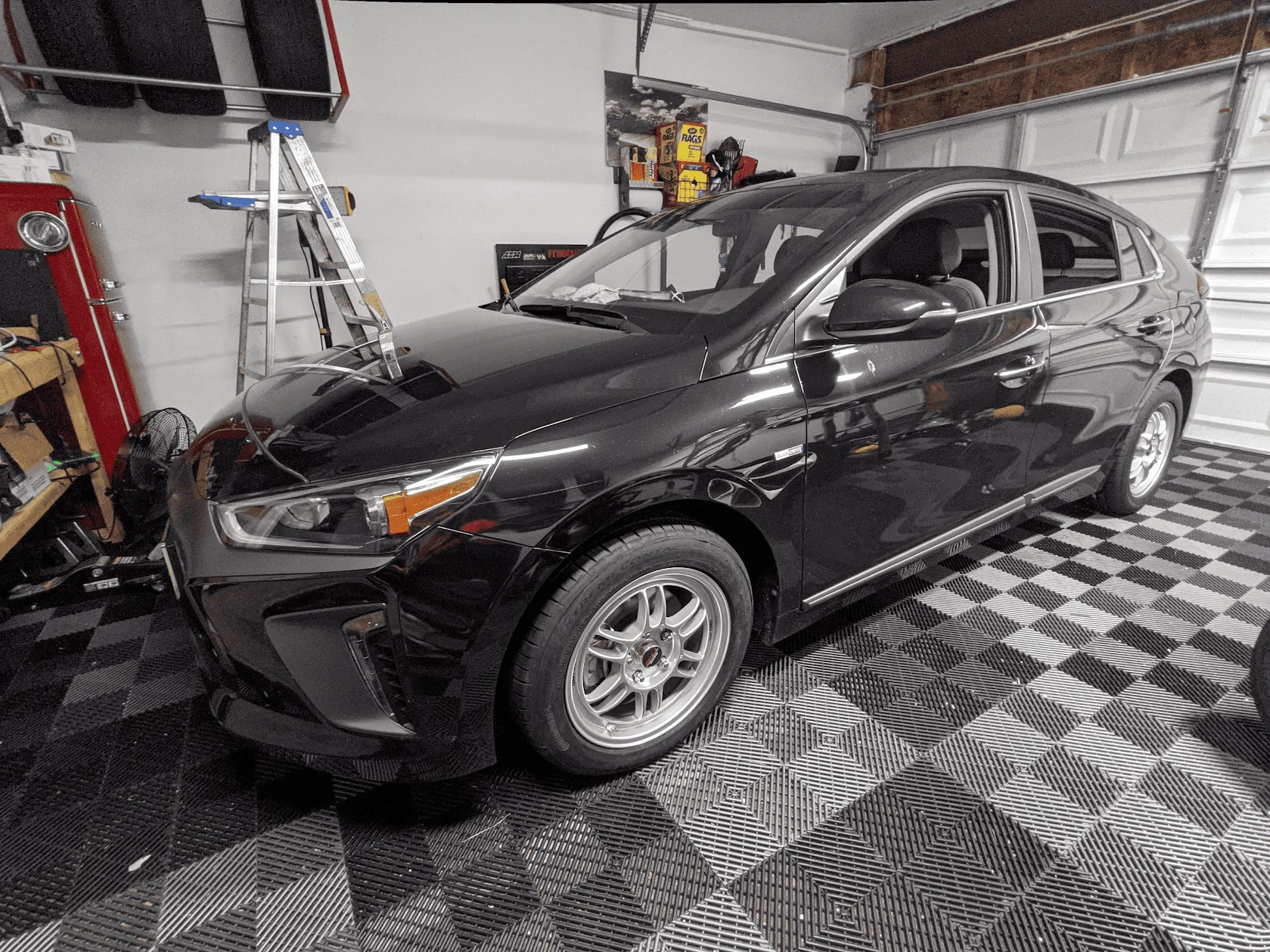

Ended up doing the following, 10.1lbs per corner saved in rotational mass at the sacrifice of aero benefits. Also kept stock width for better grip and the original tire I wanted. Curious to see any range extension and hoping not any reduction.

SO I ordered wheels and tires from Tirerack, all pretty standard process, select your car, choose your setup, buy it. Should fit nice and dandy. Installing them is also as easy as changing a tire, Ive been working with cars for 20 years so Its all pretty easy stuff.
I get the wheels and tires installed and now the wheels are scraping (not tires, the actual metal to metal) on a rear control arm.
I am having to go thru hoops trying to return my setup. The fitment team needs to check to see if I was sent the wrong wheels and so I may have to mount/dismount and swap out wheels/tires because they messed up.
Anywhose sometimes taking a L, keeping it simple is less headache LOL.
Result did confirm at least 10lbs per corner reduced.
