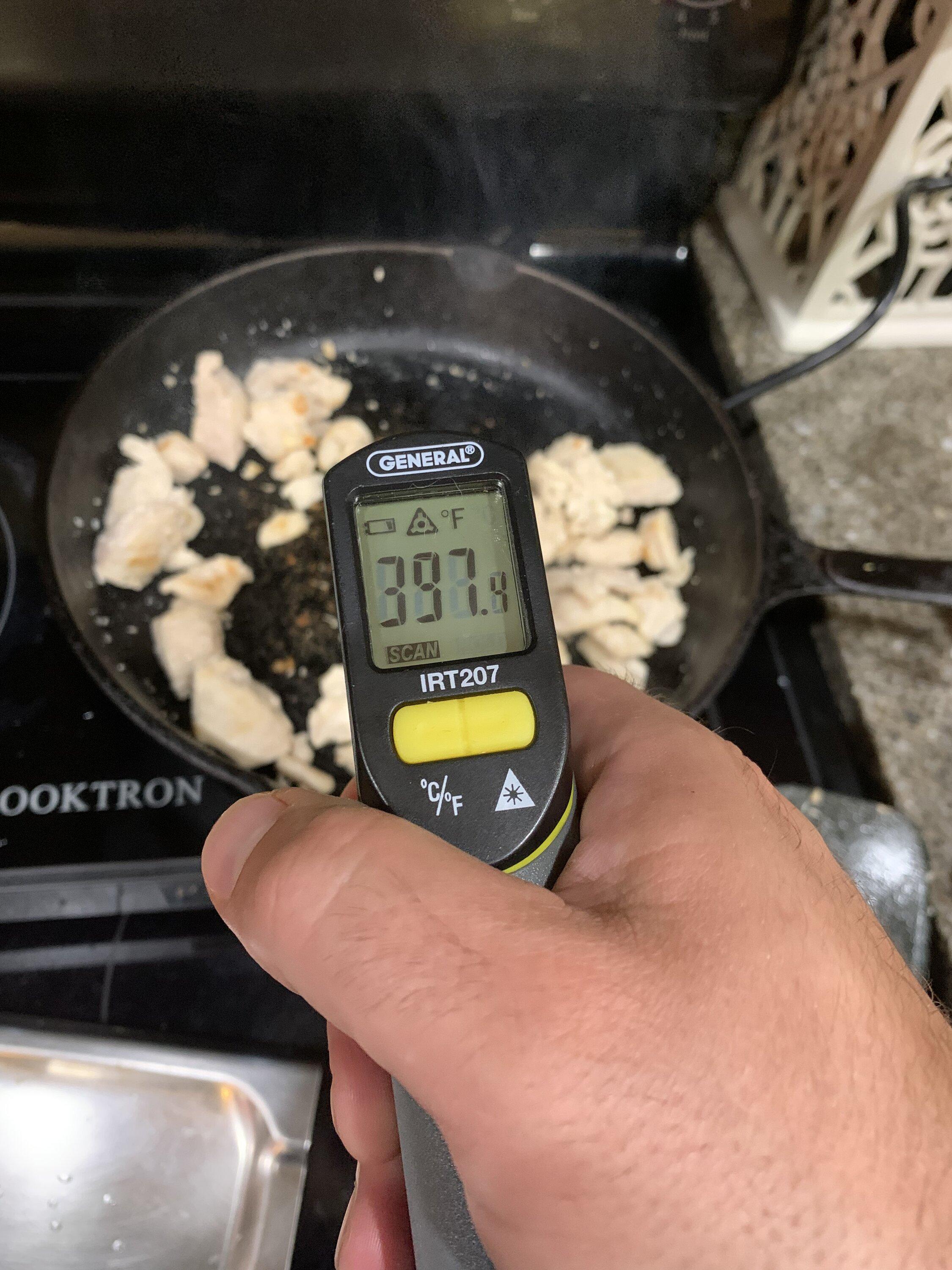

Update:
I bought the Cooktron and tried it out at home last night. Here's the good, bad & nuances I found in one night of use. In no particular order.
  • I used my home energy monitor to see that max output is closer to 1,700W instead of 1,800W. We'll see how the truck manages this.
  • I hadn't thought through the need to still pack a skillet since it comes with the griddle. I obviously needed a pot and a skittle at the same time to cook chicken and pasta. I hadn't really thought this through.
  • Part of the way it manages energy is by capping the output if you're using both burners at the same time. Each burner has a heat setting of 0-9, but the combination of both burners will never get above a total of 14. You'll want to use a skillet on a single burner if you want the highest heat output. Having two burners is better than one, but you need to be prepared that you can't use both at max power at the same time.
  • The hottest my single skillet got on level 9 was 400 degrees. This is plenty for cooking most anything unless you're trying to sear a steak at 500 degrees. I expect this is a fundamental physics limitation of what you can get out of 1,700W.
  • It's a good size for camping. Not to big; not to small. It is designed as an indoor appliance though, so it shouldn't be treated like a rugged piece of camping gear.
  • This was my first time cooking with induction. I like it, but it will take getting used to. My stainless steel pot warmed up so fast I almost burned something. The cast iron skillet took a little longer to warm up, but kept heat better. My point of comparison is an old electric stove, so the ability to rapidly change temprature is a novelty to me. I might have to get a real induction stove for the house.
  • Rivian R1T R1S Help me choose my new cook system IMG_9383
