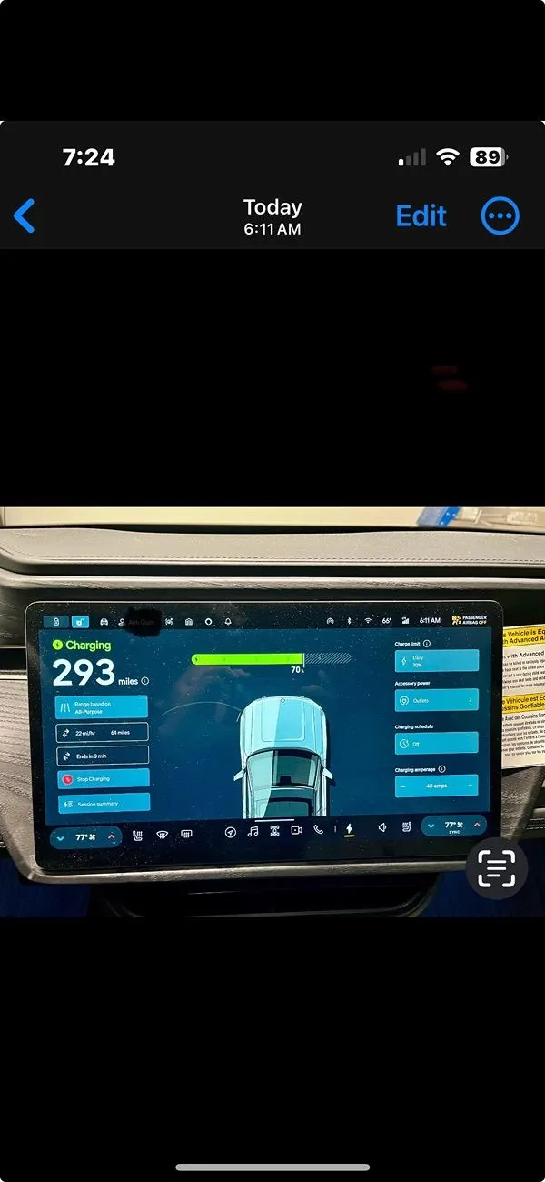

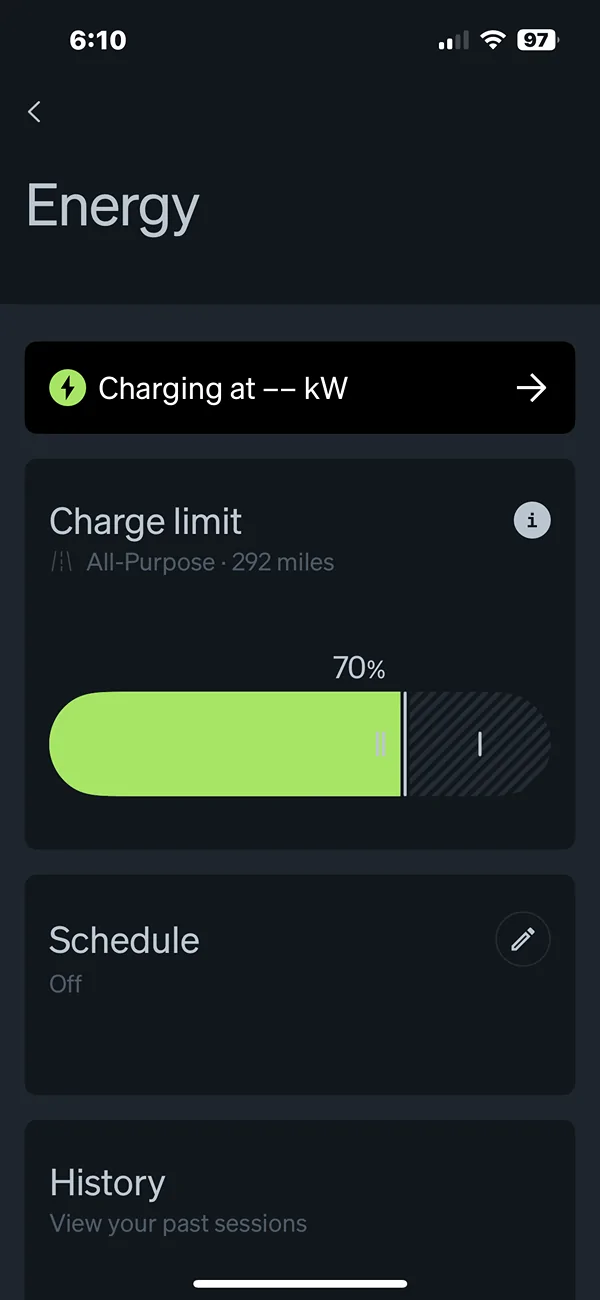

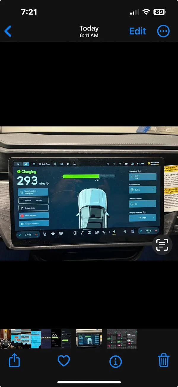

Since the Costumes went away I've run into some issues hopefully the forum members can help with. I've posted before that my R1S G2 wakes up every night from about 9PM till 5 AM about every hour for about 15 minutes. Rear lights go on, then the interior lights and infotainment screen come on. I'm not near the R1 (proximity sensing is on though). I see this on my security camera. It's parked inside the house.
Today, the I went to unplug the R1, to find that it had hit the set limit of 70% SOC, yet the interior screen said it was still charging? The app said it was still charging, but at 0 KW. The Tesla wall charger showed it was sending juice(green light bar running) and the charging port was green. Is this possibly negatively affecting the battery, a software issue? Any one have these issues, or have thoughts on a solution. Not sure if I should bring this up to SC level or just live with

The charging thing happens all the time so I think that’s normal. It happens when you are close or at the charging limit.
