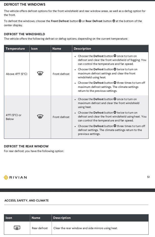

See below from Owner's Manual. What exactly is your concern? Whether you can or the impact on range?
