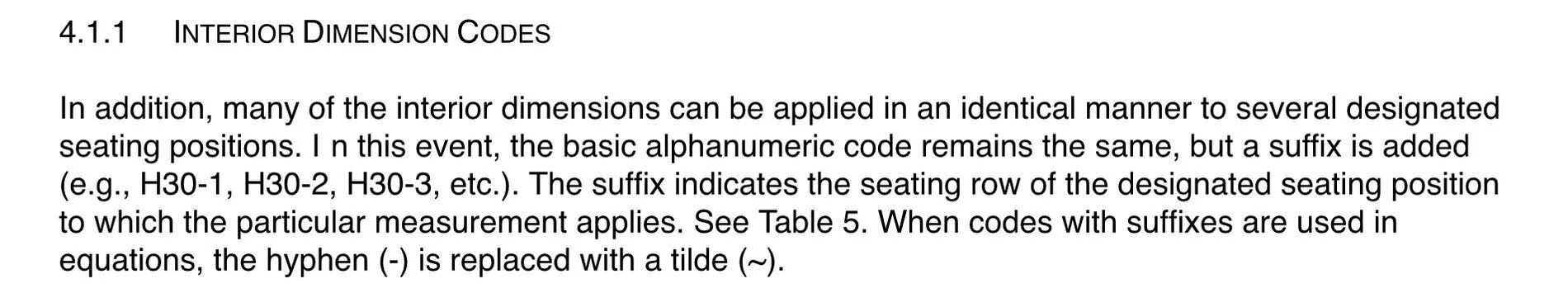

Based upon this post R1S Interior Dimensions it doesn't look like a full sheet of ply will fit inside, at least flat on the floor.
The W201 measurement (Cargo Width-Wheelhouse— The minimum dimension measured laterally between the trimmed wheel housings at floor level. For any vehicle not trimmed, measure the sheet metal) is 1151mm (45in) and 1084mm (42in) for the 5 and 7 seater respectively.
The 52" dimension you quote may line up with W3-3 (1298mm/51.1in). Unfortunately, I don't see W3-3 called out in the version of the SAE spec I found so don't know what that is actually measuring (could be elbow or shoulder room).
Another potential limiting factor would be the dimensions of the rear opening.
Disclaimer - I couldn't find the SAE Motor Vehicle Dimensions J1100_200911 document that defines what the measurements are in the public domain, but did find the 2001 version. Hopefully there isn't a difference in the dimension call outs.
It looks to me like W3 is "shoulder room", so W3-2 is the 2nd row shoulder room, and W3-3 is the third row shoulder room.
Aroohoo
Sep 8, 2021
337
471
I initially thought the same, but going by the 2001 spec, W4 is 2nd row shoulder room.
It very well could be that these were re-designated in the current spec.
I found a solid answer. Our guts were right. Here’s the 2005 manual:
