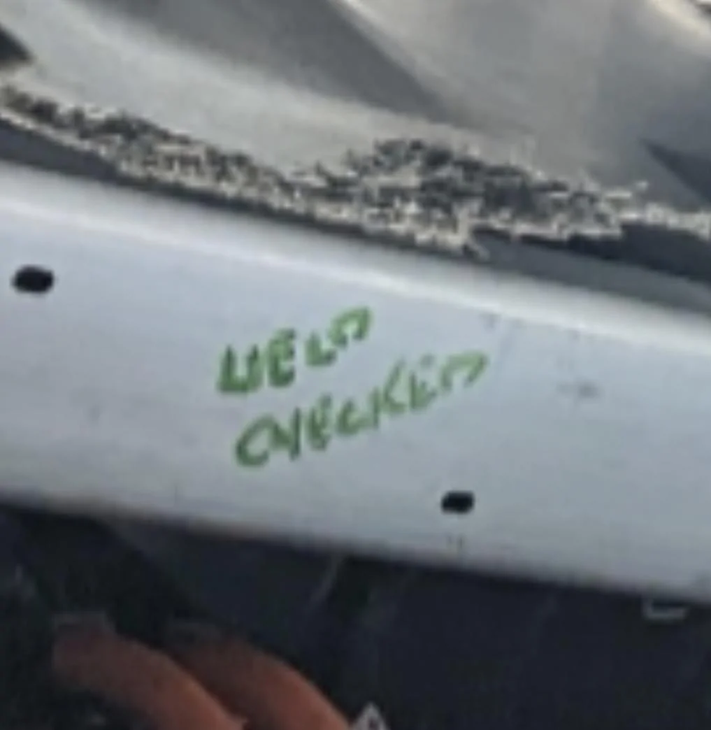

Driving on the highway and heard a loud bang. Had no idea what it was because the road was clear. But honestly thought nothing of it because this car makes a lot of random noises.
Next day I'm driving and I hear a lot of wind noise coming from under the truck. I pull over and take a look at the bottom of the vehicle and half of the underbody shield is ripped off. I called Rivian and they're going to call me back to tell me if it is safe to continue driving. I'm super bummed about this. I'm currently driving on the highway trying to find the cover on the side of the road. Few minor issues that I reported which haven't been resolved yet but, everything else has been great, nothing this severe.
I did see a post about somebody saying the screws were all loose and it completely slipped my mind. I didn't even check before I started driving to vehicle.
I'm assuming some wind may have gotten under the shield and just ripped it off.

the sheilding toward the end of the vehicle is the remaining peice left over correct? So the carbon fibre totally ripped in half?! Fuck!

Yes, it looks like that. I bet when it fell down it got caught in the pavement and then ripped right off.

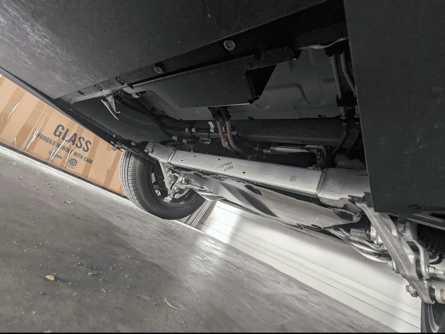

Thanks for that shot. I've been meaning to pull the cover off on mine and take some measurements.

if the screws get loose over time, wind is definitely going to get in there, which in turn loosens it more and then bam, this is what happens. and it sheared the carbon fiber right in half. just based on this pic, the screws look like they are at different depths. either it got that way while it was being sheared off or it was loose to begin with.
everyone, make sure to put this on your delivery check list: crawl under vehicle with flashlight to inspect screws. yikes
lot of empty space in there too. guess thats room for the max pack.

that seems like a design flaw. if the screws get loose over time, wind is definitely going to get in there, loosen it more and then bam, this is what happens. and it sheared the carbon fiber right in half.
I think it is manufacturing issue. These R1Ts are too new for it to be matter of time. I have a feeling too many folks drink late on Sunday night in Normal before going to the plant on Monday morning. From everything I read, it looks like it is difficult to get one that does not have something loose. It is just matter of when and how you find out about it.
Edit: on second look, if this is front of the vehicle, it is hard to imagine why it would get ripped off like that unless it got caught on something when you were backing up.
