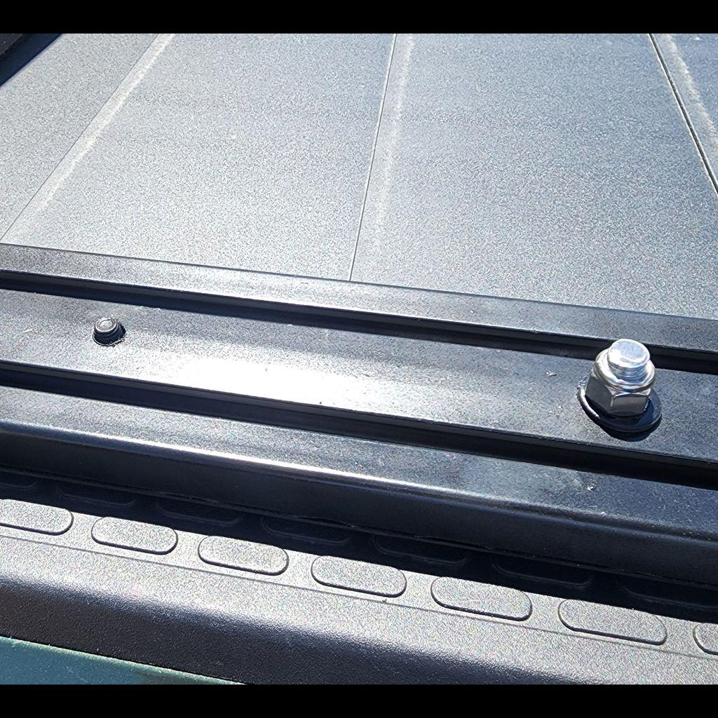

Responded to you on Instagram, but here are some pics.
Rivian R1T R1S Hairbrained Idea - T-track Mount for Bed Rack 2022-07-12 2nd iteration _164317
Rivian R1T R1S Hairbrained Idea - T-track Mount for Bed Rack 2022-07-04 gear tunnel button _112131
MotsuNabe
Mar 22, 2021
Tundra, MX-5
@kneebuster I see you have already beat me to this idea! Thanks for confirming the approach would work. Though you have now sparked my interested in Xtrusion overlands products. The T Track system is so universal, I use them everywhere in my shop. Thanks!

I am working with Xtrusion Overland on adapting my solution. They intend to clean up the "feet" where the uprights attach to the rails I fabbed up. I'm also talking to them about a 10% discount for the Rivian community. Give me a couple of weeks to get everything in place.

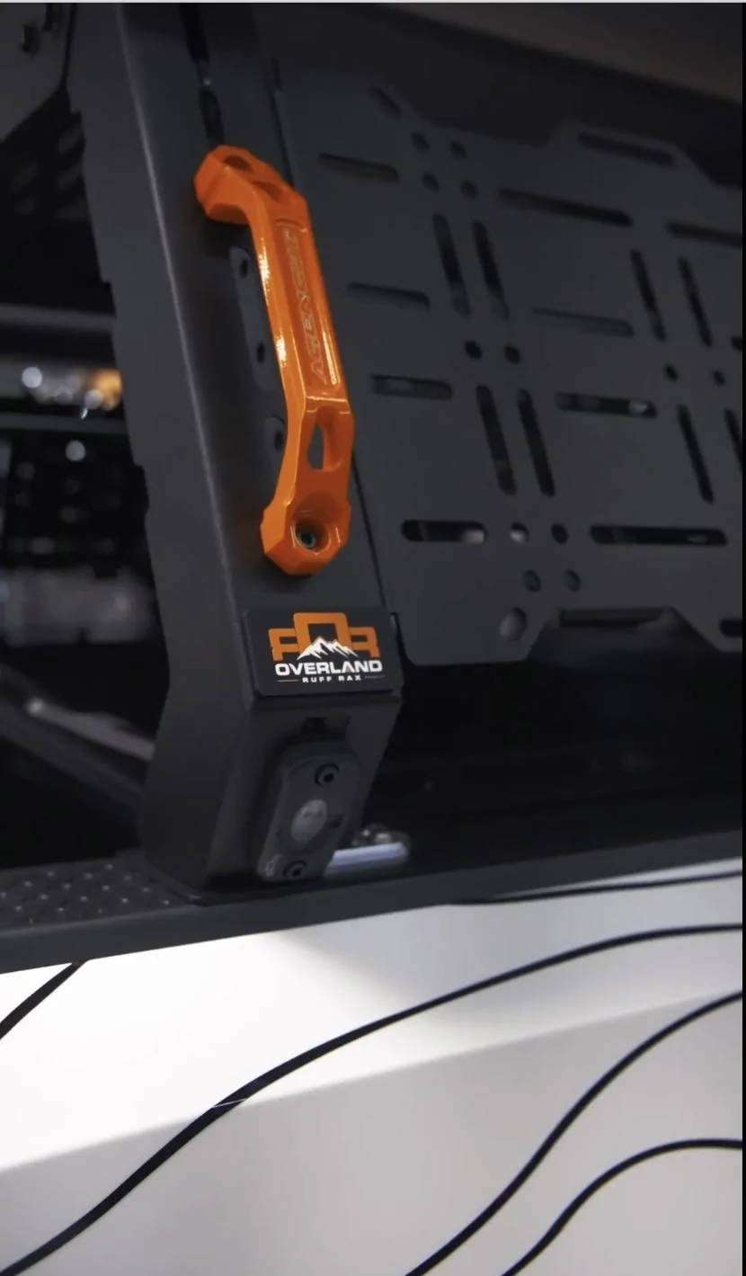

Also, some screenshots from Instagram of their method of attachment (no rails on the top of the bed, looks like they used the OEM connectors for the Rivian crossbar
[/QUOTE]
On the SEMA video they did say the were using the Rivian mounting portals, somehow. Very expensive racks, BTW.
