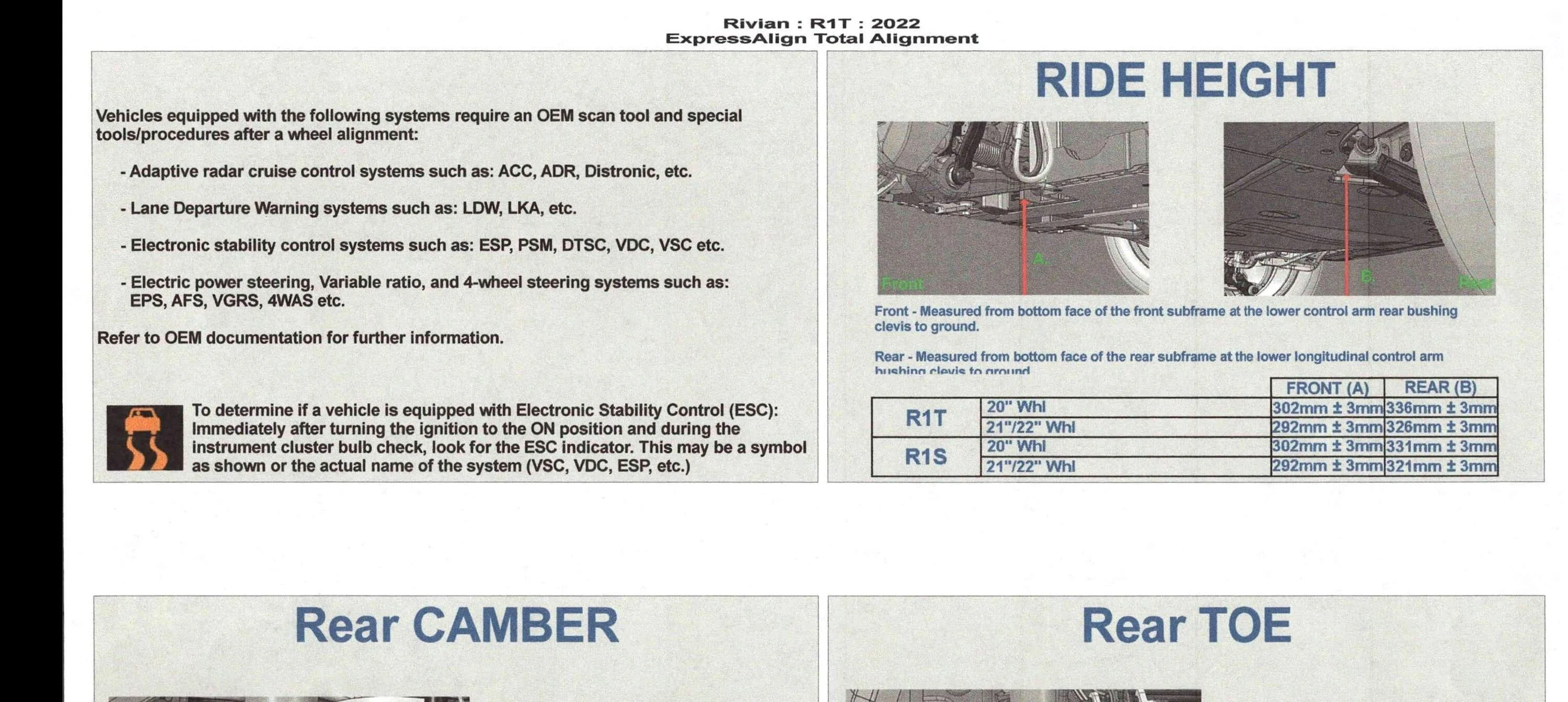

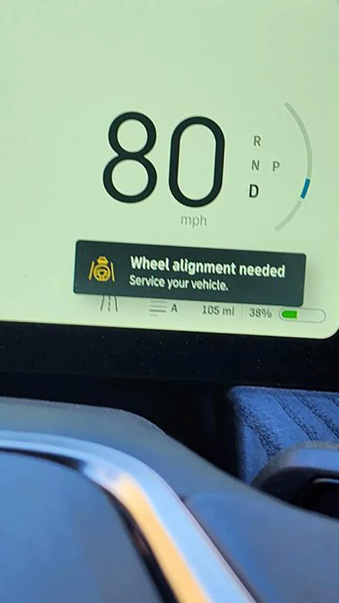

Went a bit overzelaous off-roading and messed up alignment. Even though I have a service appointment in about 2 weeks I wanted to get it aligned sooner as not to prematurely wear tires because it was pretty bad. Truck was showing this error message
Rivian R1T R1S Had my R1T alignment fixed at independent 3rd party alignment shop (spec sheet attached) oikeqikl
Called few shops, found one that already did an alignment on another R1T. Cost me about $200 with tax.
Spec sheet
Rivian R1T R1S Had my R1T alignment fixed at independent 3rd party alignment shop (spec sheet attached) KtynnOvl
One of the reasons it was out of alignment :D
And yes they did alignment on all 5 suspension levels. There was a guy sitting in the truck all the time and another two working suspension.

Nice! I'd actually trust a 3rd party alignment shop more than Rivian at this point in their development. Too many owners have left Rivian SC with the truck still pulling, steering wheel wobbling, etc..

Part of the alignment procedure has to be re calibrating driver+. I would make sure they do that. If they do not it can lead to the vehicle driving out of lane when driver+ on. Very dangerous situation.
I rarely if ever use D+ but I will let service center know, thanks for the info!

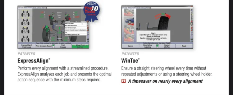

Is “ExpressAlign” the brand name of the rack/software that we should be asking 3d party shops if they use, since it seems like it’s Rivian-ready?
It’s Hunter Engineering’s alignment software.

So just a quick update. Steering wheel is dead-on but the truck is still pretty sensitive to road curvature. It still likes to "pull" to the shoulder if there's ANY slope on the road (so 99% of roads). It drives dead-on for minutes at a time without holding steering wheel on concrete highways without any curvature. I'm thinking it's due to my 20" wheels since it's always been like that.
Also Driver+ works just fine. Overall I'm very happy and in the future will be using that shop instead of waiting for months and then driving 2+ hours to the damn Brooklyn SC.
