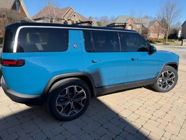

TWRAPS is the best. I smoked out my headlights and taillights with their 50%, came out amazing. It was not the easiest install, i got it i'd say 98% perfect. I agree patience is the key. A couple of times i wondered what i had got myself into but then just stayed calm and carried on. I'm hoping difficulty level of PPF on body panels is way less, either way can't wait to get started. Just need mother nature to warm it up a bit.

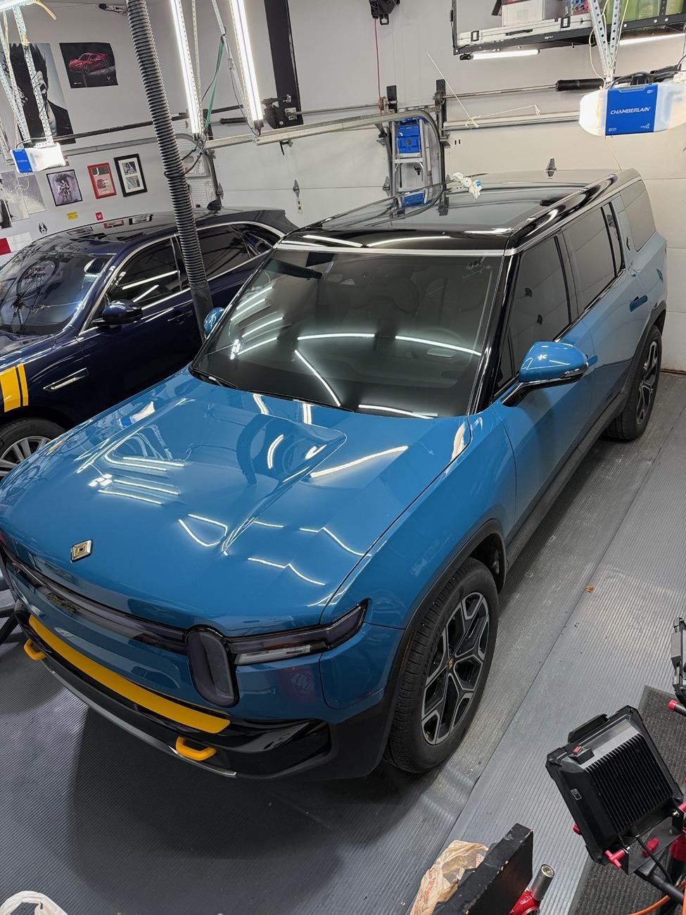

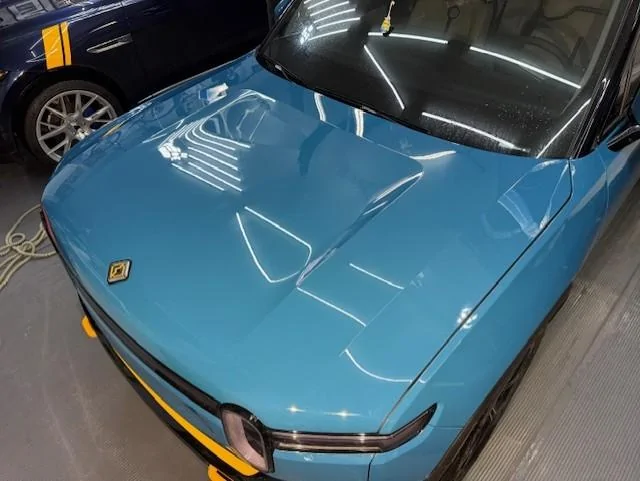

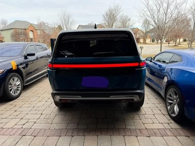

I would agree with Iliya. Patience is the key. You definitely need lots of time and a no wind space to work in. I got the entire car done, looks like glass over the surface, no trash underneath except for one small hair that I never noticed till done, but no one knows where it is. The edges although tacked down, now in spots have a visible dirt line. Not a fault of the product rather some crazy rain and snow that had Texas dust mixed in it that just penetrated on some edges, in Illinois, I’m sure others experienced this rain hail storm a couple of weeks ago. Over all 100% satisfied with the product, I’m 96% happy with my install of it. Here’s some things you will need in addition to what is recommended. A helper, can’t transfer the panels safely without one. A really good pump sprayer, you can’t do this with a 99 cent spray bottle. Some good squeegee cards, but not the professional ones. The pro ones are too sharp and you risk creasing the PPF and then you are trying to fix using heat. Speaking of heat, you don’t really need it, a good 70% alcohol tack solution is perfect, again in a good spray bottle. My routine was start at night, wash a panel, prep with clay barring and then polish. Use a panel prep spray and then finally rinse with hot water, then spray with soap solution, nit pick everything for a couple of hours after getting PPF installed on said panel, all at night. Then leave the car in garage until morning, come out and push down edges with the heat gun and pop any bubble with a diabetic needle. All in all I’d say I spent between 10-15 hours doing this, and a lot of water. Totally worth doing and an amazing product. Thanks for all the help Iliya.
I think one of the best outcomes of doing this is Rivian delivered the R1S to me with lots of scratches and paint blemishes that they claimed they could not get out. The polishing I did removed all of that. If any one from Rivian reads these posts, please just go ahead and hire me as your vehicle detailer going forward, my proof I’m better is sitting in my garage.

Thank you so much! This looks amazing!!!

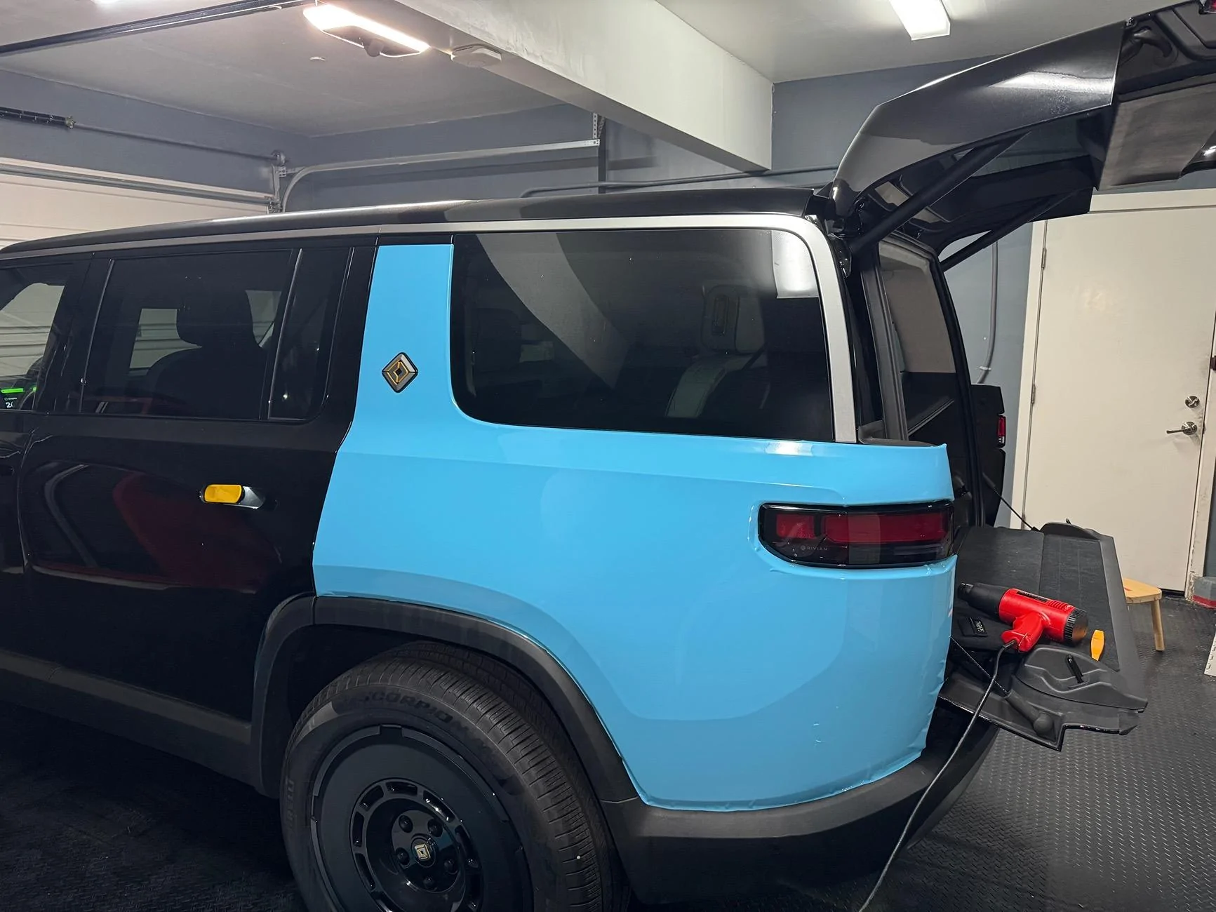

Oh and for the record for other people reading this thread - I AM working on a kit that will wrap around the edges. When that's finalized I will offer stealth PPF and color PPF (would require de-badging though). Here's preview - tackling the quarter panel. The aim is to achieve easy-ish installation with 0 disassembly except the removal of badges which is a must as their position is inconsistent.
