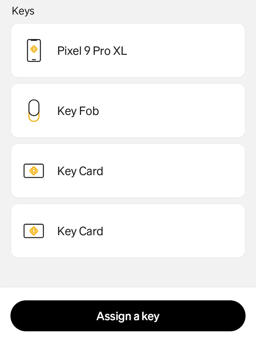

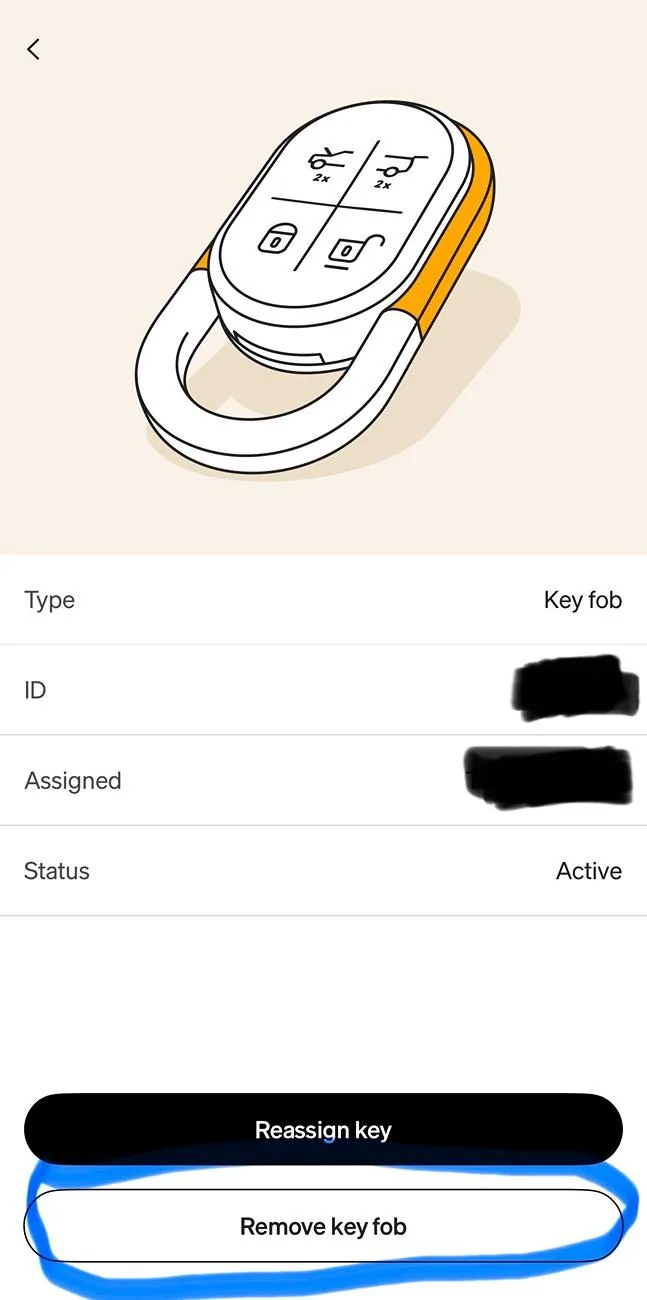

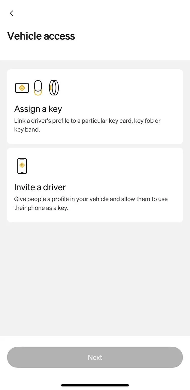

I just discovered a couple of things, you can now unpair key FOB from your account. Also, it appears the key band (bracelet) may become available for purchase as well.
The option to "remove" was not available to me until I was successful in getting the fob to work.
To remove FOB is available on my app though the FOB still doesn’t appear on my vehicle’s infotainment display. It’s not paired to the S?
