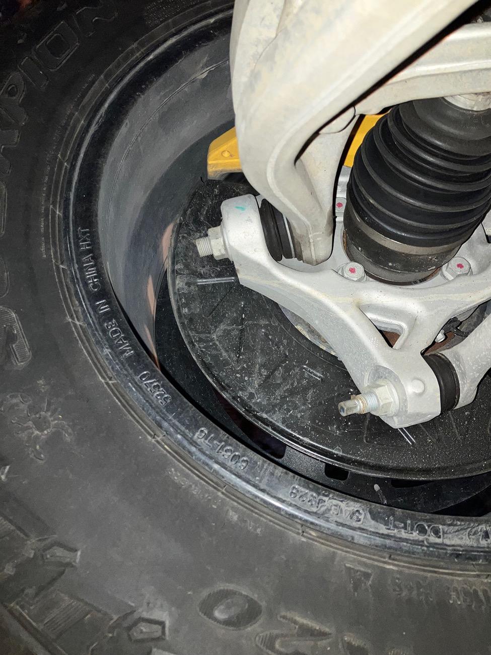

I have yet to drive a Gen 2, however many, but not all, seem to agree that the Gen 2 R1S has improved suspension/ride feel as compared to the Gen 1 R1S. I have a Gen 1 (Aug 2023/vin 18xxx) and received it after all the software suspension updates so I don’t know what the pre-update suspension felt like. Before I purchased the vehicle, I had read the complaints about Gen 1 suspension so I was prepared for the worst but was pleasantly surprised to find that it actually drove quite nicely. Sure, a bit truck like and somewhat boaty, but not horrible. Over time I have noticed some porpoising over rhythmic bumps and head toss/stomach drops over bumpy, pothole ridden roads. Although, I generally don’t notice these things unless I’m myopically focused on identifying suspension issues. I asked my family and they haven’t noticed a thing, even in the back seats. I have found that I prefer the moderate setting for driving around town as soft seems to have a little too much bounce.
So, I started to wonder if some of the mechanical suspension updates implemented in Gen 2 were already finding their way into late Gen 1 builds. I took a photo of the knuckle on my R1S and it’s almost, but not completely identical to what you find on a Gen 2.
Rivian R1T R1S Gen 1 Rolling Suspension changes IMG_0606
has the much sleeker, opened up design which differs from the original, much heavier Gen 1 knuckle shown in this Munro vid

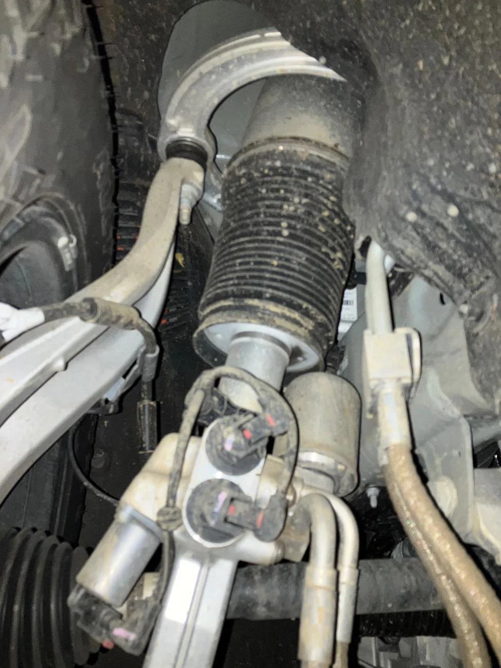

Harder to say with regards to the dampers, I can’t visually identify the difference between Gen 1 vs Gen 2. Here’s what mine looks like
Rivian R1T R1S Gen 1 Rolling Suspension changes IMG_0601
If anyone has more insight into the rolling suspension changes for Gen 1 vehicles let me know. Many people had warranty replaced dampers due to excessive noise, so there already was some sort of improved Gen 1 suspension available in later years.

After looking around the web a bit, it’s clear that the damper on my car is the original Monroe unit
https://www.ebay.com/itm/395167289425
it seems that Rivian is still using Monroe dampers, but they’ve been modified for the R1S, at least for the rear. Spring rates also changed on Gen 2.

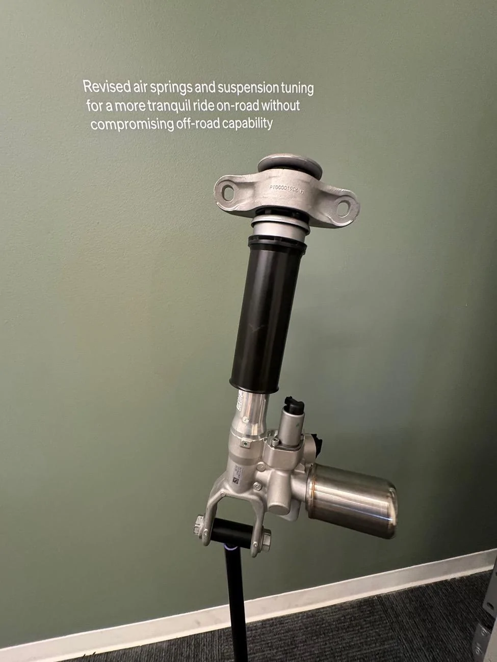

Here’s the new damper
Rivian R1T R1S Gen 1 Rolling Suspension changes IMG_3356
Changes to suspension explained by Rivian here:
