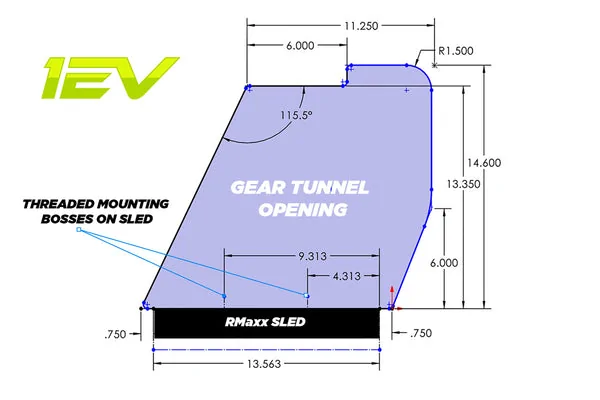

Thanks for this thread, lots of good information. I saw this question was asked, but other than the dimensional diagram shown for the RMAX Sled, I did not see any other post related to the clearance height from the various gear sleds to the top of the gear tunnel or bottom of the gear tunnel latch. This might be important to differentiate when considering these alternatives.
BoxGods: ?
Interrobang: 15" from top of sled/slide to gear tunnel latch.
EV Sportline: 13.25" from top of sled/slide to gear tunnel latch
EVBase: ?
Range Industries: ?
Thunderbolt Adventure Supply: 14.25" from top of sled/slide to gear tunnel latch
Electrified Overland: ?
BoxGods: ?
EVBase: ?
Range Industries: ?
Thunderbolt Adventure Supply: ?
