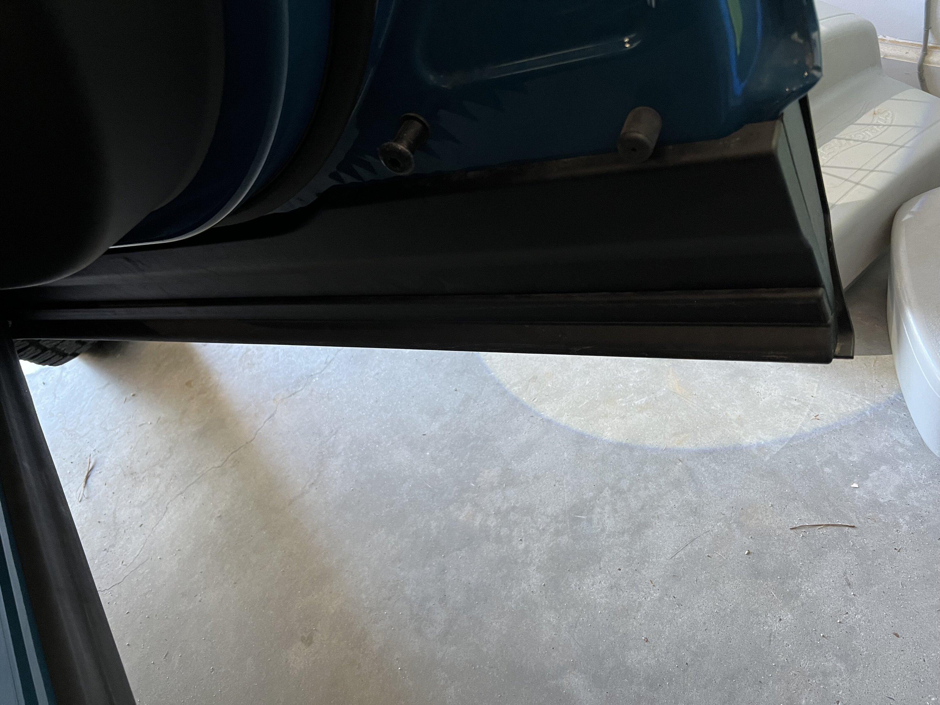

They forgot to pull the plugs in the door drains for mine. I had water sloshing inside my doors.
It rained in AZ yesterday and today. I can hear water sloshing when accelerating and turning. I think its in the doors, though I cannot find any drain holes/plugs. Where are these located at? Anyone have a picture of what they look like?
We had massive downpour here Tuesday. I had an appointment scheduled for today and noticed a water sloshing sound on the drive down. They looked into it and think it is some in the passenger door - they are draining and remediating right now actually. Mentioned having to take door apart and hadn’t heard of other issues after fixed.
they didn’t hear on a short drive but were willing to go with me for another drive and heard it.
goad I already had it on the books - hopefully no other water later
Will update if I hear anything different when complete (soon)

Update to my post above: drain was clogged. They drained Tom he water and drilled a larger drain hole.
Can you share a picture of the where the drain is?

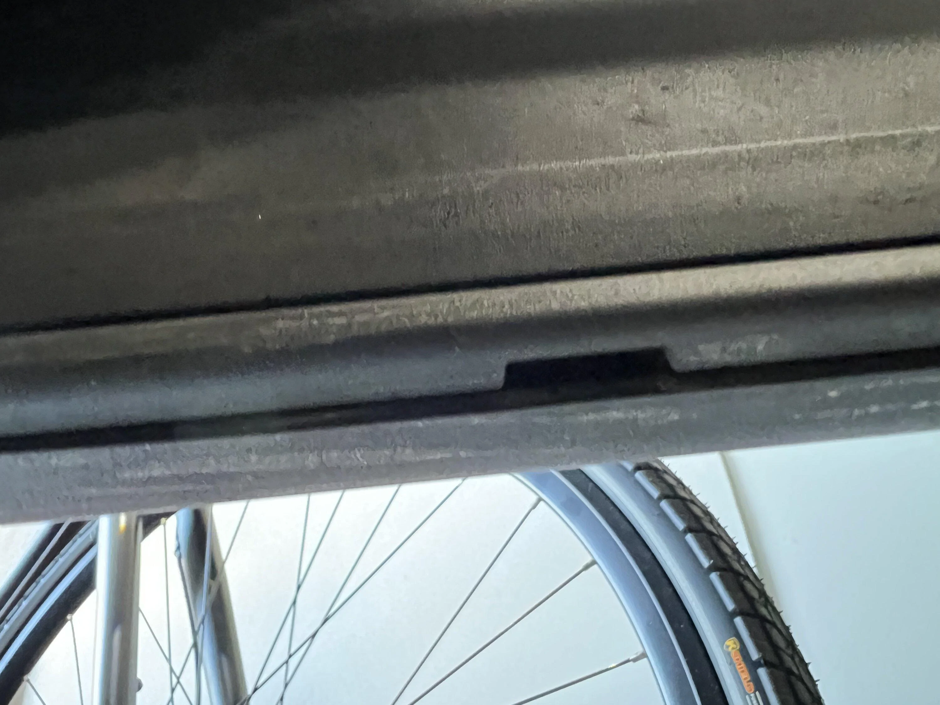

I believe it is contained within the black plastic that wraps the bottom. They had to replace some clips according to the work order and I think the plastic /may/ be off a bit.
There are 2-3 holes within the very bottom of that black plastic.
The plastic holes look to be the same size on both front doors - so again, I think that there is another one that is hidden that can't see
