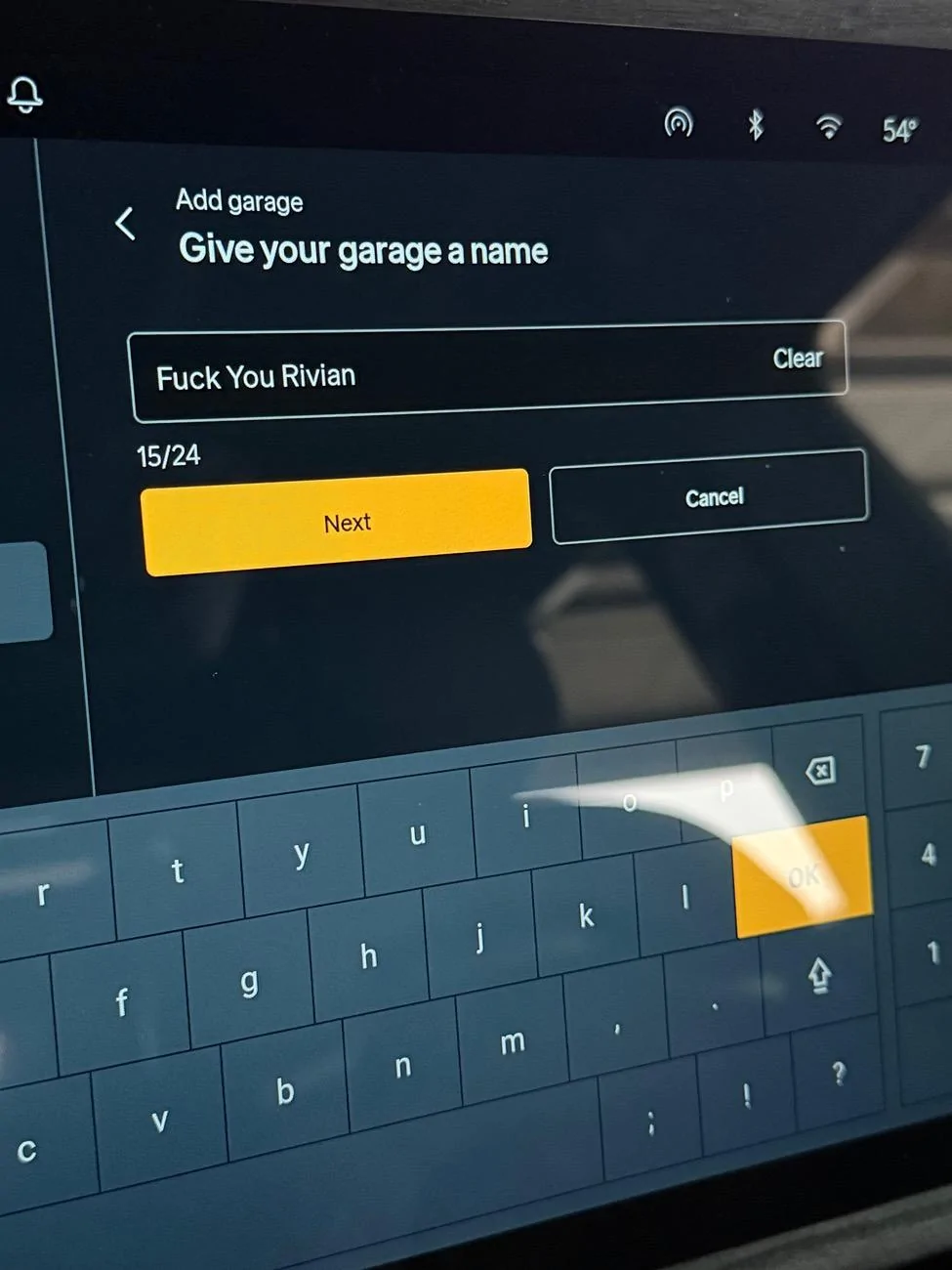

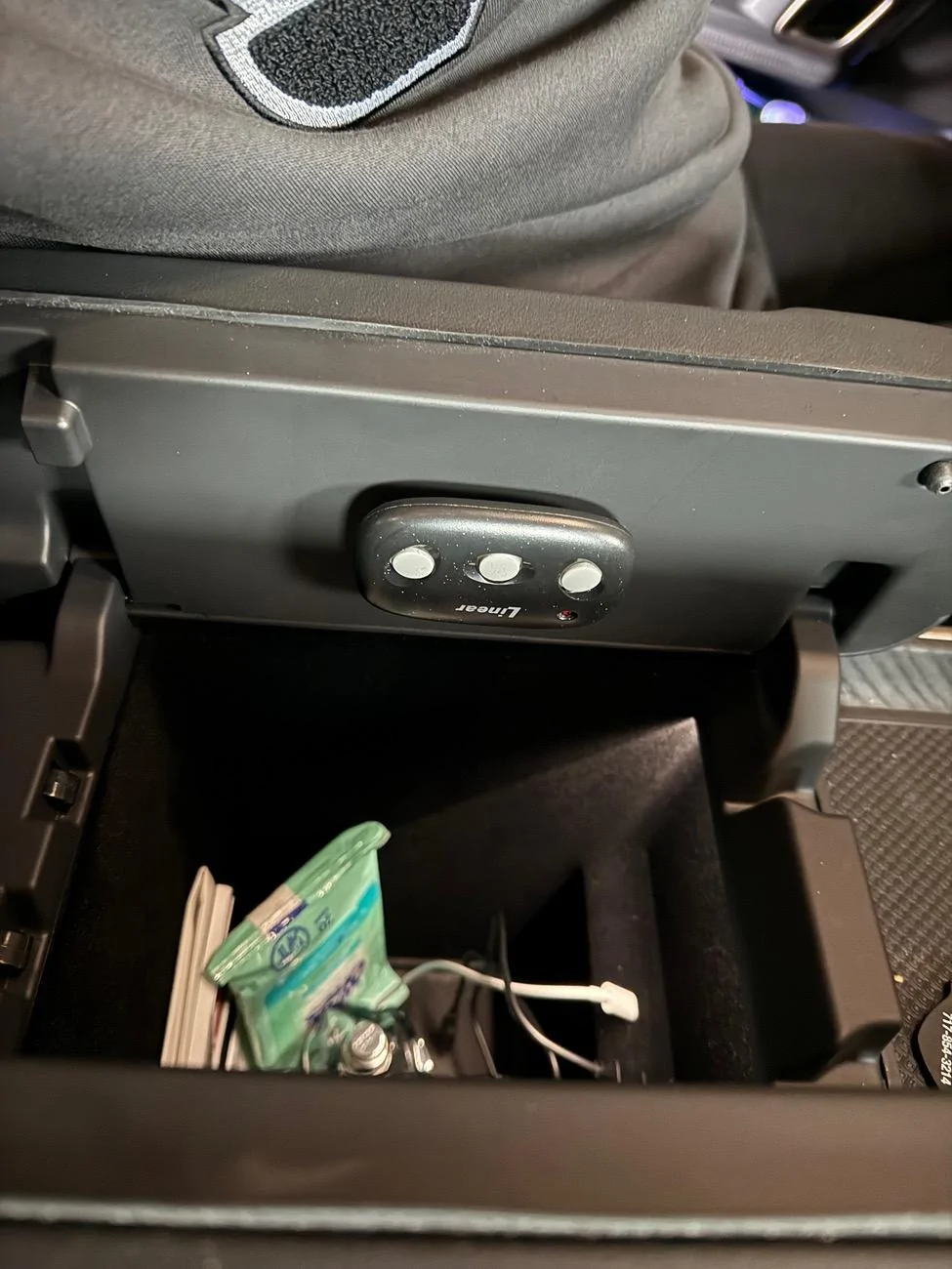

It’s been over six months, and Rivian still hasn’t addressed this issue. I was able to pair other cars with my garage door easily and without any hassle, but that’s not the case with the Rivian.
My only solution is to use the 70s method.
