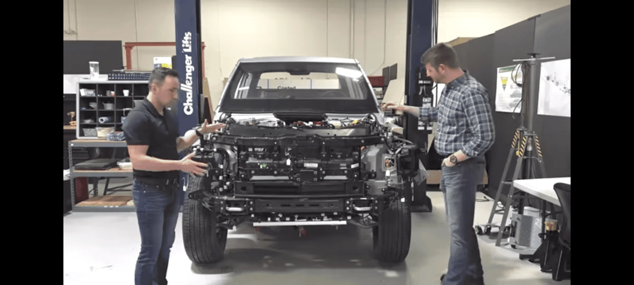

Would have to be DIY. There is definitely enough structure up front but I don't think anyone makes anything.
You might be able to just use one of those bolt-on types around the crash bar for lighter loads.
Rivian R1T R1S Front Hitch for R1T? Screenshot_20221111-171439
