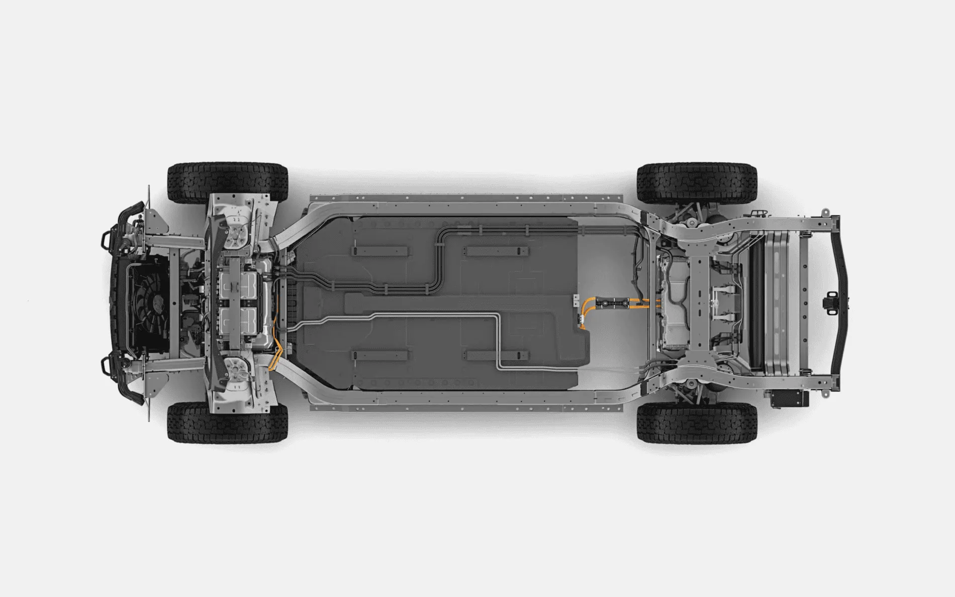

This is from their website on the R1T. I don't know if the larger battery extends backwards a little further or not.
The assumption that I'm making, based on a variety of random comments and no real data, is that picture is the large pack, and the max pack will add in additional battery capacity in that gap between the back of the pack and the rear wheels.
If I look at this view, that means that even with the max pack, most of the bed, which starts just in front of the rear wheels, will not have battery underneath it.
Rivian Fridge slide? {filename}
There are still motor assemblies, frame rails, and suspension components to worry about, but I'm expecting them to be avoidable.
The truck bed starts just at the front of the rear wheels, the gear tunnel goes right up againt that point. There are always spacers between the body and the frame as well, so it is not likely any drilling in the bed would be near the battery.
If this is the 135 battery, I’d think the 180 would fill in more of the space toward the rear. Otherwise, I would imagine a lesser amount of ground clearance with the Max Pack. So far, I believe the G.C. was the same for all three battery configurations.
