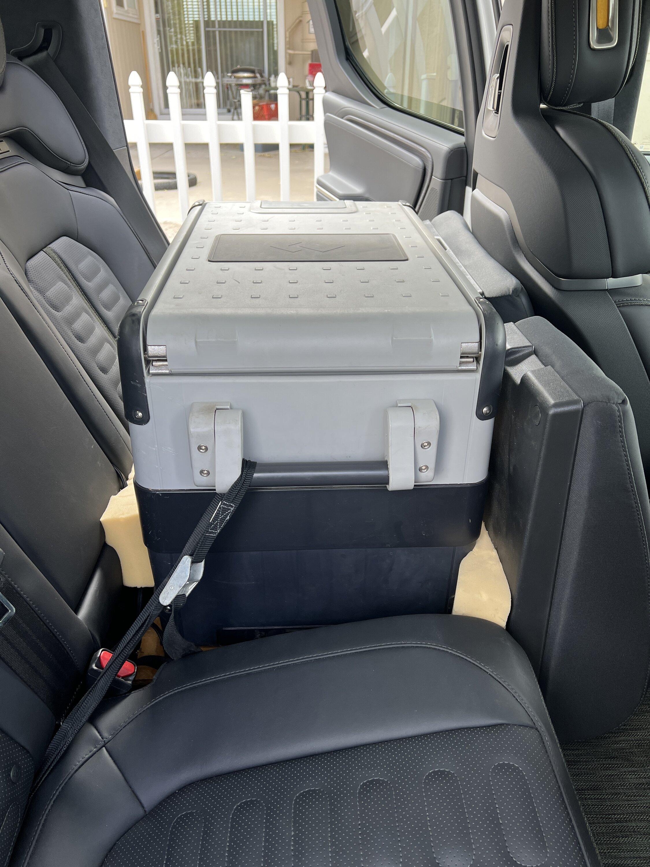

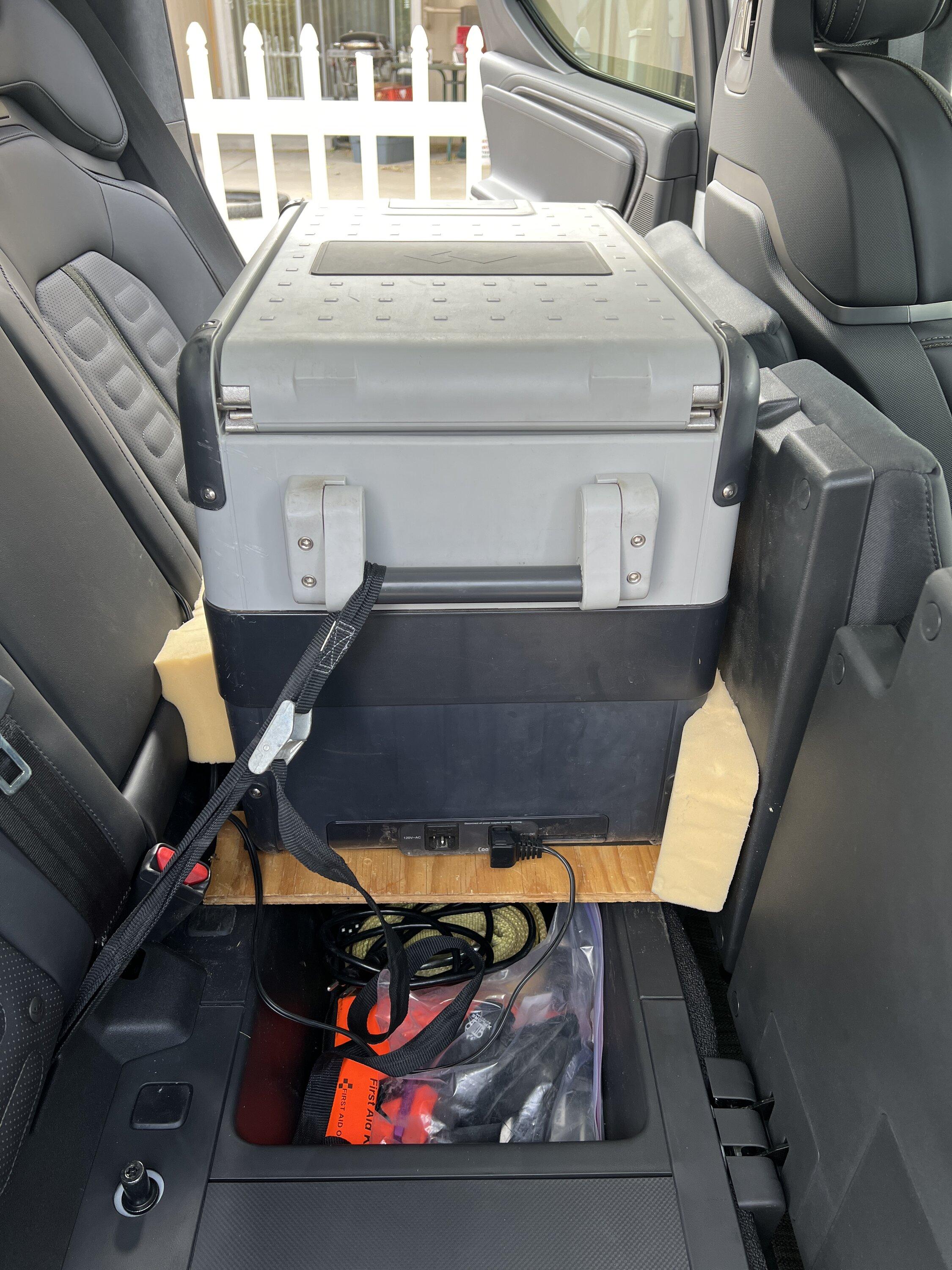

Electric fridges need to breath and will create some heat in an already warm frunk. Not sure that is the best place for maximum efficiency. if one has room, the back seat area is a good option. It’s very easy to setup. I did it in short order, with a piece of plywood, as a proof of concept. Then, ran the connection to the 12v port In the gear tunnel. Others have gotten more involved with their platforms, but it doesn’t take much more than a piece of plywood and a saber saw. Here’s a look at my first, and probably final effort ? Note, there is still limited access to the storage area via the passenger side. The foam pieces are just to pad the seat buckle receptacles and the front seat back. BTW, this is a Dometic CFX40.

Nicely done. I like the cheap, easy, and reversible mods. I have a CFX35 which fits nicely under the tonneau cover (that's why I bought that model) but if I already had a cooler I would try to find a space to make it fit like you did.

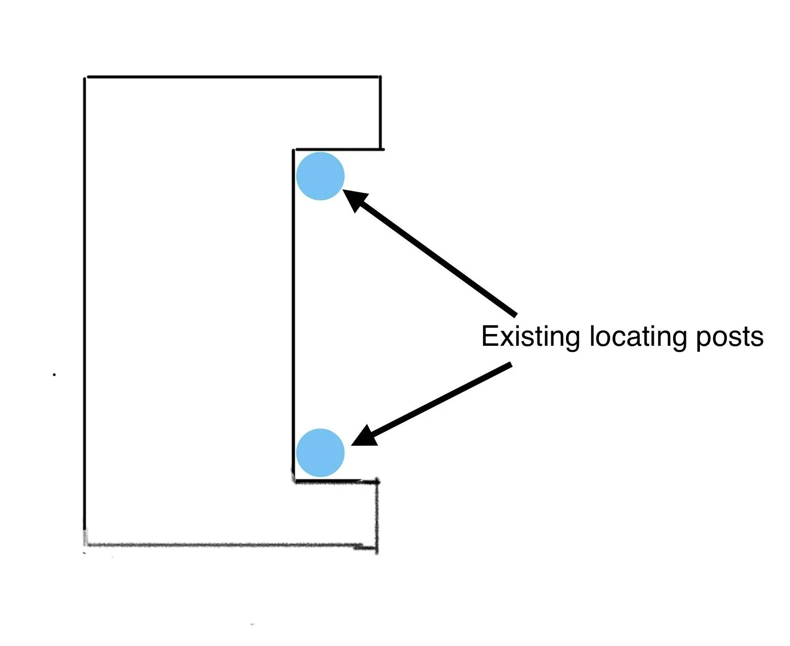

Here’s how I cut the plywood platform. By cutting around the existing seat locating posts, it keeps the platform from moving side to side or backwards. I also glued a couple of rubber padding strips underneath the plywood, where it sits on the plastic seat box, just for protection. The cooler can be secured using straps and the existing child seat mounting points.

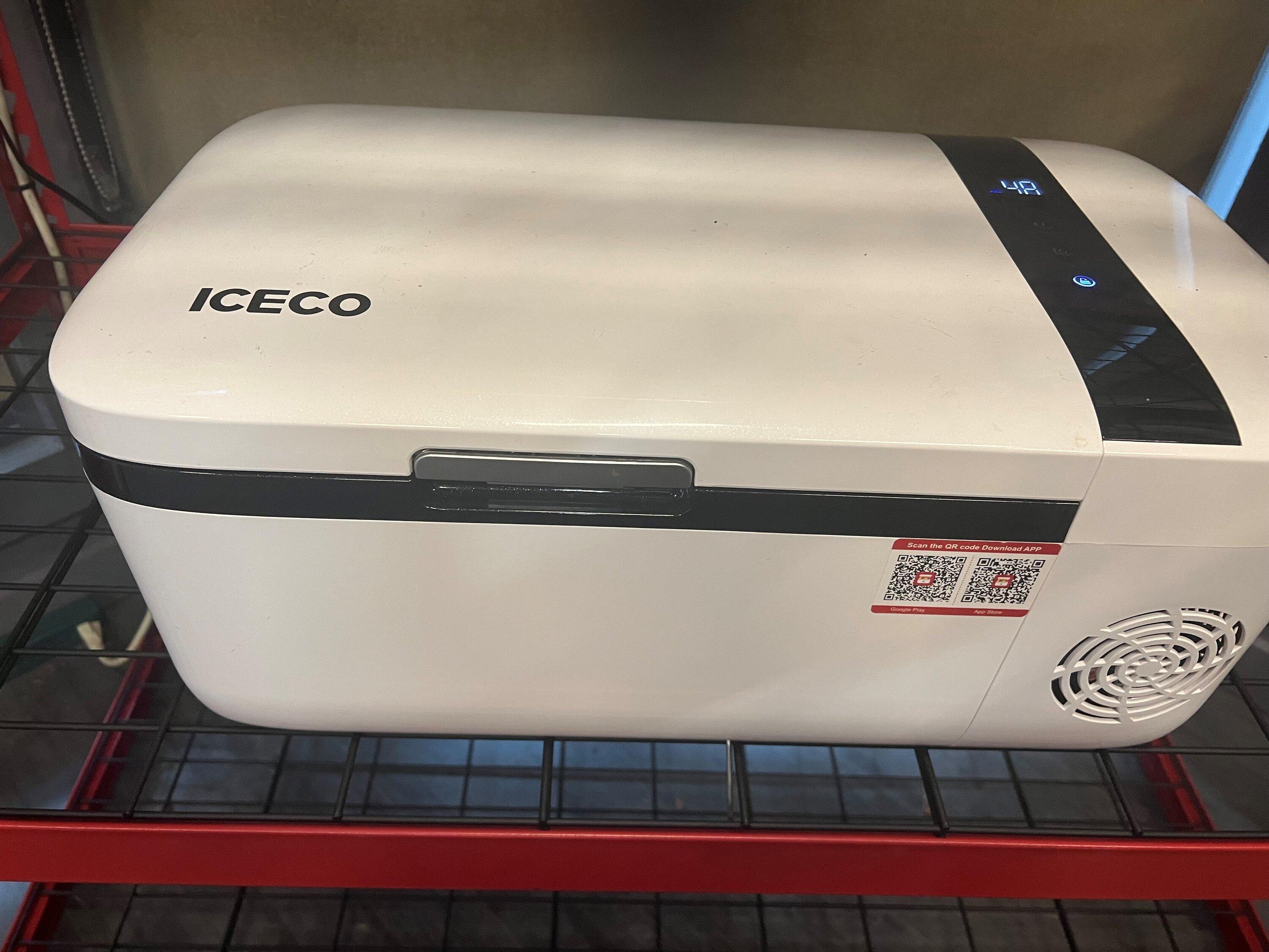

My little Iceco fits in the frunk (where it does get hot), the back seat on a substrate, or in the gear tunnel. Opening the lid from either of the back seats is an awkward reach angle, but it works.

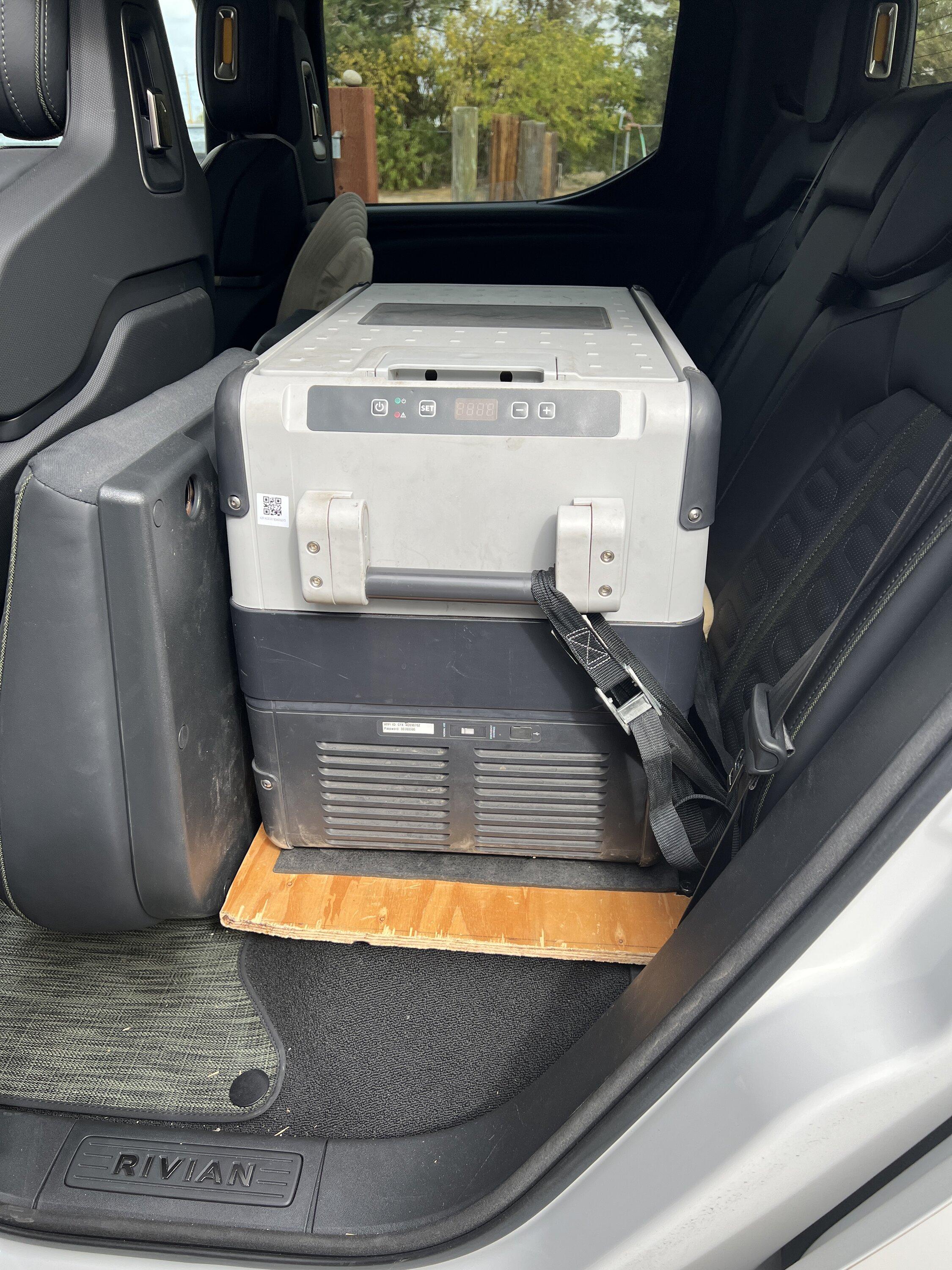

I have the CFX35 and put it in the same position, only I don't use a piece of plywood, and one longer ratchet strap thread through both handles does the trick.
The fridge is much more efficient in the cab, with the added benefit of me being able to access it while driving.
