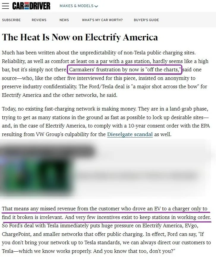

Love people with opinions that refuse to identify themselves…. 😉
Valid reasons. But these are not Joe Blow on internet forums like all of us. They are people in the industry and car manufacturers (ala wide sampling of data). The author has a very long history and depth of knowledge and contacts. He has decades of experience and contacts. I've followed him for many many years.
Bold -->
"one source—who, like the other five interviewed for this piece, insisted on anonymity to preserve industry confidentiality. "
