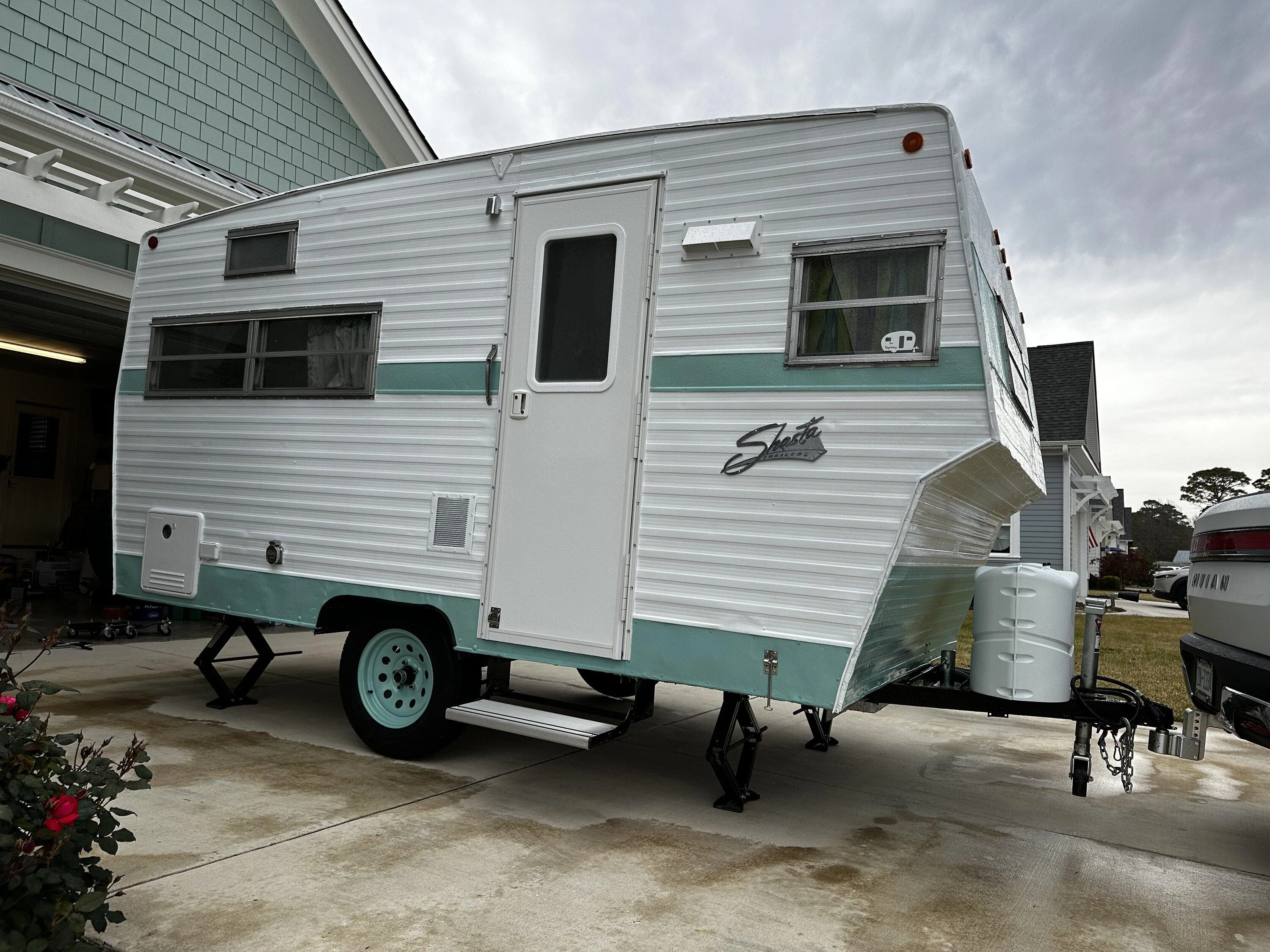

What I really should have done is detached the trailer, weighed the truck again to get just front and back and then re-attached trailer and the sway bars and weighed yet a third time. Then I would get a better idea of what the actual tongue weight is. I believe it's around 300lbs for this trailer. Another thing I forgot to note is that the weight was taken without me in the truck or on the scale. I had to get out of the truck to press the intercom to get the weight and I was off the scale when he took it.
I thought I read somewhere that the trailer brakes do apply when regen activates but I couldn't tell. On the mainly flat ground I drove over the regen was plenty to stop and hold vehicle and trailer in place.

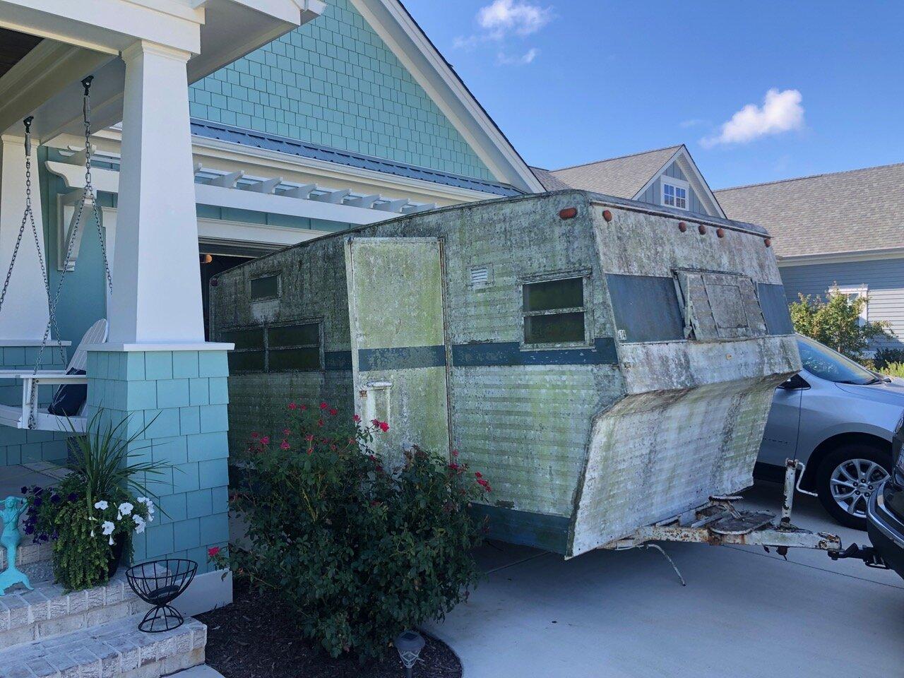

I bought a Weigh Safe hitch to help me assess my tongue weight. My wife and I did a total rebuild of a 1969 Shasta.
Rivian R1T R1S First Towing Test in my R1T IMG_5333
Here's the day we brought it home...Covid project my wife said...
Rivian R1T R1S First Towing Test in my R1T IMG_5147

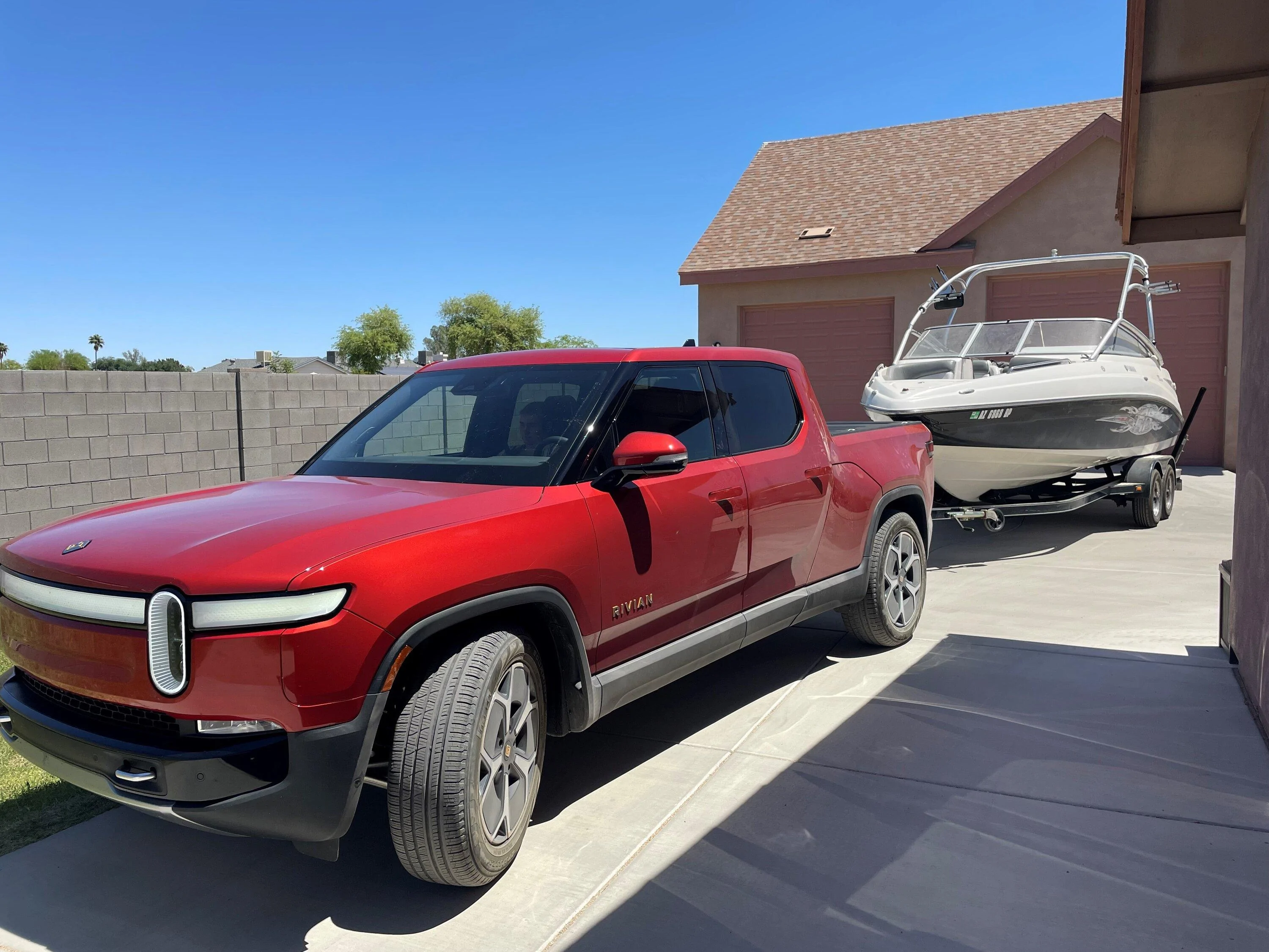

I took my boat out for a 70mph range test today, just got my used R1T on Tuesday.
Rivian R1T R1S First Towing Test in my R1T TowingTest
Round trip to the lake we normally go to is 70miles, but there is another lake 75 miles away (150 round trip)we also like to go to occasionally. This is a Yamaha AR230 and weighs 5000lbs on the trailer. Anyway I used 92% of the battery to go 107 miles, had a 7-9mph wind but did loops to cancel that out. Going to the further lake is not going to work well with this truck.
The truck did go into tow mode when I plugged the trailer in, then it set the range estimate to 158 miles. Seems they are guessing 50% initially. But it started ramping up and got to 210 miles at one point, which was obviously wrong since the truck was getting barely over 0.9mile/kwh. Even at the end of the trip it had 3x the estimate that the truck actually had left. If you are going to tow, use the battery % to do your own estimate, it was clear to me early on that 1 mile per % was a conservative estimate of the range with my trailer attached. The efficiency was .94mile/kwh at the end of the test and I had the truck and trailer tires set to spec.
I bet if you back down to 65mph you will have much better results

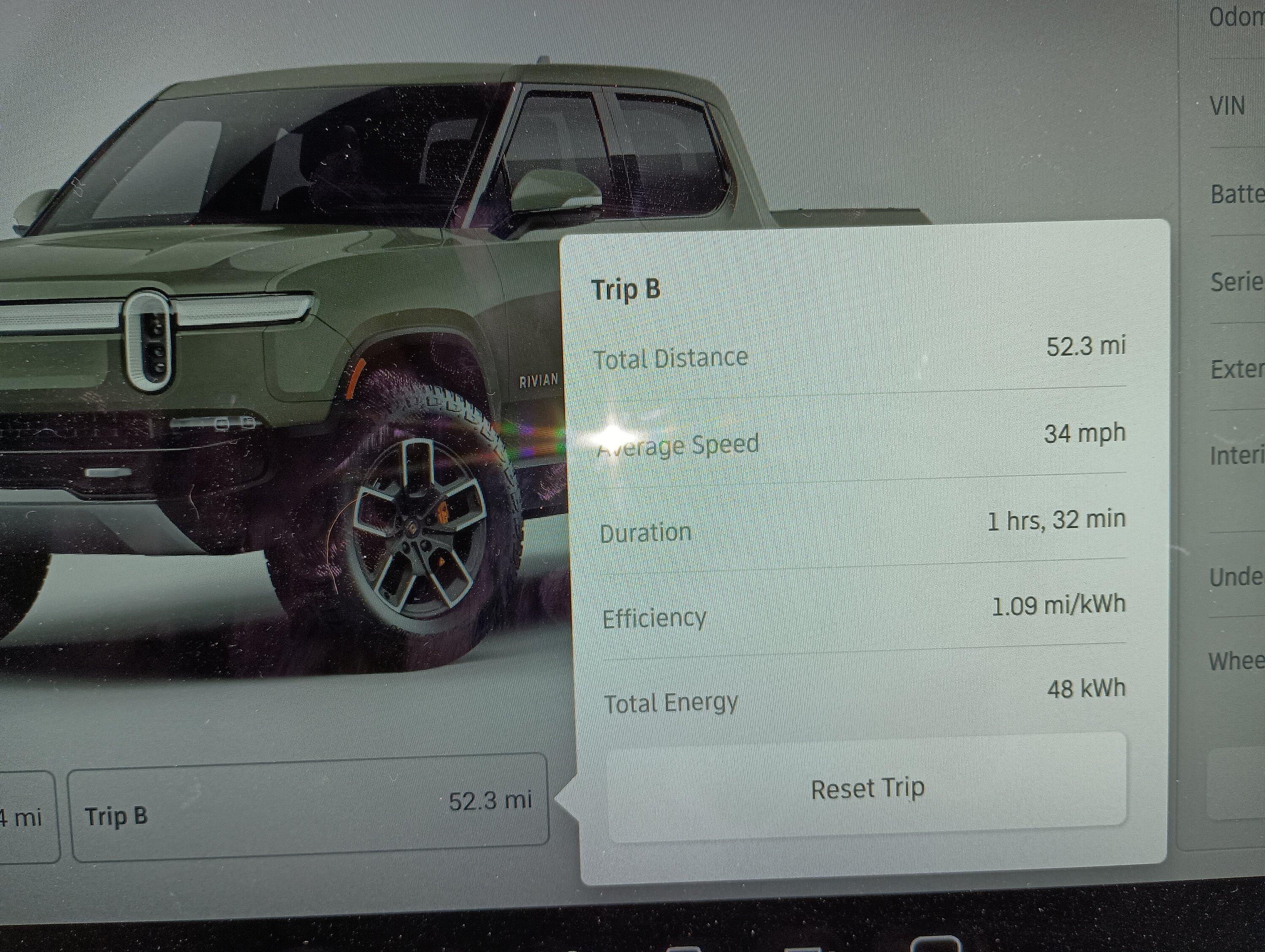

Did a short 52 mile loop to weigh truck and camper and get a feel for how it drives. Was extremely windy and raining. Compared to the Nissan Pathfinder I used to use to pull the camper, this drives so much better. No impact on acceleration and no straining going uphill. I did a few miles on the highway going 65 and again no effort getting up to speed. I did the first half of the loop without my sway bars installed and then installed them for ride home. They weren't installed when I took the weight and thus the imbalance front to back on the truck. I did notice quite a difference without the sway bars especially since it was so windy today so will continue to always use them. I had hoped to not use them anymore since weight distribution is not needed if trailer is under 5K and truck has built in sway control. Not using them would make for easier unhitching when charging if necessary but the drive difference with and without was significant enough to continue to use them.
Some things that occurred and towing remarks:
1) truck is supposed to go into towing mode automatically once it senses a plugged in trailer. This appeared to happen briefly as the camper lights came on then went off. I'm having a bit of trouble getting the power cord from camper to insert all the way into the R1T. When I got into the truck cab, the options on the towing mode screen were all grayed out and my monitor for the rear camera on the camper wasn't detecting the camera. As soon as I pressed the brake pedal power was supplied to camper and camera turned on. Not sure if this is normal.
2) While driving, a warning would pop up that trailer brake is now available and another warning after that the rear sensors were disabled. This popped up occasionally for a total of 10 or 12 times over the trip. However, none of the towing associated screens ever turned off or disabled before or while these warnings popped up and there never was a loss in the rear view camera. These pop up warnings were quite annoying. Not sure if I just need to clean the trailer cord contacts. Would be nice to know what sensor or power line is used to detect the trailer presence so I know where to dig deeper.
3) Can't set the trailer brake properly because you can't disable regenerative breaking. Normally you should drive around 20mph and coast and then apply the trailer brakes to stop both vehicles but can't do this since you can't coast due to regenerative breaking. I just set it to 5 and never noticed any pushing of the camper on the truck while breaking so it wasn't too low. However I don't want it to be too high because then I will be losing regen as too much breaking is coming from the trailer. Really need a mode to be able to set the trailer braked properly.
4) Before I hooked up the trailer the truck was at 85% battery with range of 248 miles. As soon as it went into tow mode it dropped the estimate to 120 miles which is expected. After about 5 miles of driving and the initial efficiency being around .9 miles/kwh the range estimate started slowly climbing. After a few miles it went all the way back up to 220 miles. It never went back down to matching the efficiency of the current data. Hoping this is just a one time glitch as this can really throw of when you need to charge.
5) Overall efficiency was 1.09 mi/kWh. Only about 10% of driving was highway but it was extremely windy and raining. I'll probably stick with my estimates of 1.0 mi/kWh but will see after we take camper for first real trip in a few weeks at over 200 mile distance. Camper is very lightweight and is why we could tow it with a Nissan Pathfinder (5K towing capacity) but it is very boxy and not aerodynamic at all. Efficiency really is impacted more by aerodynamics than weight. I'll take the 1.0 mi/kWh vs the 10 miles per gallon we were getting towing this with the pathfinder.

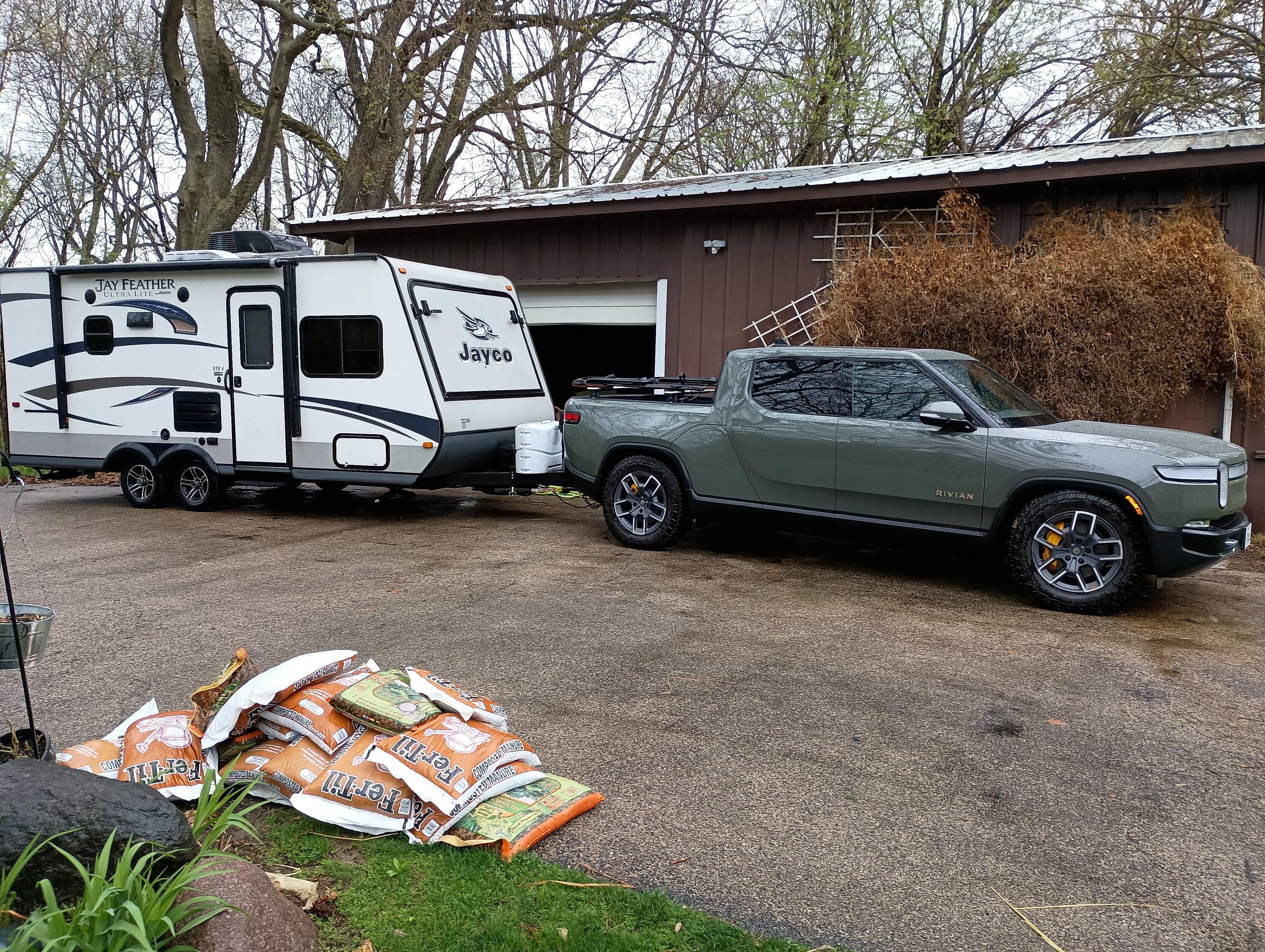

How did your 200 mile trip go? I have a 2013 Jayco Jay Feather M-23B (very similar to your camper) that I used to pull with my Tacoma but have swapped over to an R1S and have a trip planned in a couple weeks. The Taco averaged 9-11 mpg depending on terrain, I'm hoping to get ~1mi/kWh at 60-65mph.
What size pack do you have (standard, large, max)?
