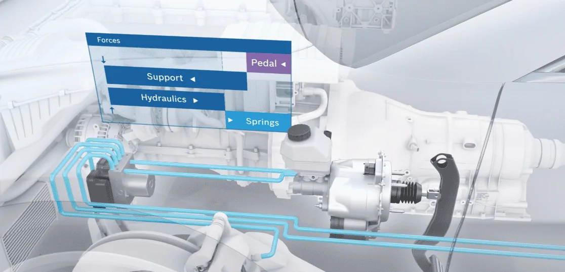

I think you are a little confused about how this works. Blended systems, as the name suggests, blend in friction braking during regen when the driver wants to slow down. It is in an independent system (like Tesla's) that the car adds in friction brakes on top of 100% regen. This is what happens if you take your foot off the skinny pedal (100% regen) and plant it on the wide one. Regen remains on.
I've lurked this thread for a bit. First off, I will say that I have only test driven a Model S, 5 or 6 years ago, so I can't speak from hands on experience on any of this. But I can speak from research I have done in the past 6 months into regenerative braking and how it works in the *Rivian*.
From my research, both RIvian *and* Telsa Model 3 use the Bosch iBooster and the Bosch ESP hev, which is a regen/hydraulic integrated design. As such, it's incorrect to say "It is in an independent system (like Tesla's) that the car adds in friction brakes on top of 100% regen" .
With the Bosch braking system, regen and friction braking are completely integrated. It's all in the software implementation as to how it works, which is certainly determined by the vehicle manufacturer, since the regen and friction available are 100% dependent on the manufacturer's drivetrain and calipers as well as vehicle weight. Therefore, comparing RIvian and Tesla "seat feel" experiences are minimally useful.
Look at the interview below that confirms Rivian is using Bosch, and the Bosch product pages and videos that explain how it REALLY works. Enjoy!
Interview with Rivian VP of Propulsion
"Like almost all other electric and hybrid cars, Rivian also initially uses regenerative braking as the traditional brake pedal is pushed but transition to friction braking as the need for anti-speed increases as the driver pushes down farther on the brake pedal.
Like many other car makers, Rivian is using Bosch’s iBooster brake system. Even Tesla has used this system since they introduced partially-automated driving features into the Model S although Tesla has programmed it to use only friction braking when the driver steps on the pedal, presumably to guarantee the highest level of consistent braking feel."
Product page with Explanation Video
I suspect that some here will say "I don't need to watch the video, I know how it works." All I am going to say is that from reading the debate here, some don't really understand how it works. Watch the video, especially the second half as it details when the Bosch system uses regen vs. friction.
ESP hev web page
"The regenerative braking system ESP® hev for vehicles with front axle/rear axle brake circuit distribution enable a purely generative deceleration of up to 0.2 g when combined with a conventional vacuum brake booster. If the ESP® hev is combined with an iBooster, purely generative decelerations of up to 0.3 g are possible.
ESP® hev for vehicles with front axle/rear axle brake circuit distribution is based on the ESP® plus generation 9 and the use of proven standard components. The low-pressure accumulator chamber and the valve-filter principle were modified for the use of the ESP® hev system for regenerative braking. Furthermore, an improved engine control for accurate speed regulation is applied."
iBooster web page
The iBooster page has a video as well, explaining in detail how the Regenerative/Hydraulic integration works. Again, statements in this thread are contradictory to how the Bosch system works. Watch the video.
"The iBooster enables virtually full recuperation with deceleration values of up to 0.3 g when combined with ESP® hev. This is due to the iBooster’s ability to adjust the supporting force at any time in line with the hydraulic conditions by means of software controls. This covers all common braking maneuvers when driving on roads."
ESP hev web page
iBooster web page
ESP hev web page
iBooster web page
And yet that is exactly what a Tesla does so it can't be incorrect. This is easily discernible by watching the power meter when applying the brake pedal. Perhaps if you had done that your "research" would have led you to a more realistic conclusion.
ajdelange
A. J.
Aug 1, 2019
2,883
2,317
Virginia/Quebec
EE Retired
That's interesting. I can't remember where, but I do remember Rivian (or someone with Rivian) saying they had transitioned to removing the option to "coast" when lifting off the accelerator because it lowered the EPA range estimate,
I'm assuming that what they have implemented is functionally the same as what Tesla has (and all the reports seem to be pointing in that direction). With single pedal driving you still have the option of coasting. You "simply" feather the thrust pedal to the 0 thrust point and hold it there. I put "simple" in quotes because that isn't so easy to do, at least not for a basically clumsy oaf like me. But then as you have pointed out there is really no reason to want to coast. We, rather, feather the pedal to slow us down comfortably (where that's possible).
Note the the 0 thrust point is indicated by a reading of 0 on the power meter. I'm beginning to get a little concerned that the Rivians may not have a power meter. ?
Zoidz
Gil
Feb 28, 2021
108
3,188
7,021
Interesting. Watching a software display of regen tells you that regen and friction control are "independent systems"? Meanwhile, the manufacturer - Bosch - has videos and documents showing that it is an integrated system. Okaaayyyyyyy.......
Yep - it's incorrect to say "It is in an independent system (like Tesla's) that the car adds in friction brakes on top of 100% regen"
You obviously didn't watch the video or read the information. It's not an "independent system" as you claim. Watching the power meter shows you nothing more than the status of regen, where does it tell you that regen and friction are "independent systems"? The quote I referenced expliciltiy states that Telsa implemented the programming differently from most others:
"Like many other car makers, Rivian is using Bosch’s iBooster brake system. Even Tesla has used this system since they introduced partially-automated driving features into the Model S although Tesla has programmed it to use only friction braking when the driver steps on the pedal, presumably to guarantee the highest level of consistent braking feel."
Whatever dude. I'll believe the manufacturer's documented specs before I believe a forum post that guesses how something works based soley on interpretation of a software display.
ajdelange
A. J.
Aug 1, 2019
2,883
2,317
Virginia/Quebec
EE Retired
Yes. If the power returned to the battery is unchanged when the friction brake is applied clearly the friction brake has no influence over the regen.
Your problem is that you are assuming that Bosch makes Tesla's braking system. It doesn't. The system described in the video and on the website bears no resemblance to the braking system in my car.
The friction brake in my Tesla adds braking on top of the regen. Period. This is not debatable. It is as plain as the fact that the car has 4 wheels. It is the way things are whether it fits your theory or not. Go drive s Tesla. If you come away from that experience thinking that friction braking is not applied on top of regen then you are not comprehending what your eyes are telling you.
Er, well, yes. It shows the status of the traction system overall but that includes the regen mode.
... where does it tell you that regen and friction are "independent systems"?
When it shows that the status of the regen is not influenced by the position of or pressure on the brake pedal it tells you they are not coupled. Your bio says you are engineer. You should be able to understand that.
That's right. They don't couple the brake pedal position into the regen system.
Teslas and Rivians are big heavy vehicles. As are all vehicles they are required to have an independent mechanical braking system. Vehicles this heavy need some kind of boost and there is no vacuum source to provide it in a BEV. Some other way of getting boost is needed and in these vehicles it is a device such as the iBooster. So the Tesla and Rivian each have some sort of iBooster and the Bosch unit might serve that function perfectly well. Note that the unit in the Tesla does not look anything like the ones shown ib Bosch's video but it could still be a Bosch unit. Or someone elses.
I think you confusion may stem from the statements in the iBoost video that it sends signals to the motor. That doesn't mean the traction motor. It means the motor that pressurizes the master cyclinder. Or it may stem from the fact that the unit clearly develops signals concerning brake position and its first derivative which signal could be used to control a blended regen system (as the first video you reference makes plain). Your error is in assuming that Tesla (and Rivian) do that. The evidence is that they don't.
I saw some references to magazine articles and some links to Bosch's web site. I didn't see any to manufacturer's specs. Could you re-post the links to the Tesla and Rivian Docs? Thank's.
In the meantime I choose to believe what my eyes show, especially when that confirms what common sense dictates, rather than some links some guy posts to promotional material on the internet. You can believe whatever you want to. My only concern there is that you are misinforming people - not, i suppose, that it matters much in the grand scheme of things/
