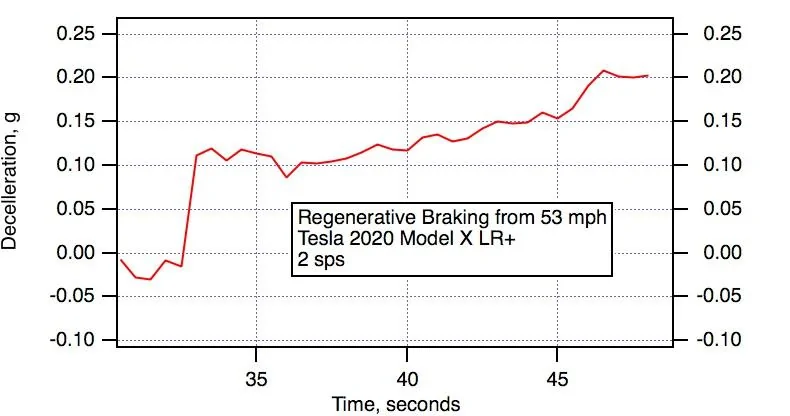

With systems like Tesla and apparently Rivian, lifting off the throttle can provide very low levels of whoa..
Evidently you have never driven a Tesla (or Rivian). Here's a plot of the deceleration from about 53 mph to a few mph using regen only.
Rivian R1T R1S First Time EV Buyers: Battery Size and Charging Apprehensions MX RegenBrake
I will allow that if you consider 0.1 - 0.2g "very low levels of whoa" that I can appreciate your POV but I don't think most people would consider those levels "very low" as they are about the levels that one would ask of a friction brake in coming to a traffic light or slowing down for a turn in any vehicle. Note that the vehicle is essentially stopped in 15 seconds. Also note that in Telsa's algorithm for scoring driver safety (to see if he is qualified to test FSD) points are deducted for any deceleration of > 0.2g.
... under some circumstances. If the battery is full and/or cold, usually very little regen is available. You've no doubt experienced this if you have ever charged your Tesla to 100% in preparation for a long trip.
If the battery is under stressful conditions the BMS does protect it by limiting regen. But the prudent driver does not operate his battery under stressful conditions. He does not charge it to 100% in preparation for long trips as today with the expansion of the SC network there is no need to. As for cold (which means < 50 °F), regen is limited to just under 50 kW (it may be limited further at colder temps but I have not personally experienced this) which easily handles most situations (like the one graphed) without limitation and the battery warms sufficiently after a few minutes of driving (would depend on how cold soaked it is) restoring full regen capacity. In practice I can do a 600 mile trip without ever touching the wide pedal (unless some idiot cuts me off on the freeway).
The reason I am going on about this at such length is that it's clear you don't understand these systems very well and it appears that your message to the readers is that regen braking, especially as implemented by Tesla and Rivian, is in the "bell and whistle" catagory i.e. pretty useless most or, at least, a large part of the time. Nothing could be further from the truth. I want the readers to understand that this is one of the best features of BEV vehicles and one that I think many will enjoy the most. I am sure you will be among those who do once you actually experience it, assuming, of course, that Rivian has done as good a job of implementing it as Tesla has done.
