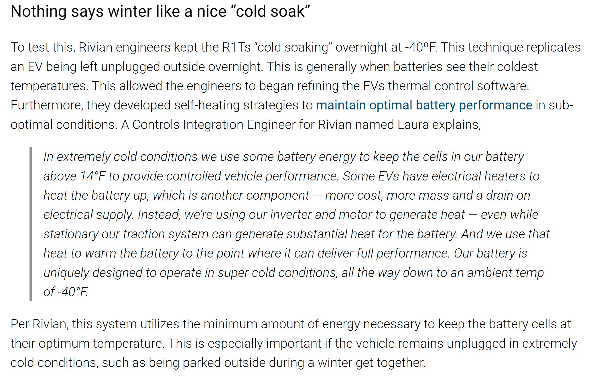

Preconditioning will take much more power than L1 (120V) can provide. Not uncommon to see a 32A draw with a full battery (or one already "fully charged" to the level set by the user).
Not only is it pleasant to get into a prewarmed vehicle, it also allows the battery to be brought to a more optimal operating temperature (as noted above in a couple of posts).
Rivian stated in their cold weather testing video that they use a very active strategy to keep the batteries warm. Being plugged in while it does so will retain your desired charge level.
Rivian R1T R1S First Time EV Buyers: Battery Size and Charging Apprehensions 1638894215254
https://electrek.co/2021/02/27/rivian-tests-r1t-electric-pickup-in-sub-zero-temperatures/
