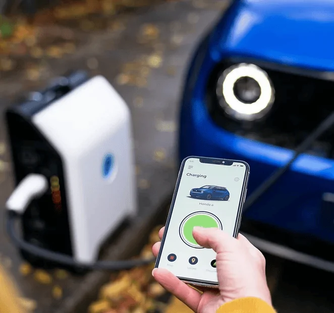

Right now this device won't even make up for the loss of vampire draw.

20-40 miles of charge on a small EV is going to be 10-20 on a Rivian. Less if conditions are not ideal. Not really a ā€œsolutionā€ in my mind.

The extra weight of lugging around something like that defeats the purpose as well.
An "extra can of gas" in an EV means slowing down by 10mph or 15mph, or rolling in smaller tires.
There is no magic bullet for additional emergency range, yet.

Not a ton of information. The charging world is changing so quickly. I wonder what the solution will be in 5 yearsā€¦ not a traveling suitcase I hope.

This is a great product. Not for what it does, but for the concept of what it does, and "baby steps" in the evolution of charging. Upgrade this in 5 years (?) to solid state batteries, it's pretty significant.
Also, we are looking at it from a Rivian vehicle viewpoint. But for someone who lives in an apartment with no garage, and commutes 25 miles a day, this starts to make sense.

Based on the size they're advertising here, It'd be hard to imagine cramming more than 3.6 kwh into that package. This is roughly the size of the VERY dense ecoflow delta pro. Good concept, but I can't imagine the tech for density is there yet to get 20-40 miles out of one of these. If the most efficient cars get 4 miles/kwh without any charging efficiency loss, this is still at max 12ish miles at current density limits.

Yeah, just not worth it. One big thing with EVs is that you have a constant readout of your battery state. You know you're at a given percent. In a car, gas gauges can be flaky. You can drive on "E" for a while.
And while carrying a compact reasonably light (~6 pounds) container of gas can get you 20-50 miles depending on the vehicles, to go even 10 miles in a Rivian requires 40+ pounds of battery.
The best solution is to watch your charge, and don't get in to a situation where you run out of charge. Which again, is a lot easier in an EV where you see exact mile or percent battery states.
"The next possible charge stop is 55 miles away, and my vehicles says I only have 50 miles of range?" Drop your speed. Turn off your HVAC. You'll get that extra 5 miles.

How is this thing different then any of the Jackery-type products?
ā€˜Tisnā€™t and that tells us itā€™s of no practical use to a Rivian owner.
