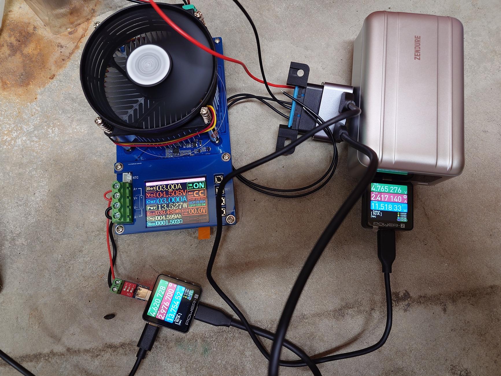

I did a few quick tests to see if I can recreate this. I was able to power two devices at the same time, but the OBD2 adapter has some limitations while doing it.
With both ports connected:
  1. The output voltage of both ports is limited to 5V.
  2. The total output is limited to about 25W (13.7W+11.5W pictured). As I increased the load on the USB-C port, the output on the USB-A port would correspondingly decrease.
  3. When I increased the USB-C port to 3.6A, the OBD2 adapter shut down both ports, but no device should ever ask for more than 3A at 5V, so that's to be expected.
  4. I could connect one of our Qi2 chargers to the USB-C port along with a low-power device on the USB-A port and both worked, but when I connected two of our Qi2 chargers to the A and C ports at the same time, both ports just cycled on and off.
We'll update our product listings to make it clear that it is really intended to use one port at a time, at least with high-powered devices.
