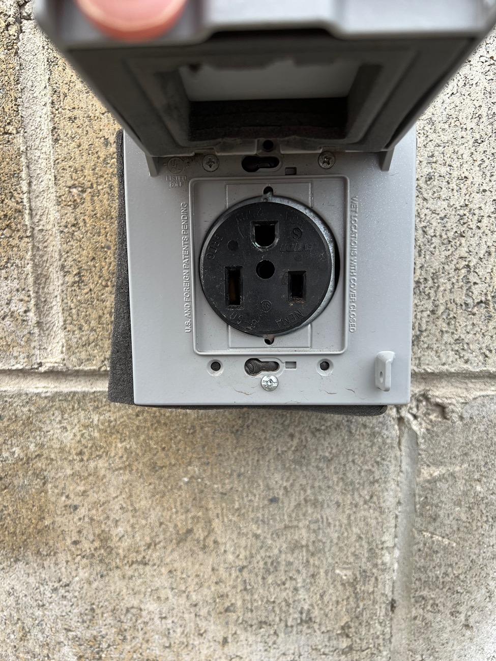

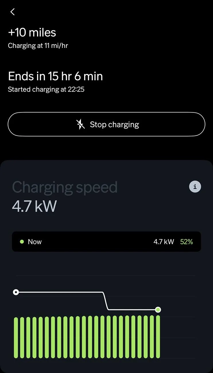

+1 on a ChargePoint 50A hardwired home charger. I already had it for my previous EV, so opted not to purchase the Rivian home charger. With the ChargePoint I can schedule charging times and I have not had any issues using it to charge my R1S Gen2.
There are other posts from individuals who have experienced a drop in charging draw after one hour. It’s rather odd that most cite the drop at 60min. Some state arcing, other that their Rivian displays warm plug.
This weekend I did my first road trip and was in a situation where I needed to use the portable charger that comes with the vehicle. As most know it comes with only two plug types - 5-15 120V 12A (max 1.3kW) or 14-50 240V 32A (max 7.6kW). In reality, the max kW can be derated up 80% based on several factors including cable gauge used to the plug and safety.
In my case, I found out that the only plug available was a NEMA 6-50P (common high-power equipment - welder, EV charger, power tools) and the Rivian portable comes with a NEMA 14-50R (more popular, moderate to high voltage and current - EV charger, RV hookup, dryer, range). Another key difference is the number and configuration of the prongs and grounding pin.
So I’m stuck with incorrect plug type. Solution is to either go find a local L2 charging station in rural Washington, plug into a 120V outlet or knock on my neighbors door and ask them how they charge his Rivian R1T (and Tesla). They offered me their charger that has the appropriate plug . I did a little research before plugging it in and felt good enough to try it out. It started charging at 6.4kW…for the first hour, then dropped to 4.7kW for the next couple of hours. The cable was never warm but the interior car console said it dropped charging level due to warm cable. Unplugging for a bit, checking the pins, and charging again seemed to resolve the issue for a while, but similar issue reoccurred.
I did some research and found it a common occurrence. So trying to see if it’s the charger, outlet, vehicle, or a combination. Most point to a charger issue and it’s unclear if it’s consistent with 3rd party, plug type, phase of the moon??
My next step is going to go back to either a commercial L2 charger or charge at home on my ChargePoint. I also sent a related service ticket to Rivian to see if any of this background helps in their investigations.
